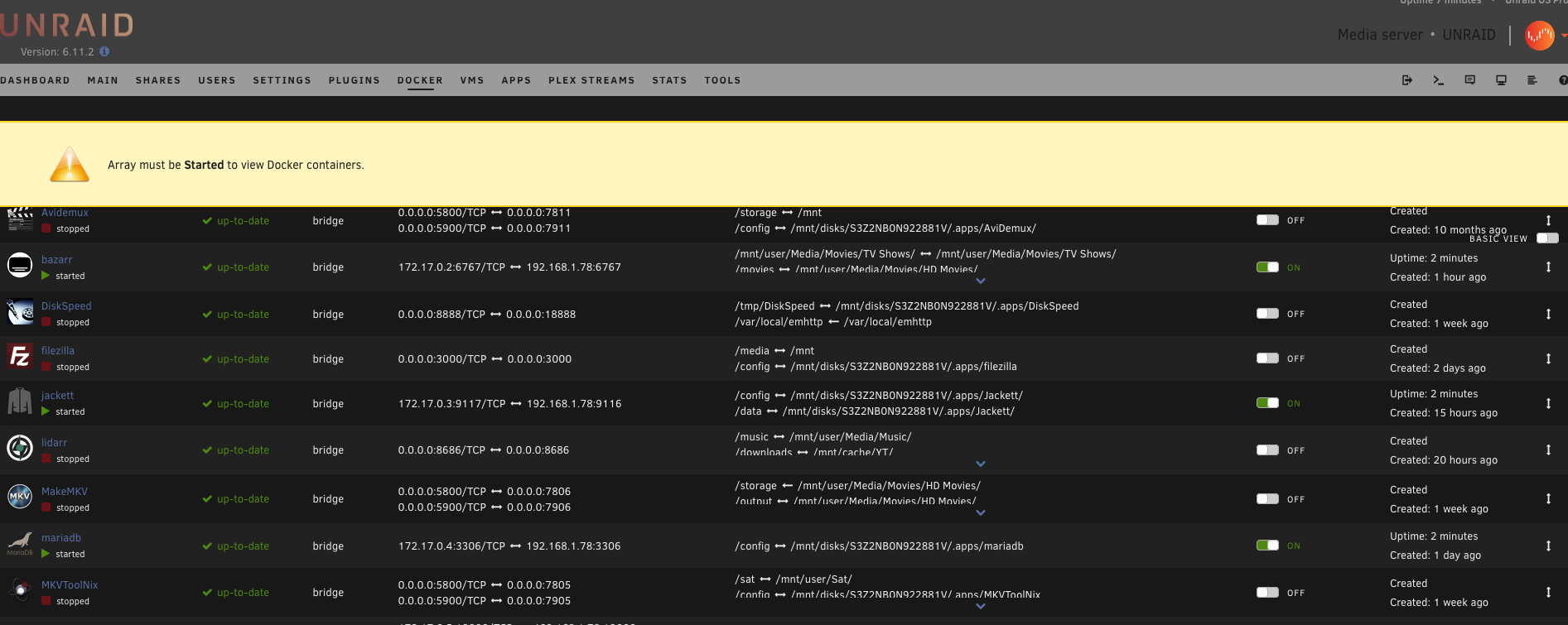

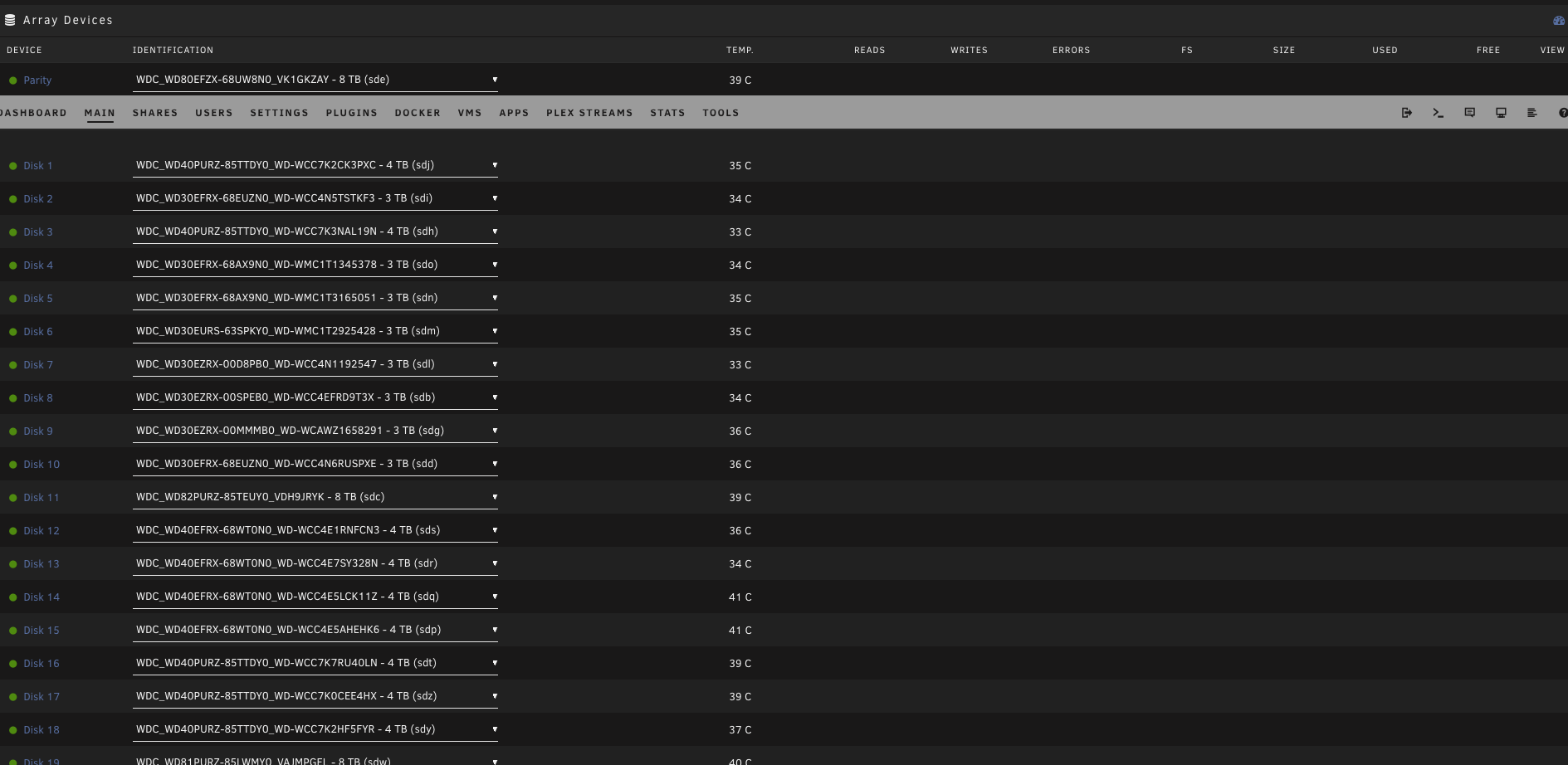

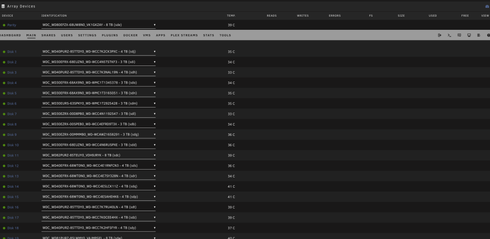

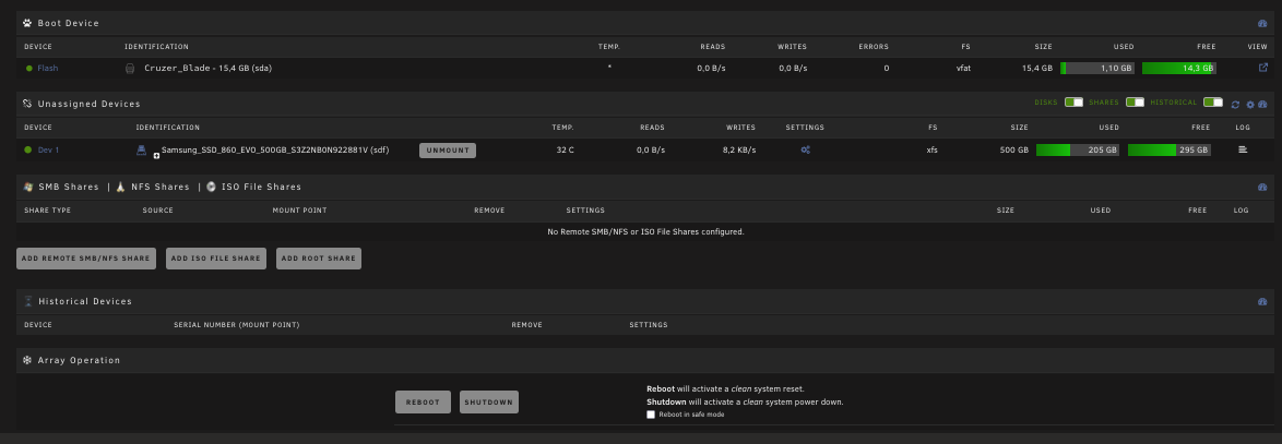

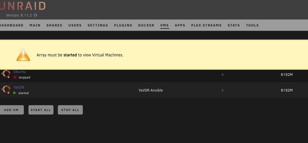

Upgrade from 6.9 to 6.11.2 issues
Upgrade from 6.9 to 6.11.2.
The flash drive has been replaced with brand new to make sure it is not flash related.
Once the array is started, all my plugins, dockers and VMs are started normally and also working as expected.
UNRAID reporting the array as STOPPED which is not the case. The array is started and working.
The same behavior with previous upgrades which I thought were flash drive related. Obviously it is not the case.
The buttons for start/stop array and all the others are not visible as Unraid is started in maintenance mode.
Please find some screenshots and kindly advise how to proceed further.
Diagnostics file attached.
Thanks in advance.

Are you using Firefox? If yes reboot first the use a different browser.
Thank you. Tried from different computer with different browser and also via Ipad to same result.
After rebooting?
This was the issue.
Stale configuration.
What I needed to do was to reboot the server and quit firefox. Once the unraid booted I logged in with Safari.
Problem solved.
Thank you.
Edited by Alexandro
Yep, that's why I mentioned
Is there any way to prevent this behavior in future using Firefox?
Yesterday I rebooted the server using Firefox and while starting again array with Firefox experienced the same.
Restarted and started the array using Safari and problem solved again.
Is there anything I can do in Firefox?
Thanks in advance.
For now I would recommend not using Firefox with the GUI, might be resolved with a newer Firefox release.
