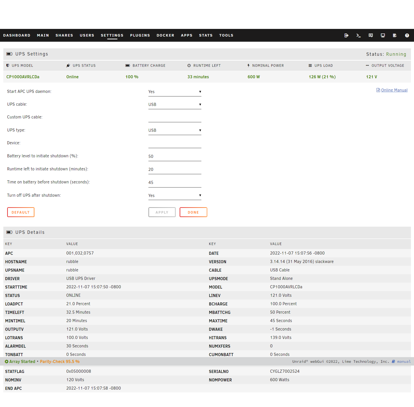

I suspect this has something to do with a power brown out, or something. I DO have a new UPS plugged in, and also via USB to shut the server down after XX minutes (or maybe battery %?) if power is out, but it seems to be an imperfect setup.

Got a PiVPN ordered today and will hook that puppy up along with some more conservative UPS settings via unRaid.
