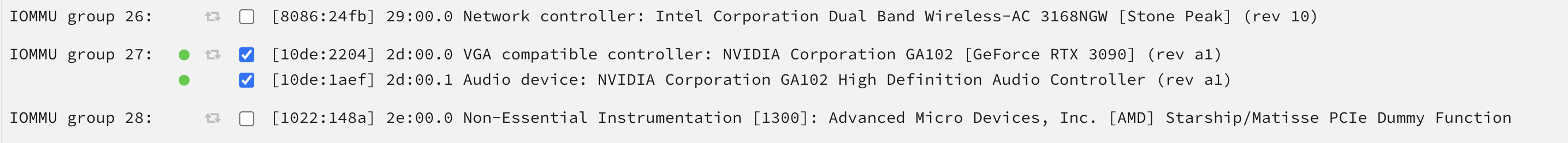

Second, I think I'm not setting the multifunction thing and IOMMU group correctly.  Here is what my IOMMU config looks like for my 3090(I have the 2 devices selected and clicked the "Bind selected to VFIO at boot" and restarted):

13 hours ago, 00100100 said:
How to I edit my unraid config to disable it from using the GPU on boot up if that is an issue?
It's normal that you have some video output when unraid boots, vfio attaches after.
Am I editing my xml incorrectly above?
Yes, multifunction is applied correctly
Did I hurt something by letting the the VM boot directly from the PC outside of KVM?
You didn't
Attach diagnostics and the vbios file you are using. Note that if you dump the vbios using gpuz you still needs to remove the header.
