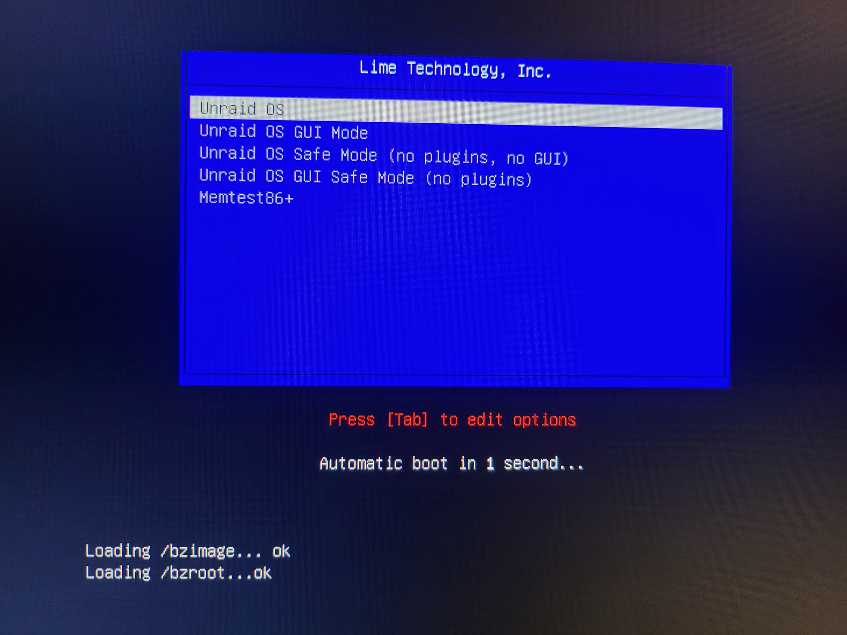

November 7, 20223 yr Community Expert Hey folks. I tried to upgrade to 6.11.2 this morning and at reboot, my system keeps hanging at this screen: I've tried 4 different ports. Do you think my USB stick is hosed? Thanks! Edited November 7, 20223 yr by Keek Uras
November 7, 20223 yr Author Community Expert I wanted to mention that I did put the USB drive into a Windows machine and I was not prompted to scan and fix. I could also browse the contents of the drive. Edited November 7, 20223 yr by Keek Uras
November 7, 20223 yr Community Expert Try with a different flash drive with a stock v6.11.2 install, no key needed, just to see if it boots.
November 7, 20223 yr Author Community Expert 45 minutes ago, JorgeB said: Try with a different flash drive with a stock v6.11.2 install, no key needed, just to see if it boots. If that works, what's the best way to restore my previous config and get back online?
November 7, 20223 yr Community Expert Redoing the flash drive should solve it in that case, backup, recreate, restore the config folder.
November 7, 20223 yr Author Community Expert Solution Turns out it was due to no keyboard being connected. It wasn't showing any messages on the screen but I plugged in the transceiver for a keyboard and it booted right in to unRAID. Thanks for the responses.
