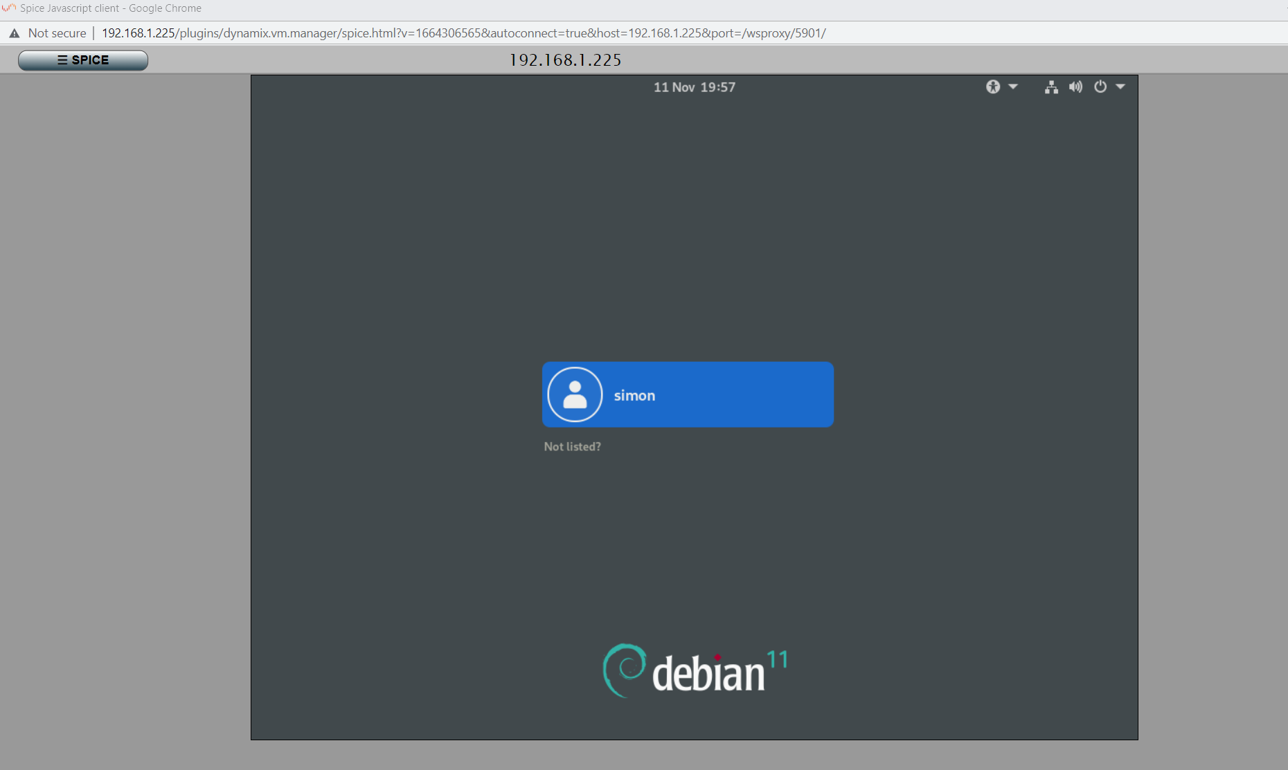

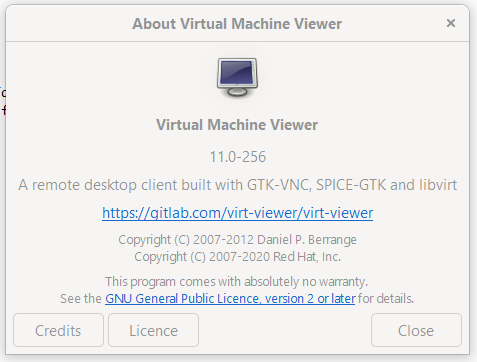

While I was trying to figure this out I noticed that there is the option for both VNC and SPICE in the VM? What is the difference? Is one better then the other?
The SPICE(Prototype) Client is not as good as the VNC client, but it works ok. But enable spice allows external spice clients also like virt-viewer.

Cool, thanks for the info, yeah I will just stick with VNC, it works for what I need.
Only real complaint is that copy/paste does not work with the built in clipboard.

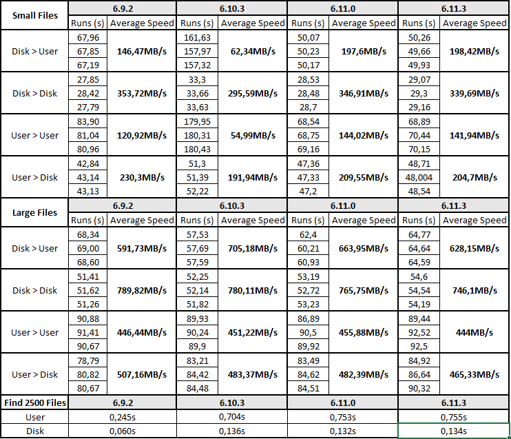

no hard evidence to support it but updated from 6.11.2 to 6.11.3 yesterday and all went well. Doing some large file transfers today and the SMB transfer speed seems to be on a go slow,
anyone else noticed anything?
Edited by markiii
SMB connections really depend on the OS on both ends. You’ll probably need to give more details.
For me SMB with v6.11.3 is performing about the same as v6.11.0, there is a small though measurable slowdown, especially with large files, my guess is that they are caused by the Samba update from v4.7.0 to v4.7.2 which includes some CVEs:
samba: version 4.17.2 (CVE-2021-20251 CVE-2022-3437 CVE-2022-3592)
But note that this update was done on v6.11.2, so v6.11.3 should be very similar to v6.11.2
P.S. tests are done from one Unraid server to another, both with the same release, I tried before doing Windows to Unraid tests but they were not repeatable after some time, i.e., a test done 6 months later could produce very different results, likely because of the Windows updates installed in the meantime.
P.P.S. only did tests with mitigations=off for now, though AFAIK no new mitigations in the kernel since v6.11.0.
