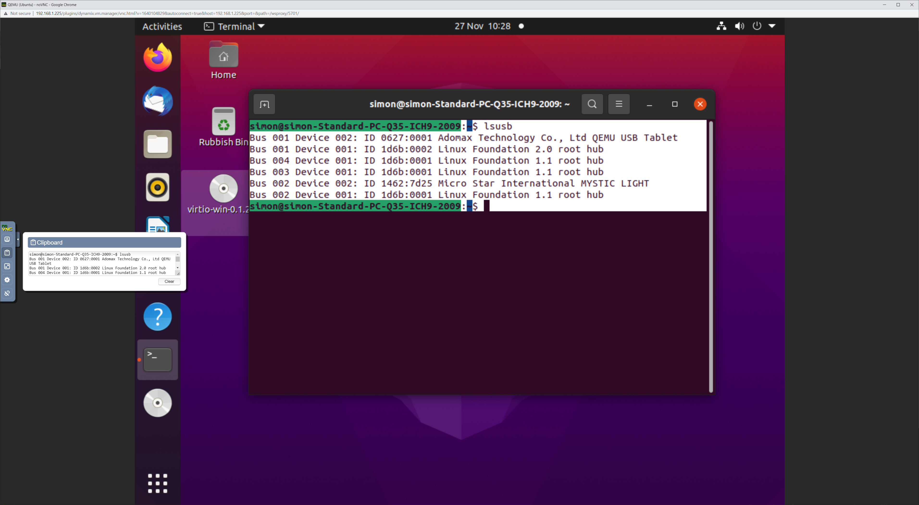

Only real complaint is that copy/paste does not work with the built in clipboard.
I have been looking at copy paste and it does work on 6.11.5, but may work on other 6.11.x versions.
You need to install spice vdagent from here and add lines to the XML.
https://www.spice-space.org/download.html
Example XML:
   <channel type='qemu-vdagent'>
      <target type='virtio' name='com.redhat.spice.0'/>
      <address type='virtio-serial' controller='1' bus='0' port='3'/>
      <source>
        <clipboard copypaste='no'/>
        <mouse mode='server'/>
      </source>
    </channel>
This is running on Win10 not tested on Linux as yet.
Example XML:
      <source>
      </source>
    </channel>
Very nice, so even on 11.5 you need to add that code or is it only for earlier versions? I am on 11.2 right now.
Also using ubuntu primarily on the VM's that I need the clipboard for. Any idea if the command would be the same for them?
The VM's are working on a job right now, I will try shutting them down and adding those commands when they finish.
Edited by TexasUnraid
Yes it needs to be added as not part of the XML even on .5
For Ubuntu look like you can install via apt.
sudo apt install spice-vdagent

3 hours ago, SimonF said:
Yes it is for VNC
Tried it on both the windows and Ubuntu VM and sadly it is not working on either of them?
I added the XML code near the bottom of the XML where there were other channel entrys. I installed the spice guest tools for windows and seems that ubuntu already had it installed for some reason.
Could something of changed between 6.11.3 and 6.11.5?
Should work from 6.11.1 on wards
Sorry I posted the wrong XML, have updated above, should be
      <source>
        <clipboard copypaste='yes'/>
        <mouse mode='client'/>
      </source>
    </channel>
Test ubuntu also.
Edited by SimonF
That did it! I saw the copypaste = no and wondered why that was there but figured there must be a reason lol.

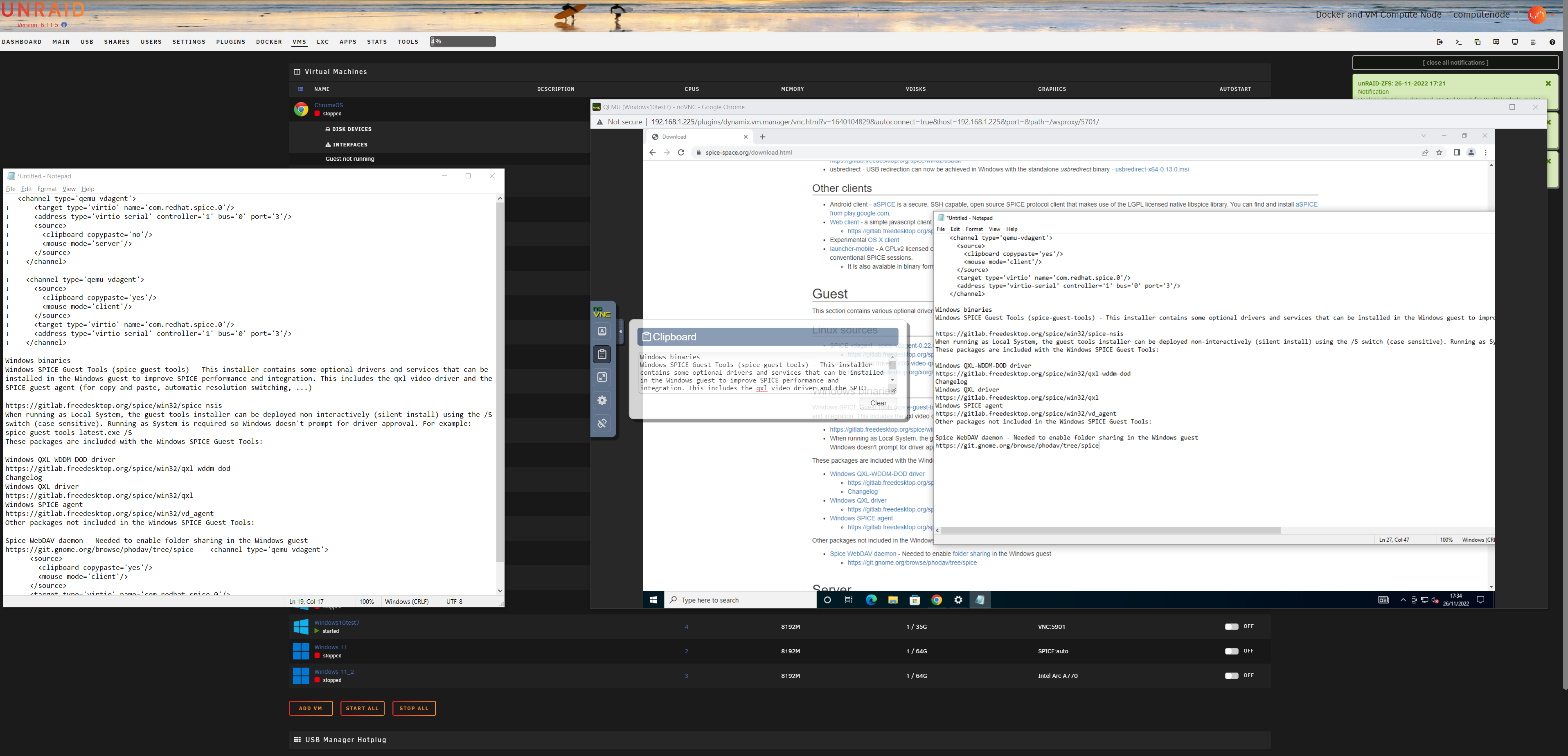

Sorry if I am being thick headed here, but you are saying vdagent needs to be installed on Unraid, right? I have the tools package installed on the client already and added XML and it doesn't seem to work.
If it DOES need to be installed on Unraid, how do you do that without apt install?
no vdaagent is installed on the VM like the qemu guest agent.
XML should be this
      <source>
      </source>
    </channel>
Edited by SimonF
XML should be this
      <source>
      </source>
    </channel>
Sorry I'm not getting this. How do you install vdaagent  in Windows? I'm not seeing an installer for that.
33 minutes ago, dja said:
Ok, well no dice then. I had that installed before. NO copy paste with XML added. The only thing it did was make the mouse impossible to use as it is not aligned with where it should be since adding it.  I removed the XML and the cursor works (?)
Which client are you using?
Spice with Virt Machine viewer 11.0-256
Edited by dja
