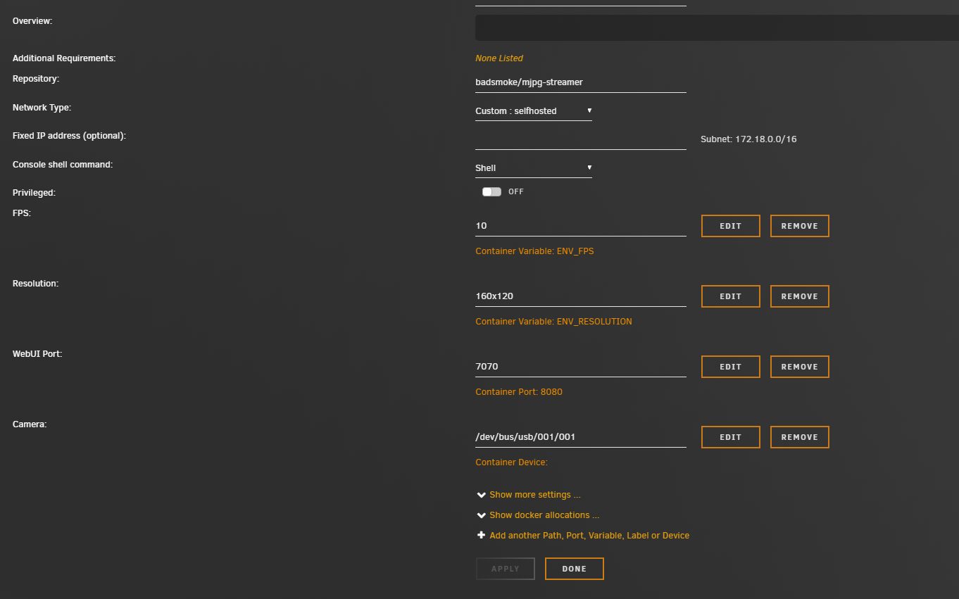

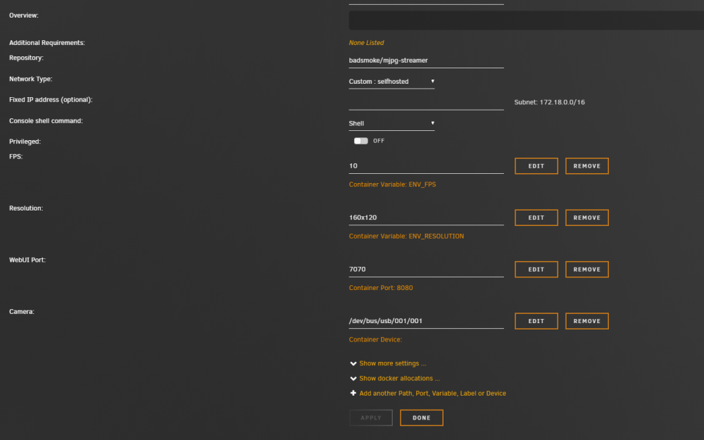

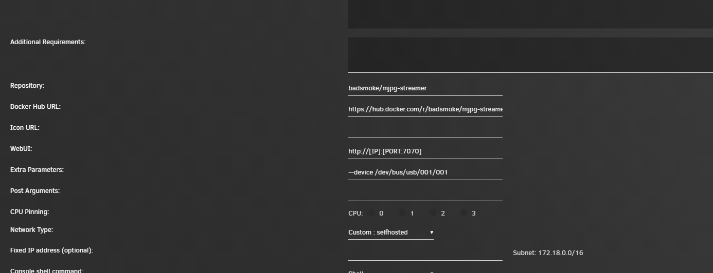

Below is my config for the docker:
And the docker does not start. Can someone please assist me with this.

Thank you for the response. I have the USB passed through as in the docker settings screenshots. Not sure if I have to pass it through somewhere else as well. I just installed the DVB Plugin and selected LibreELEC Package and I am still getting the same error message, init_Videoin failed... Can i be that the camera is not supported? It is quite a common Logitech C920 i believe.
