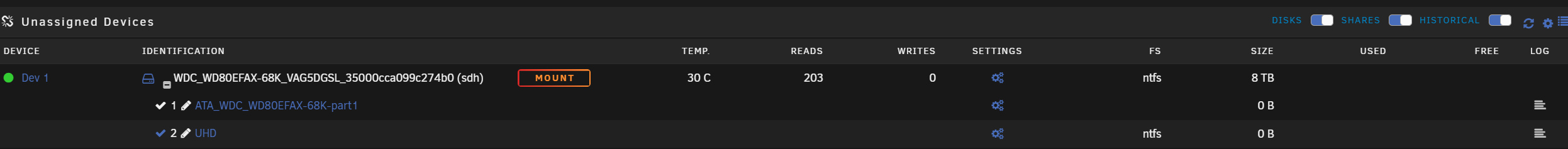

I just pluged in a WD red from my old windows server.

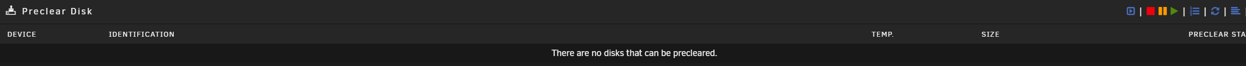

But i cant preclear it?
I tryed mount and unmout but i cant see it in the preclear tool?
What can i do?

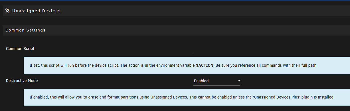

Enable the destructive mode in UD and clear the disk or remove the partitions.  It will then show up in preclear.

UD is the Unassigned Devices plugin.
As mentioned, you need to enable destructive mode by first installing the unassigned devices plus plugin (in addition to unassigned devices).

Super!
I got that plugin.
So
Enable "DM"
Remove partitions
Preclear drive
Stop array
Assign new drive to array
Is that the way to go?
