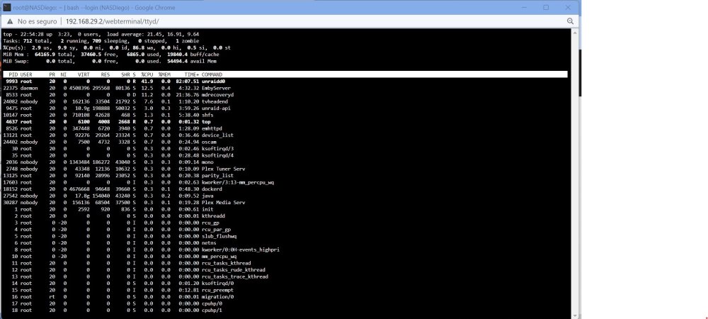

Since some days I suffer from high load average.
Some minutes or hours after booting the load starts to increase until the system is overload and it is unreachable (nor shh, gui...) and forced me to do an unsafe shootdown

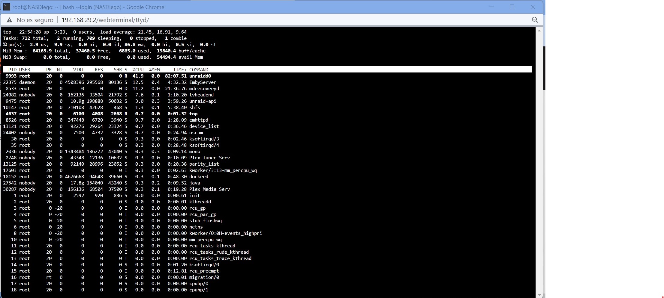

Today I can take a photo when it starts to increase (another day I can see kworker rocketed too).
Any idea how to deal?
Thank you
