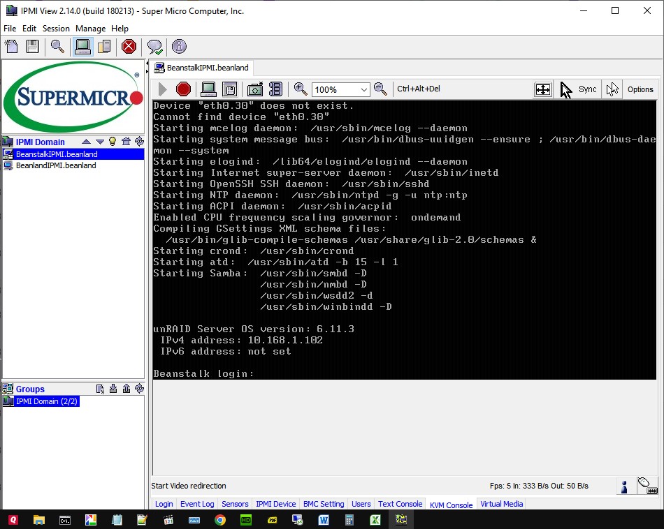

Thank you!  That got me the local console login prompt via IPMI back.
Not quite sure why I need to blacklist something that I do not have installed.
With the latest releases the drive is installed automatically.
I get the login prompt, but I am unable to interact with the KVM console.  No response from my keyboard.  Don't know it this is related to unRAID or the IPMIView software.

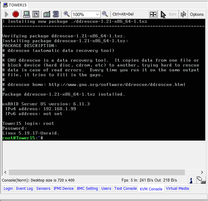

What program are you using? I also have an older X7 series Supermicro, also had to blacklist the ATI driver but IPMIView 2.15 works fine.
IPMIView 2.17 and 2.20.

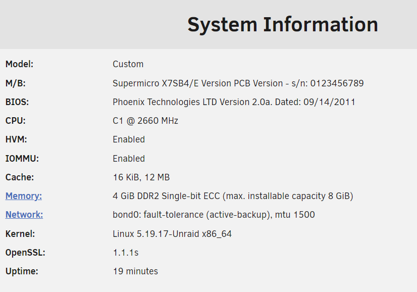

What X7 motherboard are you using?
My X7SBE has an add-on daughter card (AOC-SIM1U+) to provide IPMI functionality.  I have a feeling the IPMI firmware (V1.64) is just too old to work with IPMIView.  I also have a Supermicro A1SRi-2758F with built-in IMPMI functionality on the motherboard and IPMIView works fine.  So I may be SOL with my unRAID server.

It's the same:
X7SBE with AOC-SIM1U+ and firmware v1.64:
Don't know why the IPMI device shows an X8
