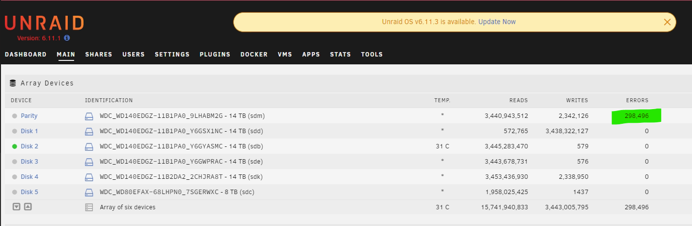

[6.11.1] Parity drive has 298,496 errors?
Should I be worried about this?   Do I need to do anything?
I ran a SMART short self-test:  Completed without error

There were read errors on parity during disk1 rebuild, disk looks OK but you can run an extended SMART test to confirm.
Thank you!  Run an ext test on the parity drive or disk1 or both?
Didn't check if disk1 was the same or replaced, if it's the same run on both.

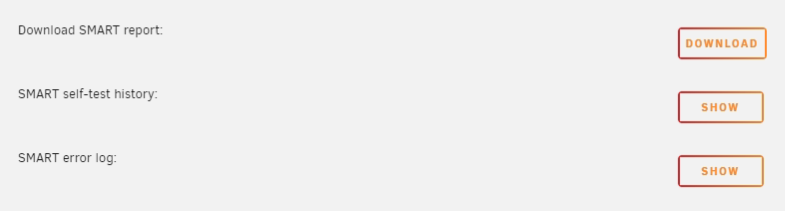

Extended smart tests completed!  Which of these options do I choose to post the results here, or does it make no difference?image.png.0b403a00a93fbe69c00314a80317f86c.png
Edited by taflix
'Download'

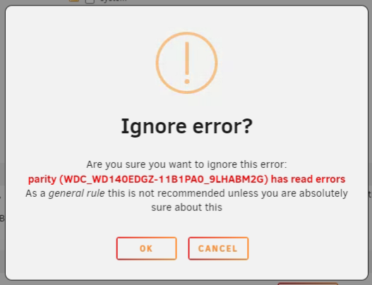

Both tests completed successfully and the drives seem OK.
Reboot to clear the errors and then run a non correcting parity check.
