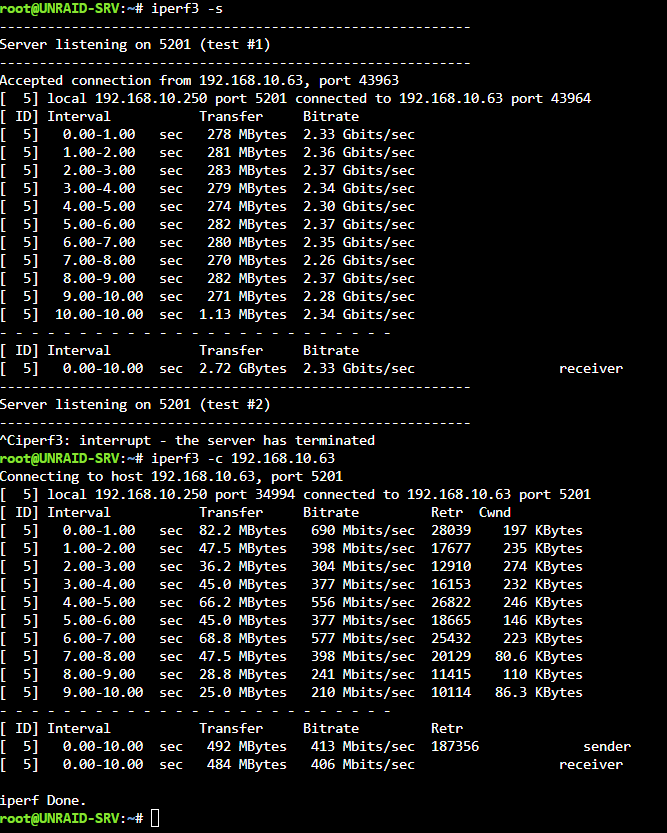

SMB is now working but I'm still stuck at 50MB/s reading from the Array.
Start by running a single stream iperf test in both directions.
That confirms it's a LAN problem, usually NIC, NIC driver or setting, switch, , cables, client PC, etc.
Yes, after checking all scenarios I found the issue. It's my onboard 2.5GBE NIC not working with my RJ45 SFP+.
