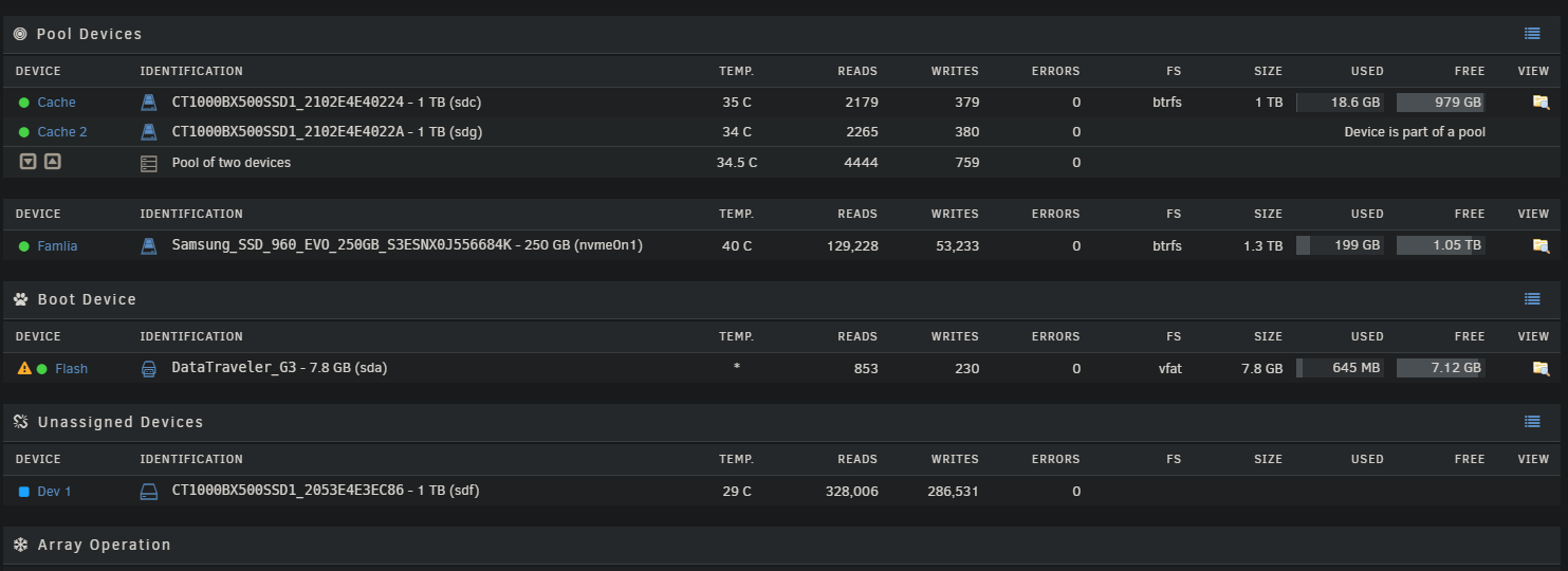

I had the 'famlia' pool originally set up with just the one nvme drive, that drive just had a single 240gb vdisk image on it that was being passed to my windows VM for my C drive.

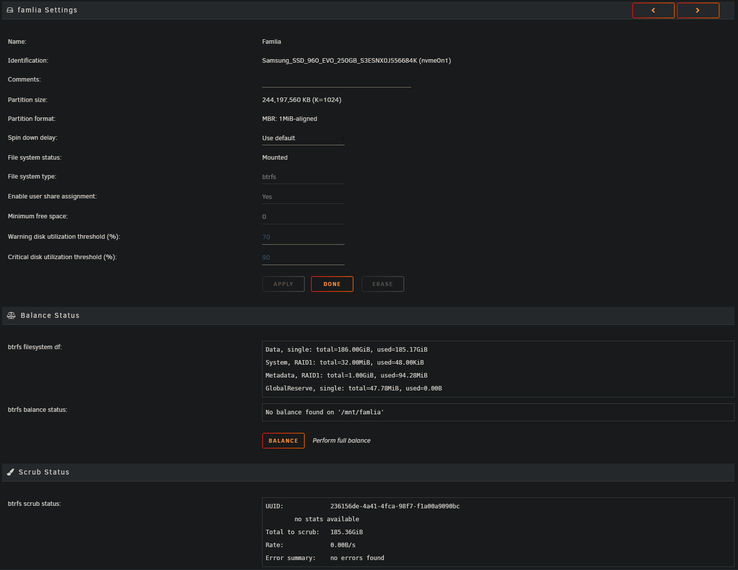

I wanted to pass in an additional 1tb sdd (the unassigned drive in the picture) to my vm so I originally added that drive to the pool without stopping to think this would change it to a raid1 pool with the same total space. I then followed a few different guides and tried to try remove the second drive, things like deleted the pool and create a new ones, rebalance ect. Somehow I now have the pool with one drive showing as 1.3tb, which it never did when I originally had the two drives in one pool, but did happen when creating a new pool with both trying to fix things.

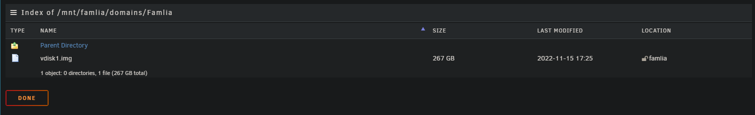

I'm now also noticing that vdisk image is showing as 267gb, so my plan to just back it up, delete everything and copy back onto the drive has seemingly become a little difficult...

NVMe device was not correctly removed from the pool.
Stop array
unassign Samsung SSD from the familia pool
start array
stop array
assign both the Samsung SSD and the Crucial SSD to the familia pool
start array
convert pool to raid1, when done
stop array
unassign the Crucial SSD
start array to remove the Crucial device from the pool
