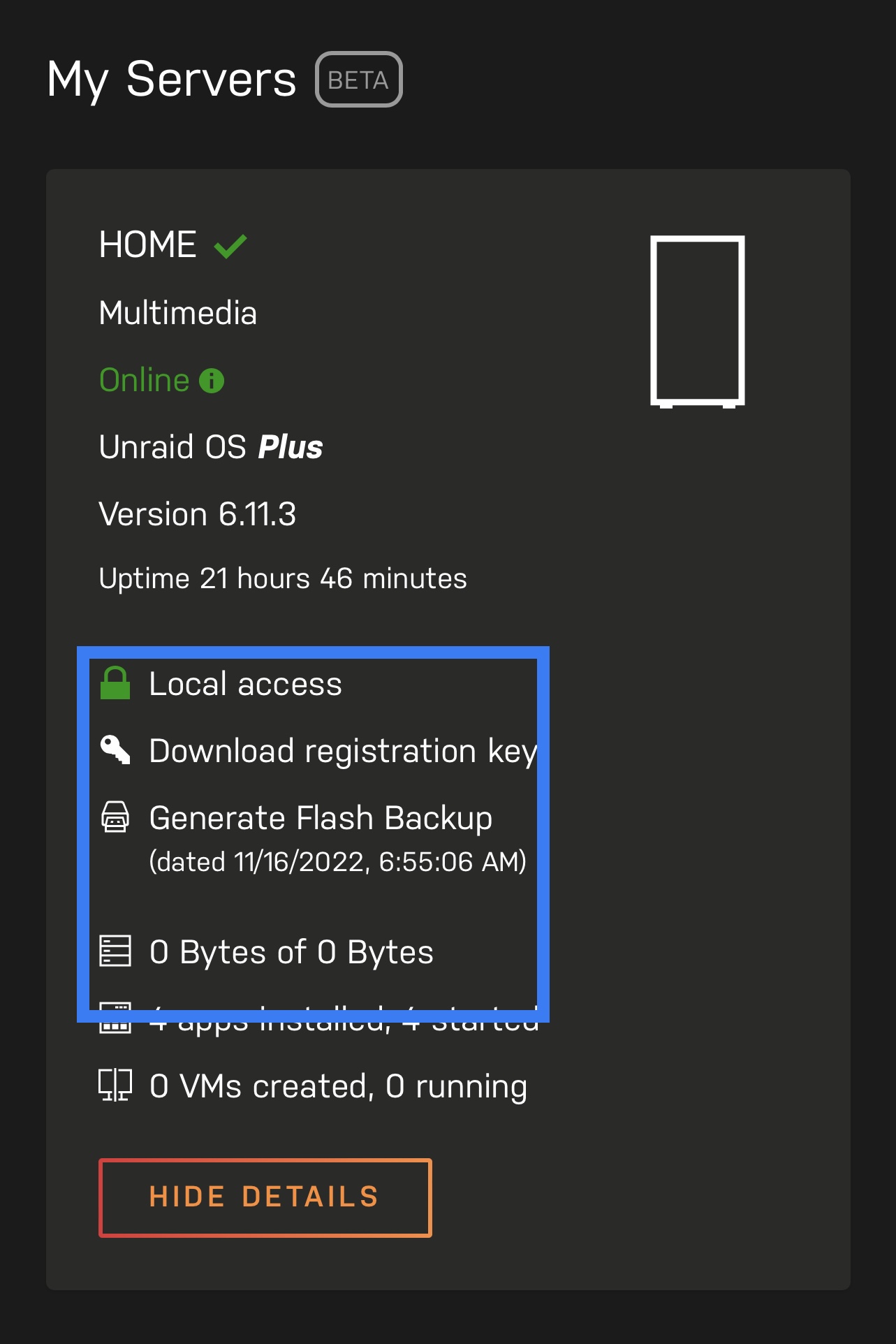

Everything is fine but can’t get array size details?
It’s been a while that I noticed ’my servers’ plug-in works quite well, no api issues.
But when I get access to ’my servers’ dashboard, the array size is 0 bytes. It’s  happened after I updated unRaid version to 6.11.3, my-servers plugin version to 2022.11.02.0859. Before that, all works good…

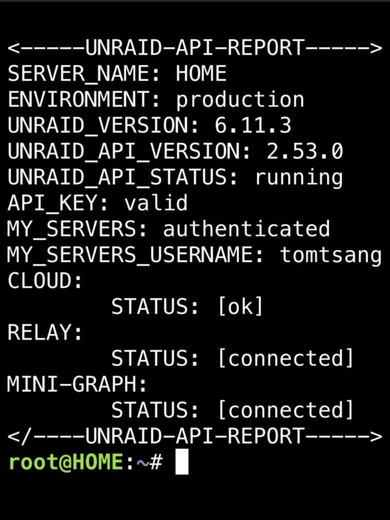

Also, please wait a few minutes and then give me the output of this so I can confirm what version you are running:
unraid-api report

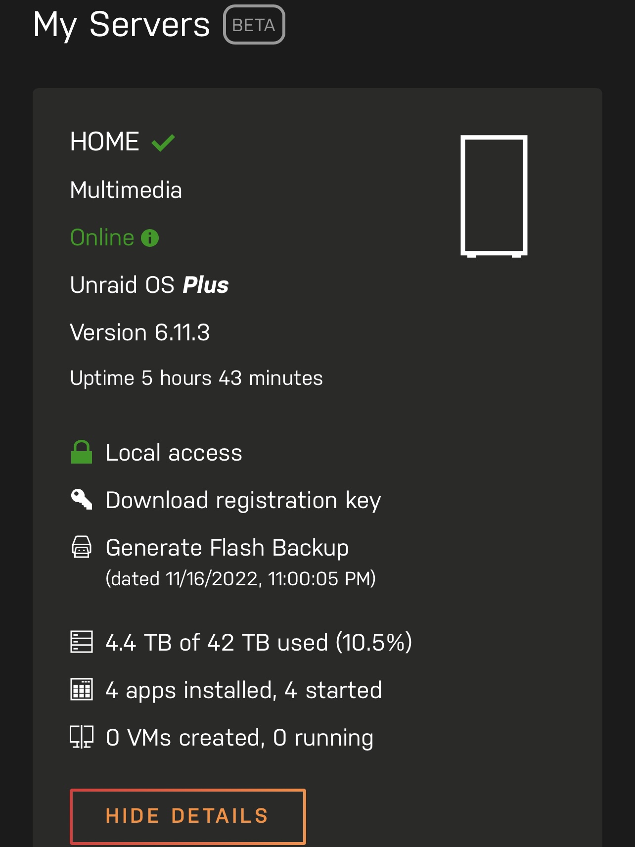

I’ve tried rebooting my unRaid server, and restarting the api services before but still the same, this time it works… 🤩 thanks for the solution.

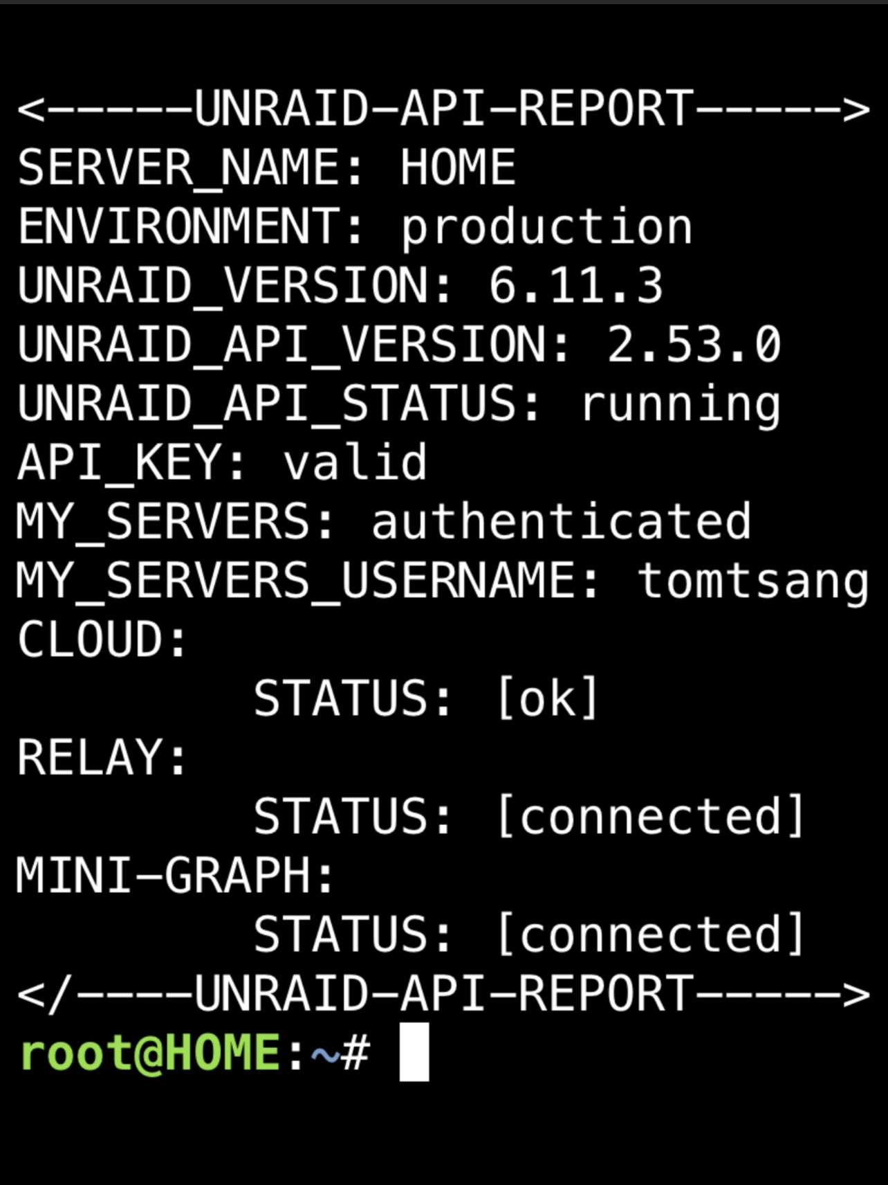

unraid-api report
My array status’ backkkk!!!🌹
Thanks for confirming, this will be fixed in the next release of the My Servers plugin

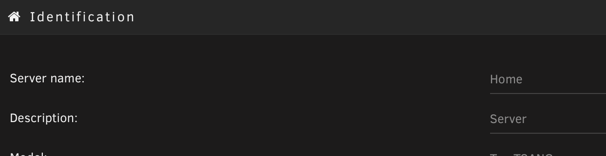

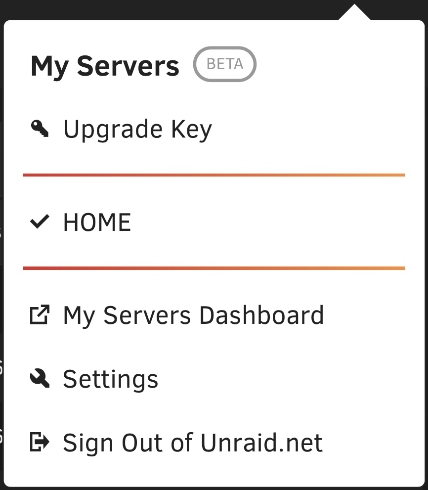

Hi, @ljm42
It's me again... Found an issue that at the right top corner where My Server plugin located, the 'Identification -> Server name' comes after 'Identification -> Description' would not be shown unless refreshing the webui page, then it's gone after that...
I've tried restarting the api, reboot the server... not working, either. api report tells the status without errors.
Thanks for reporting, I hadn't noticed it previously but can confirm it is happening.
I found it today while I was about to access my server from right top corner, I didn’t notice that until today, either… it’s just a minor issue, but not affecting at all, btw.
