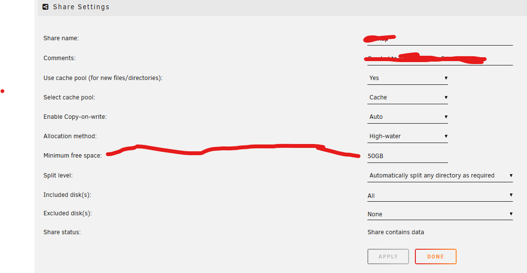

First thing that I found is that you have not set a min free space parameter on your most of your shares.  (I did not check them all since you have so many...)  See below:
 This value should be approximately twice as big as the largest file that you would be expecting to write to that share.  (If there is not enough space to write a file on a drive, the write will fail.  This is not logged unless you turn on Mover Logging.   You don't normally want to turn this logging as it will spam your log with a line for every file being written...)
