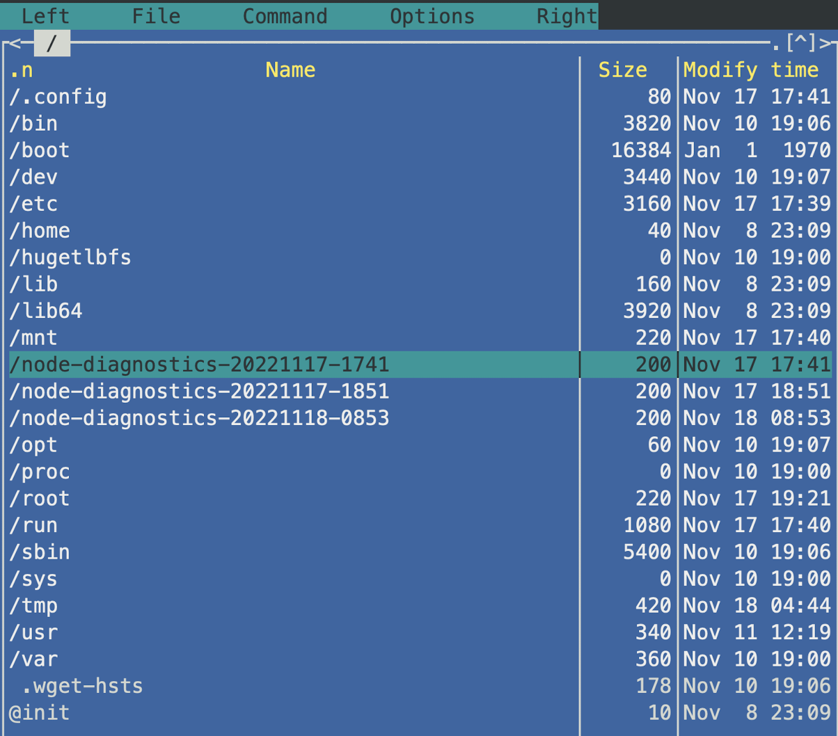

I've launched the diagnostic through the SSH client and I was expecting to retrieve a zip file.
Nothing happens, only the message "Starting diagnostic collection..."
If I have a look to the NAS through the SSH client, I can see this (diagnostic launched 3 times) :
Is it what you need ?
It may take a few minutes, if it doesn't finish after 15 min or so reboot.

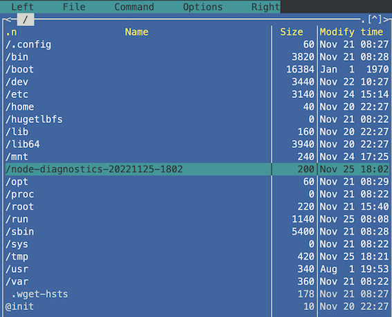

Back to this topic as I have the same issue than previously : once again, no access to the web UI of UNRAID but everything is still working (access to the shared directories, container are running).
I've tried to connect to the NAS via SSH to launch the diagnostics before rebooting in order for you to check the problem but no file generated and the process is still running :
When I have a look in the NAS directory where the previous drags files were stored (/boot/logs), the directory is empty.
I can only see this directory created by the diagnostic process but no zip file.
Do you have some recommendations to retrieve the diagnostic files to understand the problem ?
