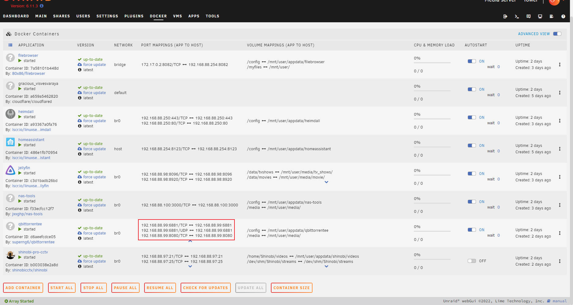

Hey guys, I set up my home server at home (obviously LOL), and in China I do not have a public IPv4 or IPv6 address.
I set up several cloudflare tunnels so that I can visit the portal (which is not recommended) and some docker image (namely, qBittorrent) from outside.

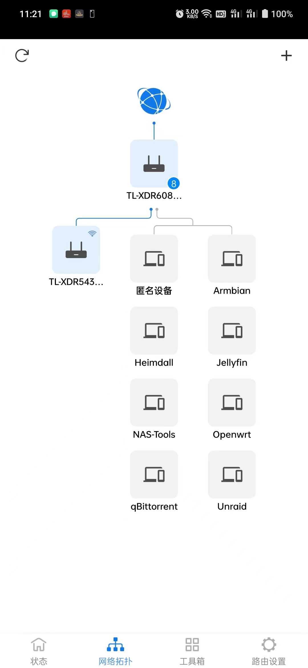

Unraid: unraid.yxiao.org (this works as I can see from main router topology)
BT: bt.yxiao.org (before, it works with no openwrt as gateway; now it does not)
## Current situation
Main router 192.168.88.1/24
OpenWRT Gateway 192.168.88.252
Unraid 192.168.88.254
I set unraid gateway to 88.252 because I need to use openclash as proxy.
### Network config
Unraid:
gateway 192.168.88.252
dns 223.5.5.5
Openwrt
gateway 192.168.88.1
dns 192.168.88.1
So how can I visit docker image (I am using custom br0, or maybe I should just use bridge?) with cloudflare tunnels.
