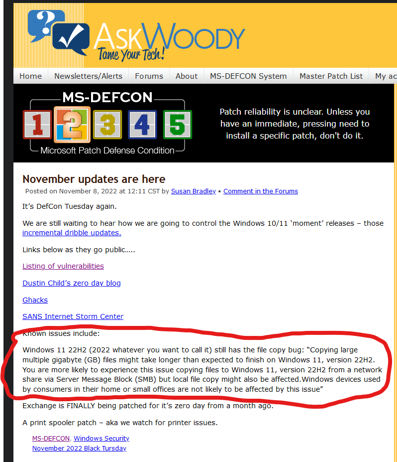

Could this be a cause?
Thank you @Frank1940. However, it was not that issue.
I followed that trail to the Microsoft issue page and then tried the workaround with no avail.
https://support.microsoft.com/en-us/topic/september-30-2022-kb5017389-os-build-22621-608-preview-62f353a0-696a-49d8-a78f-a14910f30ae3#knownissues
I tried the mitigation below but it didn't make a difference =(.
To mitigate this issue, you can use file copy tools that do not use cache manager (buffered I/O). This can be done by using the built-in command-line tools listed below:
robocopy \\someserver\someshare c:\somefolder somefile.img /J
