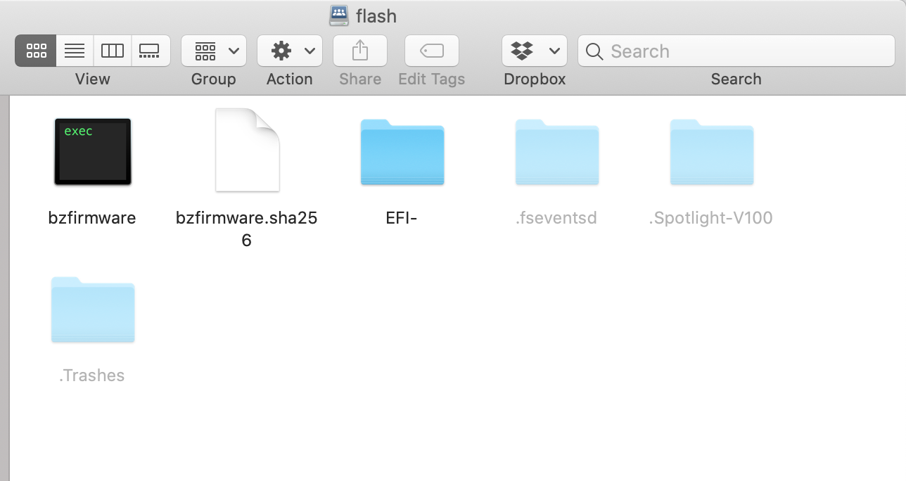

I am trying to access my flash drive from my mac by simply clicking the Unraid server in the Network section of my Finder window and then clicking "Flash" but I am getting the error "The operation can’t be completed because the original item for “flash” can’t be found." Looking at the top of the Finder window it says that I am connected as "Guest," however when I try to connect as "root" it does nothing at all (I am unsure if this is the issue since I can view the rest of the server without logging in as "root" at this time). The reason I am trying to access the Flash drive is because I want to confirm that I have a current config/super.dat before I move my drives into a new server. Thanks

I changed security from Private to Secure, and now it works. That being said, I do not seem to have a config folder on the flash drive. What should I do to find it and make sure my server is set up correctly before I transfer all the drives? Diagnostics are attached. Thanks a ton.

That screenshot shows you DO have config folder on the flash drive.
That's what it looks like to me as well, but why do I not see it when browsing the drive? I am using the standard finder in mac to look at the folders. I also looked at hidden files, but there is no folder called config. I just don't want an issue backtracking to make the move to a new server work, I would like to be as close to certain that everything will be a smooth transition. Thank you for the help, you are all awesome.
Look more like a Mac problem, do you see all the other folders or only the files? Try with a PC or Android device if available.
Ill see if I can boot up an old PC and check.
