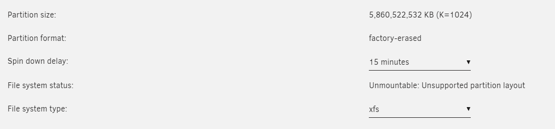

Version 6.11.2 Unmountable: Unsupported partition layout Help!
I'm really struggling to get Unraid to format my drives.  I can manually partition, mount and format them from the terminal but have no luck when formatting them as part of an array. My manually formatted drives also report the same problem: -
I've just precleared the drives and have exactly the same problem.  I've waded through some of the diagnostics but can't really spot any problems apart from a couple of bad sectors on one of the drives.  The Drives are not new but no additional errors were detected when performing the pre-clear.
Any help would be appreciated.  I've  had a look through the forum and found people with similar problems but no real solution.  If there's a post that will help then please call me stupid and point me in the correct direction.

There was a bug for drive > 2tb fixed in 6.11.3
Thank you!  That was driving me bonkers.
