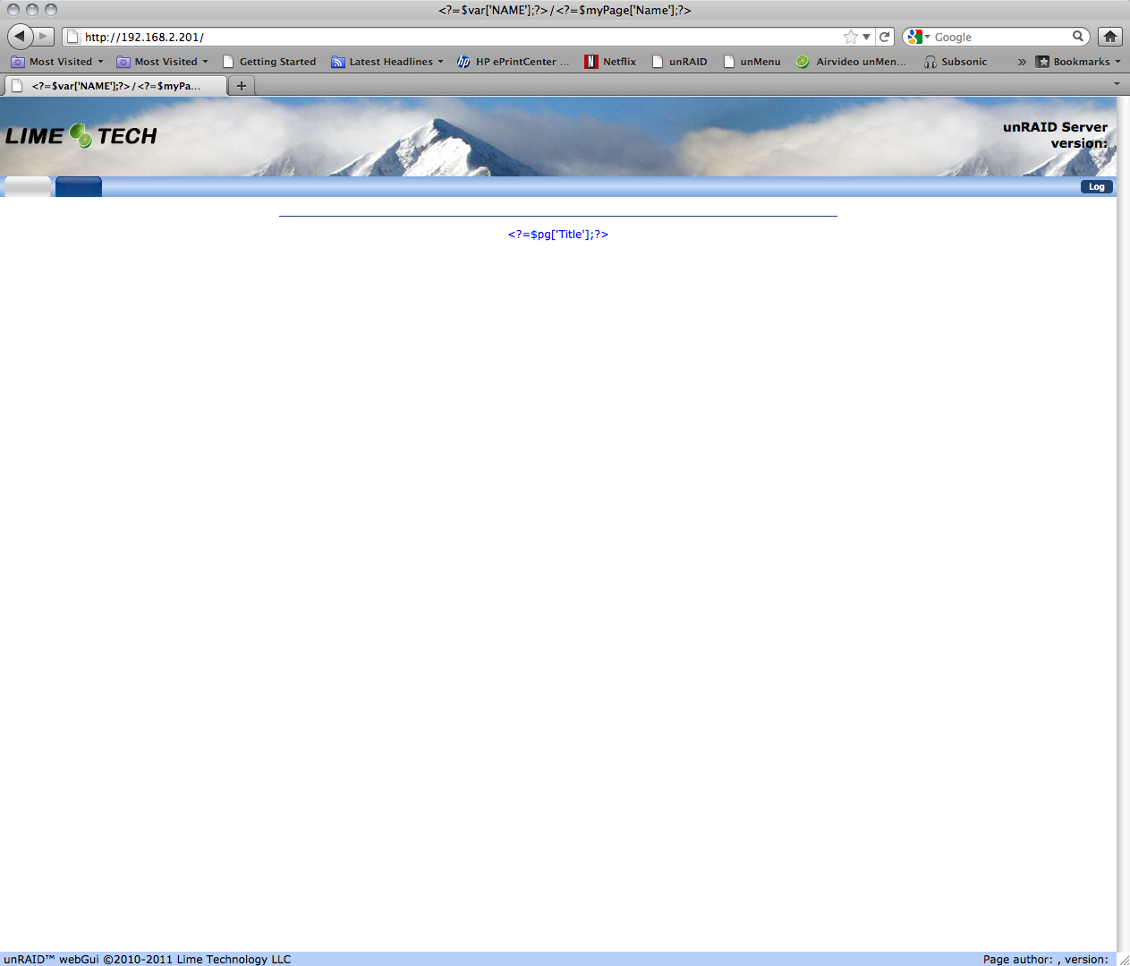

July 5, 201115 yr running into the same problem where the webGUI is not reachable all over a sudden. When the server is rebooted, before the parity check is completed, the WebGUI is accessible, but thereafter no dice running 4.6rc5 any ideas? Thanks syslog-2011-07-04.txt

July 5, 201115 yr Author so i now commented out all but the first and last instructions of the go script (i also know now that the syntax of my directory in/exclusions for the cache_dirs are wrong, but don't yet know how to properly name them): #!/bin/bash # Start the Management Utility /usr/local/sbin/emhttp & #!/ /boot/boot/cache_dirs -w -e "Downloads*" -e "_BAK*" -i "Media*" -i "Movies*" -i "Music*" -i "Production*" -i "Software*" #!/ installpkg /boot/packages_global/powerdown-1.02-noarch-unRAID.tgz #!/ installpkg /boot/packages_global/jre-6u20-i586-1.txz #!/ installpkg /boot/packages/simpleFeatures-0.4-unraid-speeding_ant.tgz #!/ sleep 30 #!/ /boot/scripts/subsonic_start.sh #!/ /boot/scripts/shutdown_jobs_add.sh cd /boot/packages && find . -name '*.auto_install' -type f -print | sort | xargs -n1 sh -c unraid_notify start but even with this minimal go script, i still get strange behavior of the default WebGUI...it looks like this (see attachment). i don't get how this took such a turn for the worse when all was working so well until 2 days ago.
July 5, 201115 yr Author what could be causing the WebGUI to be corrupted now, and be fully dysfunctional...all the user shares (and disk shares) are nowhere to be seen on the network, although the unRAID-SMB and unRAID (AFP) shares do show up (albeit empty)...what could be going on? (no changes since my last syslog)
July 5, 201115 yr what could be causing the WebGUI to be corrupted now, and be fully dysfunctional...all the user shares (and disk shares) are nowhere to be seen on the network, although the unRAID-SMB and unRAID (AFP) shares do show up (albeit empty)...what could be going on? (no changes since my last syslog) I strongly suggest you get rid of the add-on lines in the "go" script until you are stable. (walk before you run) It appears now as if you are installing a package that is overwriting the "php" config and not enabling the short tags. http://lime-technology.com/forum/index.php?topic=11540.msg123329#msg123329

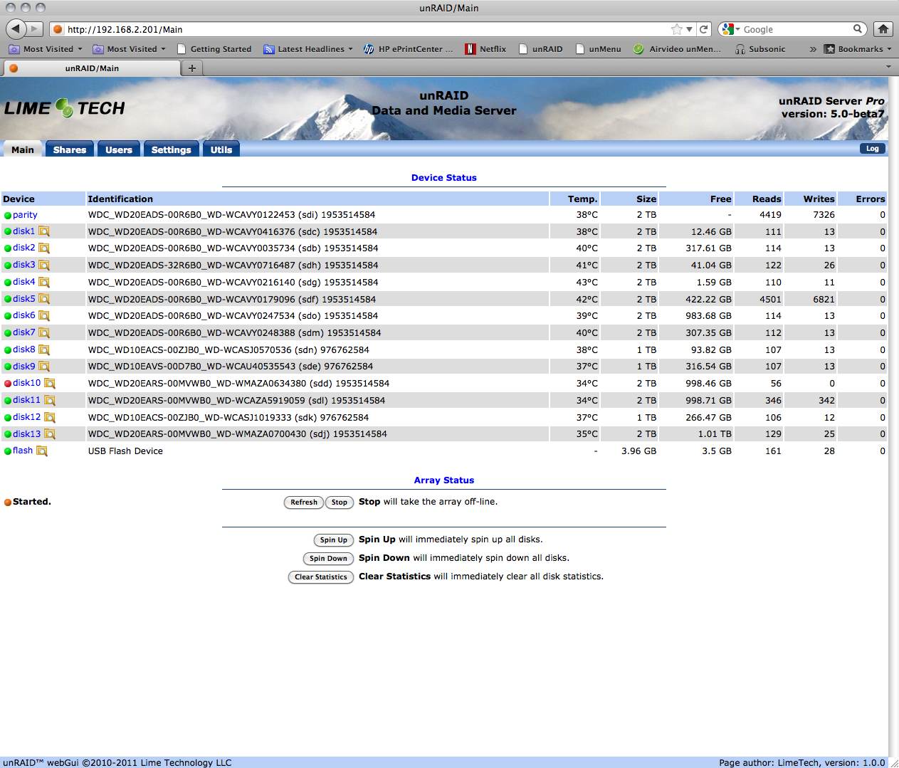

July 5, 201115 yr Author k...i'll try to refrain from using TW then. so the WebGUI is back up, and i was able to start the array...disk- and user-shares also shows up in my finder again...but the array cannot be rebuilt with parity right now (or it doesn't give me that option)...here is my unRAID main screen (see attached). so, as i said, i don't see the usual option to rebuild the array and start parity check! i see that disk 10 is still red, but it's there and recognized...is it not going to (or *cannot*) rebuild until the red disk is green? just for good measure i'll attach the current syslog as well. logically, since there is no valid parity right now, disk 10 being green would have to be necessary to build parity again, no?
