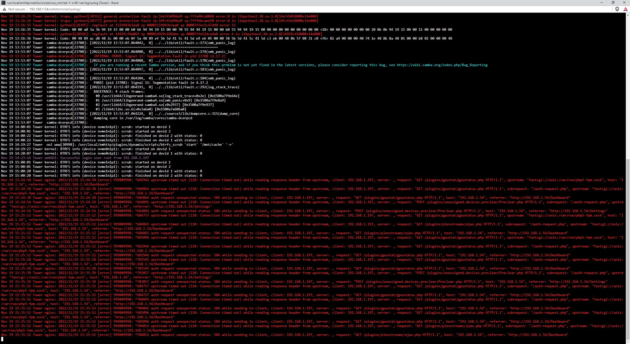

hello for the last 2 weeks i have had a lot of problems with my server.
It all started after a power outage with a unclean shutdown a few weeks ago.
whenever I was doing the parity check, docker would be disabled or not start at all. and many times the cache drive cannot be mounted or is read only. I have now changed the cache drive with a new one. now i get other errors, and the server is very slow, the unraid  gui takes a long time to load.
and plex is corrupting the database even when I restore the appdata from CA APPDATA BACKUP/ from 2 weeks ago. please any help will be greatly appreciated
Nov 19 07:56:01 Tower kernel: docker0: port 12(vethd586829) entered disabled state
Nov 19 07:56:01 Tower kernel: device vethd586829 entered promiscuous mode
Nov 19 07:56:01 Tower kernel: docker0: port 12(vethd586829) entered blocking state
Nov 19 07:56:01 Tower kernel: docker0: port 12(vethd586829) entered forwarding state
Nov 19 07:56:02 Tower kernel: eth0: renamed from vethd1a3182
Nov 19 07:56:02 Tower kernel: IPv6: ADDRCONF(NETDEV_CHANGE): vethd586829: link becomes ready
Nov 19 07:56:02 Tower kernel: docker0: port 12(vethd586829) entered blocking state
Nov 19 07:56:02 Tower kernel: docker0: port 12(vethd586829) entered forwarding state
Nov 19 07:56:03 Tower  avahi-daemon[31459]: Joining mDNS multicast group on interface vethd586829.IPv6 with address fe80::3862:d6ff:fef6:e06e.
Nov 19 07:56:03 Tower  avahi-daemon[31459]: New relevant interface vethd586829.IPv6 for mDNS.
Nov 19 07:56:03 Tower  avahi-daemon[31459]: Registering new address record for fe80::3862:d6ff:fef6:e06e on vethd586829.*.
Nov 19 07:56:43 Tower kernel: docker0: port 13(vethc972820) entered blocking state
Nov 19 07:56:43 Tower kernel: docker0: port 13(vethc972820) entered disabled state
Nov 19 07:56:43 Tower kernel: device vethc972820 entered promiscuous mode
Nov 19 07:56:44 Tower kernel: eth0: renamed from veth0238d9f
Nov 19 07:56:44 Tower kernel: IPv6: ADDRCONF(NETDEV_CHANGE): vethc972820: link becomes ready
Nov 19 07:56:44 Tower kernel: docker0: port 13(vethc972820) entered blocking state
Nov 19 07:56:44 Tower kernel: docker0: port 13(vethc972820) entered forwarding state
Nov 19 07:56:46 Tower  avahi-daemon[31459]: Joining mDNS multicast group on interface vethc972820.IPv6 with address fe80::54b0:f7ff:febb:3166.
Nov 19 07:56:46 Tower  avahi-daemon[31459]: New relevant interface vethc972820.IPv6 for mDNS.
Nov 19 07:56:46 Tower  avahi-daemon[31459]: Registering new address record for fe80::54b0:f7ff:febb:3166 on vethc972820.*.
Nov 19 08:00:02 Tower kernel: BTRFS info (device nvme1n1p1): scrub: started on devid 1
Nov 19 08:00:02 Tower kernel: BTRFS info (device nvme1n1p1): scrub: started on devid 2
Nov 19 08:00:21 Tower kernel: BTRFS info (device nvme1n1p1): scrub: finished on devid 2 with status: 0
Nov 19 08:00:22 Tower kernel: BTRFS info (device nvme1n1p1): scrub: finished on devid 1 with status: 0
Nov 19 08:09:32 Tower kernel: BTRFS warning (device nvme0n1p1): csum failed root 5 ino 1385436 off 25207775232 csum 0x705100d1 expected csum 0xaeb9a940 mirror 1
Nov 19 08:09:32 Tower kernel: BTRFS error (device nvme0n1p1): bdev /dev/nvme0n1p1 errs: wr 0, rd 0, flush 0, corrupt 2, gen 0
Nov 19 09:00:01 Tower kernel: BTRFS info (device nvme1n1p1): scrub: started on devid 1
Nov 19 09:00:01 Tower kernel: BTRFS info (device nvme1n1p1): scrub: started on devid 2
Nov 19 09:00:22 Tower kernel: BTRFS info (device nvme1n1p1): scrub: finished on devid 1 with status: 0
Nov 19 09:00:22 Tower kernel: BTRFS info (device nvme1n1p1): scrub: finished on devid 2 with status: 0
Nov 19 09:57:13 Tower  smbd[9044]: [2022/11/19 09:57:13.204348,  0] ../../source3/smbd/close.c:1485(close_directory)
Nov 19 09:57:13 Tower  smbd[9044]:   Could not close dir! fname=data/media/movies/movies3/Slumberland (2022), fd=33, err=116=Stale file handle
Nov 19 09:57:13 Tower  smbd[9044]: [2022/11/19 09:57:13.204711,  0] ../../source3/smbd/close.c:1485(close_directory)
Nov 19 09:57:13 Tower  smbd[9044]:   Could not close dir! fname=data/media/movies/movies3/Slumberland (2022), fd=35, err=116=Stale file handle
Nov 19 10:00:01 Tower kernel: BTRFS info (device nvme1n1p1): scrub: started on devid 1
Nov 19 10:00:01 Tower kernel: BTRFS info (device nvme1n1p1): scrub: started on devid 2
Nov 19 10:00:20 Tower kernel: BTRFS info (device nvme1n1p1): scrub: finished on devid 2 with status: 0
Nov 19 10:00:20 Tower kernel: BTRFS info (device nvme1n1p1): scrub: finished on devid 1 with status: 0
Nov 19 11:00:01 Tower kernel: BTRFS info (device nvme1n1p1): scrub: started on devid 1
Nov 19 11:00:01 Tower kernel: BTRFS info (device nvme1n1p1): scrub: started on devid 2
Nov 19 11:00:21 Tower kernel: BTRFS info (device nvme1n1p1): scrub: finished on devid 1 with status: 0
Nov 19 11:00:21 Tower kernel: BTRFS info (device nvme1n1p1): scrub: finished on devid 2 with status: 0
Nov 19 12:00:01 Tower kernel: BTRFS info (device nvme1n1p1): scrub: started on devid 1
Nov 19 12:00:01 Tower kernel: BTRFS info (device nvme1n1p1): scrub: started on devid 2
Nov 19 12:00:21 Tower kernel: BTRFS info (device nvme1n1p1): scrub: finished on devid 1 with status: 0
Nov 19 12:00:21 Tower kernel: BTRFS info (device nvme1n1p1): scrub: finished on devid 2 with status: 0
Nov 19 12:55:42 Tower kernel: disk_load[10286]: segfault at c48808 ip 0000000000476bee sp 00007ffec34946d8 error 4 in bash[426000+c5000]
Nov 19 12:55:42 Tower kernel: Code: ff 48 83 ec 08 e8 22 f5 fa ff c7 00 09 00 00 00 b8 ff ff ff ff 48 83 c4 08 c3 66 90 48 8b 05 21 1a 0c 00 48 63 ff 48 8d 04 f8 <48> 8b 10 48 89 30 48 89 d0 c3 0f 1f 84 00 00 00 00 00 48 8b 05 01
Nov 19 13:00:01 Tower kernel: BTRFS info (device nvme1n1p1): scrub: started on devid 1
Nov 19 13:00:01 Tower kernel: BTRFS info (device nvme1n1p1): scrub: started on devid 2
Nov 19 13:00:22 Tower kernel: BTRFS info (device nvme1n1p1): scrub: finished on devid 2 with status: 0
Nov 19 13:00:22 Tower kernel: BTRFS info (device nvme1n1p1): scrub: finished on devid 1 with status: 0
Nov 19 13:16:32 Tower kernel: traps: python3[9593] general protection fault ip:148258d97d11 sp:1482531305b0 error:0 in ld-musl-x86_64.so.1[148258d89000+48000]
Nov 19 13:16:32 Tower kernel: python3[28338]: segfault at 520000 ip 000014965fe9741f sp 00007ffda4683378 error 6 in libpython3.10.so.1.0[14965fe58000+14e000]
Nov 19 13:16:32 Tower kernel: Code: e1 40 4c 8d 57 48 74 0a 4c 8d 57 30 eb 04 4c 8b 57 48 48 89 c6 4c 89 d7 e8 7e 0c fc ff 5a 85 c0 40 0f 94 c6 40 0f b6 c6 c3 c3 <48> ff 0f 75 02 eb 6b c3 48 89 f8 48 8d 15 ef 69 22 00 48 c1 e8 26
Nov 19 13:16:33 Tower kernel: traps: python3[28352] general protection fault ip:14e5fb096bd9 sp:7ffe40cdd060 error:0 in libpython3.10.so.1.0[14e5fb058000+14e000]
Nov 19 13:16:34 Tower kernel: traps: python3[28377] general protection fault ip:14fc43e96bd9 sp:7fffbbcaee50 error:0 in libpython3.10.so.1.0[14fc43e58000+14e000]
Nov 19 13:16:35 Tower kernel: python3[28395]: segfault at 1519943b3aa0 ip 00001519943b3aa0 sp 00007ffec5c47d98 error 15
Nov 19 13:16:35 Tower kernel: Code: 00 00 a0 3a 3b 94 19 15 00 00 b0 66 94 94 19 15 00 00 70 55 94 94 19 15 00 00 b0 55 94 94 19 15 00 00 00 00 00 00 00 00 00 00 <18> 00 00 00 00 00 00 00 20 0b 8b 94 19 15 00 00 11 00 00 00 00 00
Nov 19 13:16:36 Tower kernel: python3[28566]: segfault at 14929cf0a069 ip 000014929c696bbe sp 00007ffe52dce4a8 error 4 in libpython3.10.so.1.0[14929c658000+14e000]
Nov 19 13:16:36 Tower kernel: Code: 00 48 89 ac d8 48 2c 00 00 eb 0f 5a 48 89 ef 5b 5d 41 5c 41 5d e9 e6 05 00 00 58 5b 5d 41 5c 41 5d c3 eb 00 48 8b 57 08 31 c0 <f6> 82 a9 00 00 00 40 74 1e 48 8b 8a 48 01 00 00 b8 01 00 00 00 48
Nov 19 13:53:07 Tower  samba-dcerpcd[23708]: [2022/11/19 13:53:07.064042,  0] ../../lib/util/fault.c:173(smb_panic_log)
Nov 19 13:53:07 Tower  samba-dcerpcd[23708]:   ===============================================================
Nov 19 13:53:07 Tower  samba-dcerpcd[23708]: [2022/11/19 13:53:07.064080,  0] ../../lib/util/fault.c:174(smb_panic_log)
Nov 19 13:53:07 Tower  samba-dcerpcd[23708]:   INTERNAL ERROR: Signal 11: Segmentation fault in pid 23708 (4.17.2)
Nov 19 13:53:07 Tower  samba-dcerpcd[23708]: [2022/11/19 13:53:07.064088,  0] ../../lib/util/fault.c:178(smb_panic_log)
Nov 19 13:53:07 Tower  samba-dcerpcd[23708]:   If you are running a recent Samba version, and if you think this problem is not yet fixed in the latest versions, please consider reporting this bug, see https://wiki.samba.org/index.php/Bug_Reporting
Nov 19 13:53:07 Tower  samba-dcerpcd[23708]: [2022/11/19 13:53:07.064097,  0] ../../lib/util/fault.c:183(smb_panic_log)
Nov 19 13:53:07 Tower  samba-dcerpcd[23708]: [2022/11/19 13:53:07.064104,  0] ../../lib/util/fault.c:184(smb_panic_log)
Nov 19 13:53:07 Tower  samba-dcerpcd[23708]:   PANIC (pid 23708): Signal 11: Segmentation fault in 4.17.2
Nov 19 13:53:07 Tower  samba-dcerpcd[23708]: [2022/11/19 13:53:07.064193,  0] ../../lib/util/fault.c:292(log_stack_trace)
Nov 19 13:53:07 Tower  samba-dcerpcd[23708]:   BACKTRACE: 4 stack frames:
Nov 19 13:53:07 Tower  samba-dcerpcd[23708]:    #0 /usr/lib64/libgenrand-samba4.so(log_stack_trace+0x2e) [0x1500a7f9e64e]
Nov 19 13:53:07 Tower  samba-dcerpcd[23708]:    #1 /usr/lib64/libgenrand-samba4.so(smb_panic+0x9) [0x1500a7f9e8a9]
Nov 19 13:53:07 Tower  samba-dcerpcd[23708]:    #2 /usr/lib64/libgenrand-samba4.so(+0x2937) [0x1500a7f9e937]
Nov 19 13:53:07 Tower  samba-dcerpcd[23708]:    #3 /lib64/libc.so.6(+0x3a6a0) [0x1500a7a606a0]
Nov 19 13:53:07 Tower  samba-dcerpcd[23708]: [2022/11/19 13:53:07.064224,  0] ../../source3/lib/dumpcore.c:315(dump_core)
Nov 19 13:53:07 Tower  samba-dcerpcd[23708]:   dumping core in /var/log/samba/cores/samba-dcerpcd
Nov 19 14:00:01 Tower kernel: BTRFS info (device nvme1n1p1): scrub: started on devid 1
Nov 19 14:00:01 Tower kernel: BTRFS info (device nvme1n1p1): scrub: started on devid 2
Nov 19 14:00:22 Tower kernel: BTRFS info (device nvme1n1p1): scrub: finished on devid 2 with status: 0
Nov 19 14:00:22 Tower kernel: BTRFS info (device nvme1n1p1): scrub: finished on devid 1 with status: 0
Nov 19 14:19:27 Tower  ool www[30998]: /usr/local/emhttp/plugins/dynamix/scripts/btrfs_scrub 'start' '/mnt/cache' '-r'
Nov 19 14:19:27 Tower kernel: BTRFS info (device nvme0n1p1): scrub: started on devid 1
Nov 19 14:20:07 Tower kernel: BTRFS info (device nvme0n1p1): scrub: finished on devid 1 with status: 0
Nov 19 14:23:14 Tower webGUI: Successful login user root from 192.168.1.197
Nov 19 15:00:01 Tower kernel: BTRFS info (device nvme1n1p1): scrub: started on devid 1
Nov 19 15:00:01 Tower kernel: BTRFS info (device nvme1n1p1): scrub: started on devid 2
Nov 19 15:00:20 Tower kernel: BTRFS info (device nvme1n1p1): scrub: finished on devid 1 with status: 0
Nov 19 15:00:20 Tower kernel: BTRFS info (device nvme1n1p1): scrub: finished on devid 2 with status: 0
Nov 19 15:24:38 Tower nginx: 2022/11/19 15:24:38 [error] 9998#9998: *682942 upstream timed out (110: Connection timed out) while reading response header from upstream, client: 192.168.1.197, server: , request: "GET /plugins/gpustat/gpustatus.php HTTP/1.1", upstream: "fastcgi://unix:/var/run/php5-fpm.sock", host: "192.168.1.54", referrer: "http://192.168.1.54/Dashboard"
Nov 19 15:24:38 Tower nginx: 2022/11/19 15:24:38 [error] 9998#9998: *684864 upstream timed out (110: Connection timed out) while reading response header from upstream, client: 192.168.1.197, server: , request: "GET /plugins/gpustat/gpustatus.php HTTP/1.1", subrequest: "/auth-request.php", upstream: "fastcgi://unix:/var/run/php5-fpm.sock", host: "192.168.1.54", referrer: "http://192.168.1.54/Dashboard"
Nov 19 15:24:38 Tower nginx: 2022/11/19 15:24:38 [error] 9998#9998: *684864 auth request unexpected status: 504 while sending to client, client: 192.168.1.197, server: , request: "GET /plugins/gpustat/gpustatus.php HTTP/1.1", host: "192.168.1.54", referrer: "http://192.168.1.54/Dashboard"
Nov 19 15:24:54 Tower nginx: 2022/11/19 15:24:54 [error] 9998#9998: *664891 upstream timed out (110: Connection timed out) while reading response header from upstream, client: 192.168.1.197, server: , request: "POST /plugins/unassigned.devices.preclear/Preclear.php HTTP/1.1", subrequest: "/auth-request.php", upstream: "fastcgi://unix:/var/run/php5-fpm.sock", host: "192.168.1.54", referrer: "http://192.168.1.54/Settings"
Nov 19 15:24:54 Tower nginx: 2022/11/19 15:24:54 [error] 9998#9998: *664891 auth request unexpected status: 504 while sending to client, client: 192.168.1.197, server: , request: "POST /plugins/unassigned.devices.preclear/Preclear.php HTTP/1.1", host: "192.168.1.54", referrer: "http://192.168.1.54/Settings"
Nov 19 15:25:12 Tower nginx: 2022/11/19 15:25:12 [error] 9998#9998: *684757 upstream timed out (110: Connection timed out) while reading response header from upstream, client: 192.168.1.197, server: , request: "GET /plugins/gpustat/gpustatus.php HTTP/1.1", upstream: "fastcgi://unix:/var/run/php5-fpm.sock", host: "192.168.1.54", referrer: "http://192.168.1.54/Dashboard"
Nov 19 15:25:12 Tower nginx: 2022/11/19 15:25:12 [error] 9998#9998: *684865 upstream timed out (110: Connection timed out) while reading response header from upstream, client: 192.168.1.197, server: , request: "GET /plugins/plexstreams/ajax.php HTTP/1.1", subrequest: "/auth-request.php", upstream: "fastcgi://unix:/var/run/php5-fpm.sock", host: "192.168.1.54", referrer: "http://192.168.1.54/Dashboard"
Nov 19 15:25:12 Tower nginx: 2022/11/19 15:25:12 [error] 9998#9998: *684865 auth request unexpected status: 504 while sending to client, client: 192.168.1.197, server: , request: "GET /plugins/plexstreams/ajax.php HTTP/1.1", host: "192.168.1.54", referrer: "http://192.168.1.54/Dashboard"
Nov 19 15:25:12 Tower nginx: 2022/11/19 15:25:12 [error] 9998#9998: *685096 upstream timed out (110: Connection timed out) while reading response header from upstream, client: 192.168.1.197, server: , request: "GET /plugins/gpustat/gpustatus.php HTTP/1.1", upstream: "fastcgi://unix:/var/run/php5-fpm.sock", host: "192.168.1.54", referrer: "http://192.168.1.54/Dashboard"
Nov 19 15:25:12 Tower nginx: 2022/11/19 15:25:12 [error] 9998#9998: *682946 upstream timed out (110: Connection timed out) while reading response header from upstream, client: 192.168.1.197, server: , request: "GET /plugins/gpustat/gpustatus.php HTTP/1.1", subrequest: "/auth-request.php", upstream: "fastcgi://unix:/var/run/php5-fpm.sock", host: "192.168.1.54", referrer: "http://192.168.1.54/Dashboard"
Nov 19 15:25:12 Tower nginx: 2022/11/19 15:25:12 [error] 9998#9998: *682946 auth request unexpected status: 504 while sending to client, client: 192.168.1.197, server: , request: "GET /plugins/gpustat/gpustatus.php HTTP/1.1", host: "192.168.1.54", referrer: "http://192.168.1.54/Dashboard"
Nov 19 15:35:18 Tower nginx: 2022/11/19 15:35:18 [error] 9998#9998: *703545 upstream timed out (110: Connection timed out) while reading response header from upstream, client: 192.168.1.197, server: , request: "GET /plugins/gpustat/gpustatus.php HTTP/1.1", subrequest: "/auth-request.php", upstream: "fastcgi://unix:/var/run/php5-fpm.sock", host: "192.168.1.54", referrer: "http://192.168.1.54/Dashboard"
Nov 19 15:35:18 Tower nginx: 2022/11/19 15:35:18 [error] 9998#9998: *703545 auth request unexpected status: 504 while sending to client, client: 192.168.1.197, server: , request: "GET /plugins/gpustat/gpustatus.php HTTP/1.1", host: "192.168.1.54", referrer: "http://192.168.1.54/Dashboard"
Nov 19 15:35:39 Tower nginx: 2022/11/19 15:35:39 [error] 9998#9998: *703857 upstream timed out (110: Connection timed out) while reading response header from upstream, client: 192.168.1.197, server: , request: "POST /plugins/unassigned.devices.preclear/Preclear.php HTTP/1.1", subrequest: "/auth-request.php", upstream: "fastcgi://unix:/var/run/php5-fpm.sock", host: "192.168.1.54", referrer: "http://192.168.1.54/Settings"
Nov 19 15:35:39 Tower nginx: 2022/11/19 15:35:39 [error] 9998#9998: *703857 auth request unexpected status: 504 while sending to client, client: 192.168.1.197, server: , request: "POST /plugins/unassigned.devices.preclear/Preclear.php HTTP/1.1", host: "192.168.1.54", referrer: "http://192.168.1.54/Settings"
Nov 19 15:35:52 Tower nginx: 2022/11/19 15:35:52 [error] 9998#9998: *684757 upstream timed out (110: Connection timed out) while reading response header from upstream, client: 192.168.1.197, server: , request: "GET /plugins/gpustat/gpustatus.php HTTP/1.1", subrequest: "/auth-request.php", upstream: "fastcgi://unix:/var/run/php5-fpm.sock", host: "192.168.1.54", referrer: "http://192.168.1.54/Dashboard"
Nov 19 15:35:52 Tower nginx: 2022/11/19 15:35:52 [error] 9998#9998: *684757 auth request unexpected status: 504 while sending to client, client: 192.168.1.197, server: , request: "GET /plugins/gpustat/gpustatus.php HTTP/1.1", host: "192.168.1.54", referrer: "http://192.168.1.54/Dashboard"
Nov 19 15:35:52 Tower nginx: 2022/11/19 15:35:52 [error] 9998#9998: *704045 upstream timed out (110: Connection timed out) while reading response header from upstream, client: 192.168.1.197, server: , request: "GET /plugins/gpustat/gpustatus.php HTTP/1.1", subrequest: "/auth-request.php", upstream: "fastcgi://unix:/var/run/php5-fpm.sock", host: "192.168.1.54", referrer: "http://192.168.1.54/Dashboard"
Nov 19 15:35:52 Tower nginx: 2022/11/19 15:35:52 [error] 9998#9998: *704045 auth request unexpected status: 504 while sending to client, client: 192.168.1.197, server: , request: "GET /plugins/gpustat/gpustatus.php HTTP/1.1", host: "192.168.1.54", referrer: "http://192.168.1.54/Dashboard"
Nov 19 15:35:52 Tower nginx: 2022/11/19 15:35:52 [error] 9998#9998: *685096 upstream timed out (110: Connection timed out) while reading response header from upstream, client: 192.168.1.197, server: , request: "GET /plugins/gpustat/gpustatus.php HTTP/1.1", subrequest: "/auth-request.php", upstream: "fastcgi://unix:/var/run/php5-fpm.sock", host: "192.168.1.54", referrer: "http://192.168.1.54/Dashboard"
Nov 19 15:35:52 Tower nginx: 2022/11/19 15:35:52 [error] 9998#9998: *685096 auth request unexpected status: 504 while sending to client, client: 192.168.1.197, server: , request: "GET /plugins/gpustat/gpustatus.php HTTP/1.1", host: "192.168.1.54", referrer: "http://192.168.1.54/Dashboard"
Nov 19 15:35:52 Tower nginx: 2022/11/19 15:35:52 [error] 9998#9998: *704052 upstream timed out (110: Connection timed out) while reading response header from upstream, client: 192.168.1.197, server: , request: "GET /plugins/plexstreams/ajax.php HTTP/1.1", subrequest: "/auth-request.php", upstream: "fastcgi://unix:/var/run/php5-fpm.sock", host: "192.168.1.54", referrer: "http://192.168.1.54/Dashboard"
Nov 19 15:35:52 Tower nginx: 2022/11/19 15:35:52 [error] 9998#9998: *704052 auth request unexpected status: 504 while sending to client, client: 192.168.1.197, server: , request: "GET /plugins/plexstreams/ajax.php HTTP/1.1", host: "192.168.1.54", referrer: "http://192.168.1.54/Dashboard"

There are different apps crashing and btrfs detecting data corruption, start by running memtest.

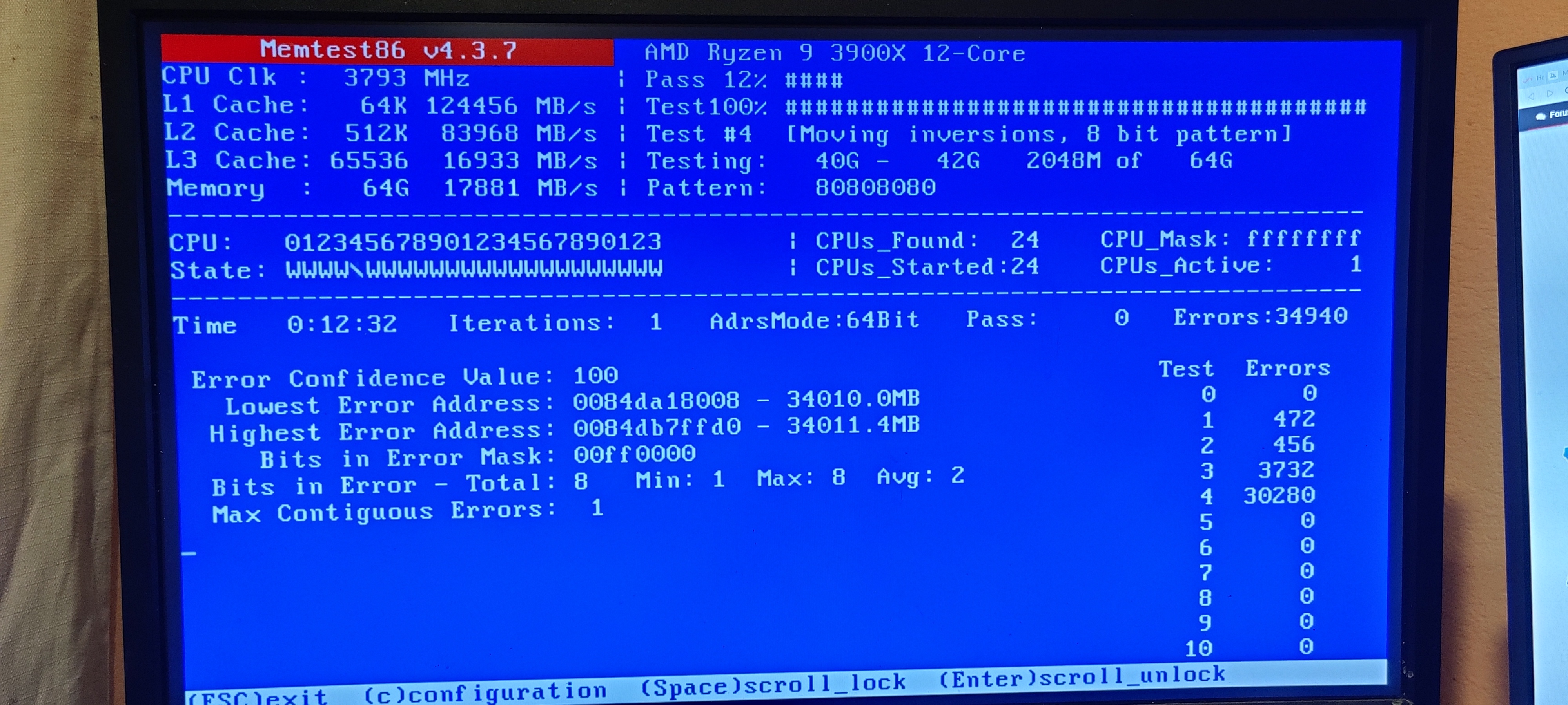

 well i just run memtest and there is a lot of errors, within just a few seconds of running the test. i have try to troubleshoot by lowering ram speed below the ram spec. but no I'm getting same errors. should i claim the warranty ?
🤞so far looks promising with the new ram.🤞
not getting the nasty errors for now. ill will update in a few hours
thank you for the recommendations.
