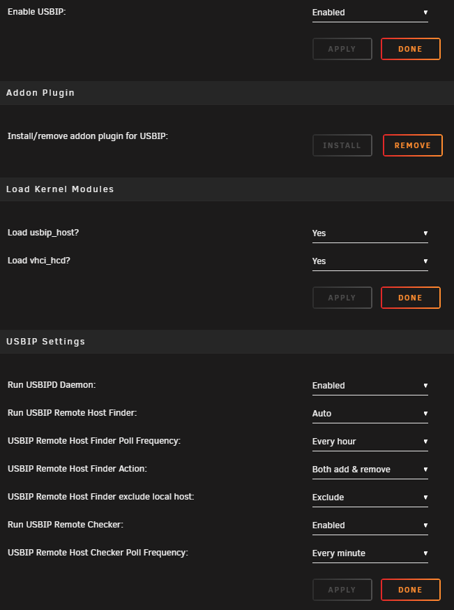

For that, start by installing the requirements on Unraid side:
  • Install the "USB Manager" plugin.
  • Go to Settings -> USB Devices, click the cog on the top right to access the settings
  • Enable "Enable USBIP", Install the addon plugin, select Yes to both entries under "Load Kernel Modules", enable the USBIPD Daemon

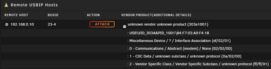

Finally connect unraid to the device:
On the USB page Unraid should find the remote server and list its devices. If not click "Add remote system" and search for servers.
Click Attach. The device will now be presented to Unraid in the same was as if it was physically connected, so you can follow the "Local Connection" section to find it and bind it to the container.
