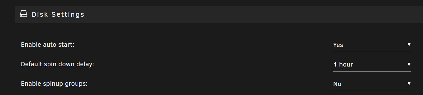

3. any idea how to configure a VM to autostart on system boot? the 'autostart' toggle in the vms tab doesn't seem to do the job...
 I am guessing it's a bug, but is there a fix for it in later versions (I am running unraid 6.11.1 basic)? or perhaps a workaround?
It will only work for the first array start if the array is also set to autostart.
so basically if i didn't set it to autostart at the very first time then i'm screwed? or did i misunderstand? Please clerify, thanks :)
You can go to Settings --> Disk Settings anytime you want and enable or disable array autostart when unRAID boots up.
It's kind of dumb that this is the only way it works, but at least it works...
