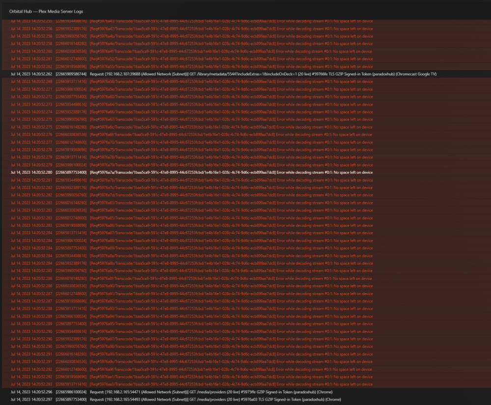

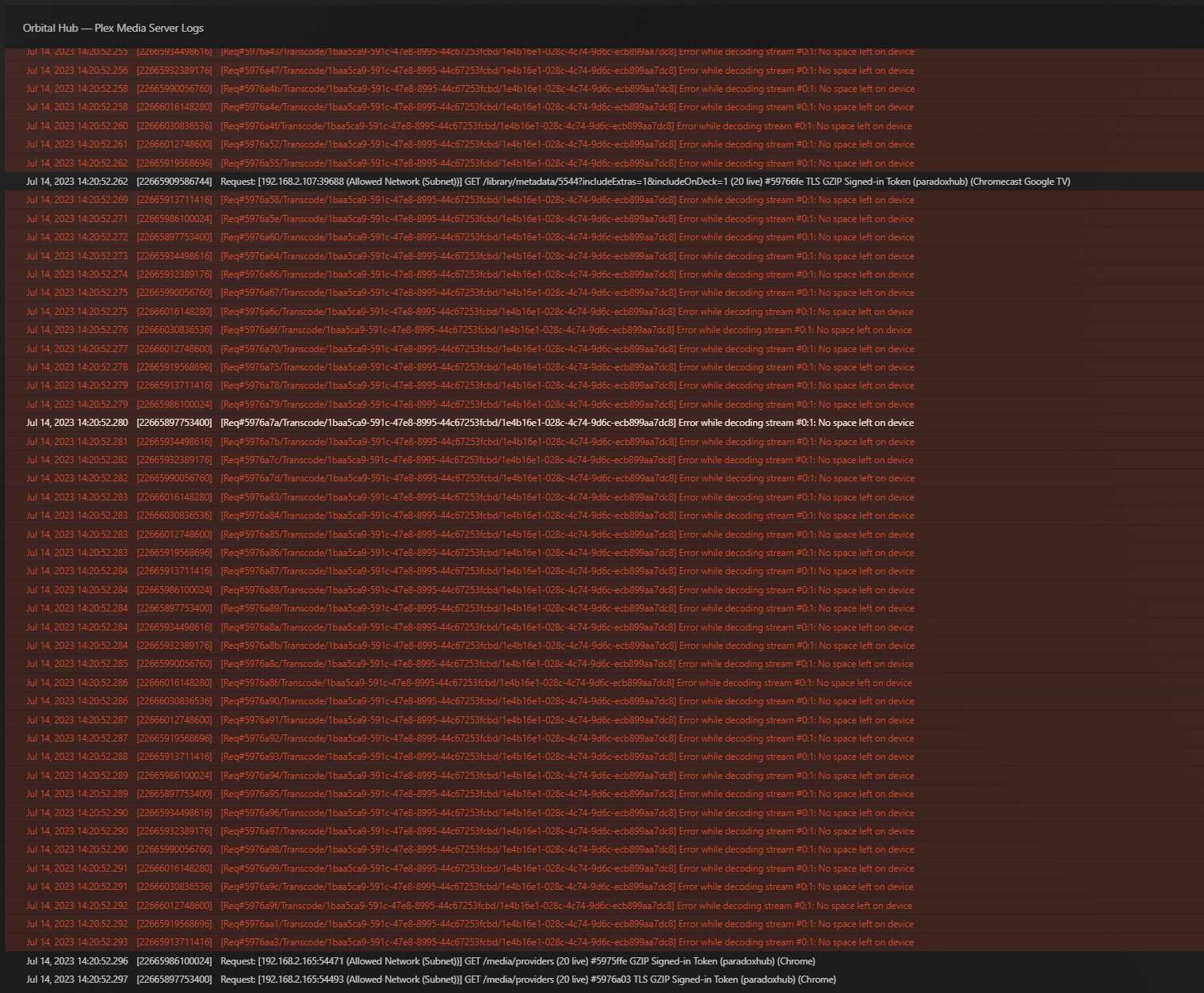

July 14, 20233 yr Did anyone ever get this fixed? I don't think it's 7.1 audio because right now the file only has (EAC3 5.1) audio.

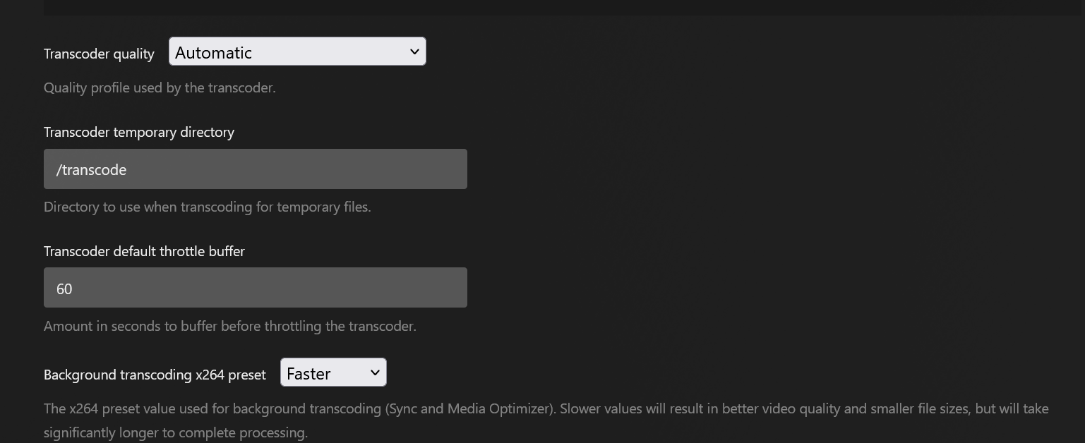

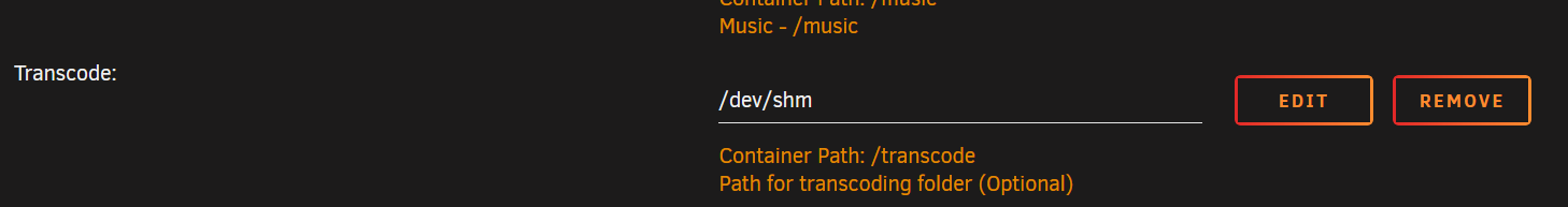

July 25, 20233 yr I too have been getting this. This happens while my Plex is idle, even. Nothing is being watched. Ive deleted EasyAudioDecoder before due to some suggestion i stumbled on before but clearly that hasnt worked. I suspect it just gets redownloaded on the next restart or update. Whats the answer here? For the sake of thoroughness I'll also include the transcode settings i have in Unraid and in Plex to confirm that's not the issue: Unraid lsio Plex containter Plex

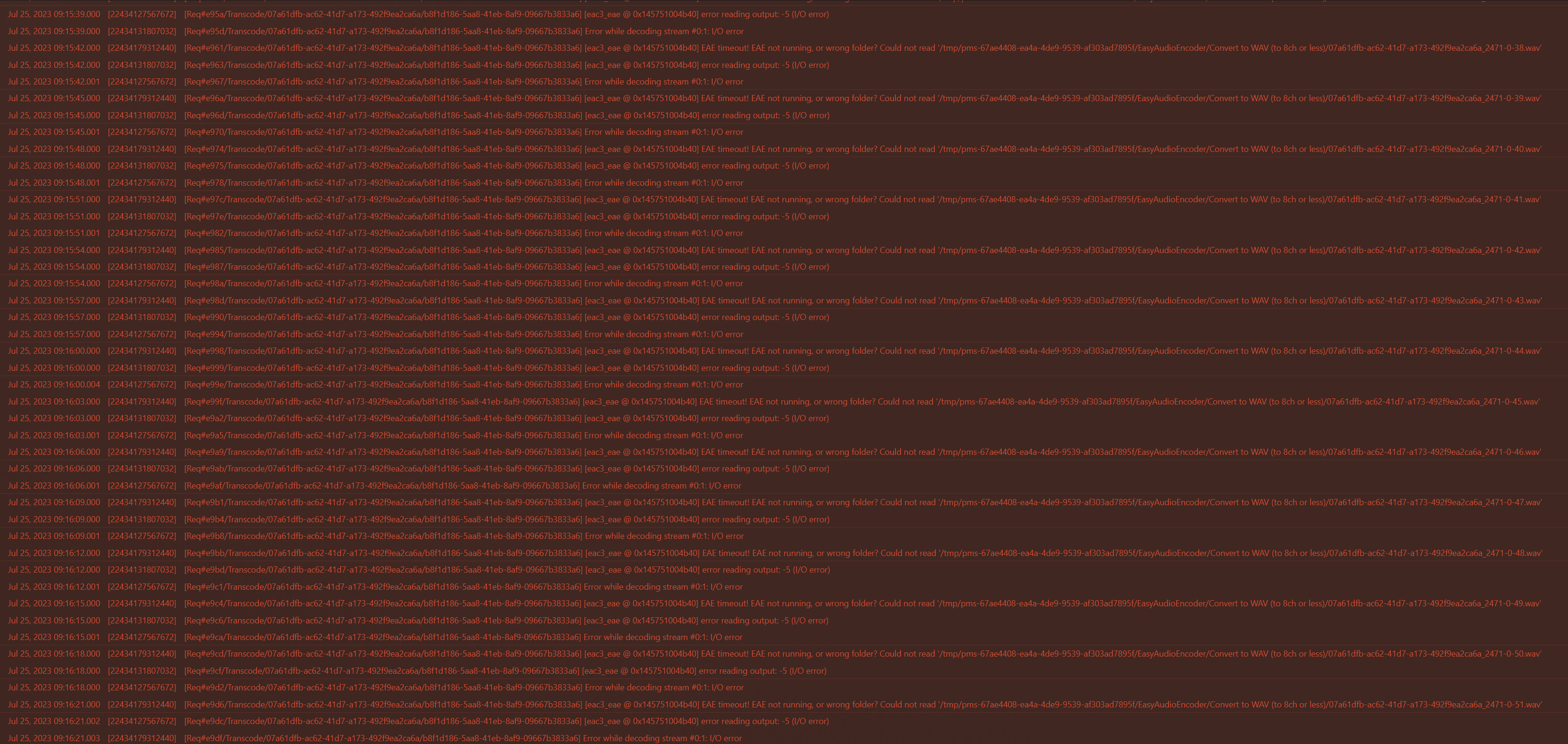

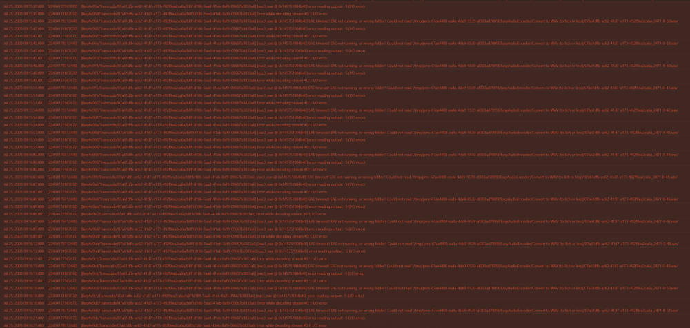

January 9, 20242 yr I hate to necro this, but did anyone else come up with a solution for this? I've also deleted the audio codec and still have this issue. I even setup a job to just do this on the regular and restart the docker and I still get these filling up the entire log: Error while decoding stream #0:1: No space left on device They just fill up the entire log and pegs the CPU, even when nobody is watching. Plex cranks up the CPU usage and maxes out for hours for no reason like this: Again - I've done the audio codec purge on the regular, it still does it after a reset once it sits idle for a spell. I've rebuilt the entire docker, all stock, default transcode config: Space is not an issue on the container. in my case it has 30gb free in the /transcode directory. I thought maybe it was a writing issue, so I even tried transcoding directly into ram and that didn't solve it either, so I went back and just use /tmp. If anyone has any insight, that would be amazing.

February 20, 20251 yr Author Solution What others have mentioned and what has worked for me is deleting the files within the Codec folder. At first this didn't work, and it's because I realized that when I created the container, I saved it in a specific location and then deleted it later on, but it kept those files on my server. Down the road I created the container again in a different location. I realized I was looking at the old location's files and deleting the codec there. Once I found the correct one I deleted the Codec files and it worked! I cleaned up my files and systems after that to make sure they were all organized properly. Beyond that I'm not sure what the solution is. This seems to be on Plex's end because when they come out with a new update it seems to break the codec files. I will say that I haven't had to do this for quite a while, but whenever I do, it's incredibly annoying. EDIT: I'm marking this as the solution because it does work for people, but I encourage others to continue reading and contributing to this thread if this solution is not working for you. Edited February 20, 20251 yr by Dolphin8564
