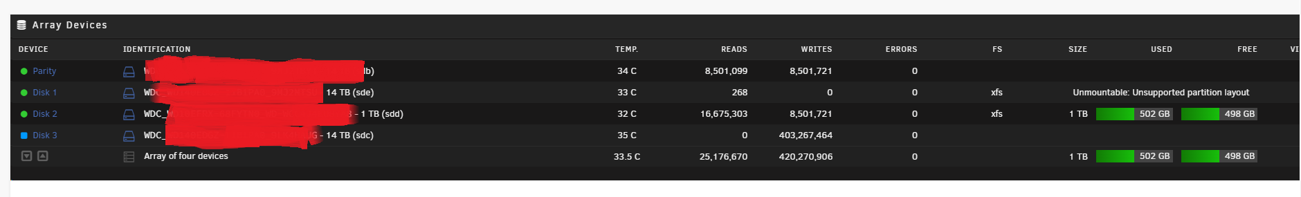

I need some advice. So i've spent 2 days trying to replace and rebuild parity. I also realized I did not format the HDD before replacing the parity drive.
After I upgraded and rebuilt party for 2 days. Everything looked good and docker was working as expected. I decided to upgrade 1 disk in my array and now its showing Unmountable.
Btw The HD are brand new and I need not format nor preclear them cos the process to preclear 1 hdd is more than 24h. What should I do from here? I still have the old Parity I removed from the array.

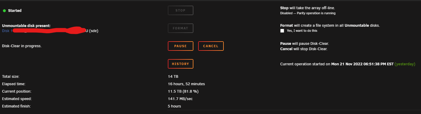

Well... It is already too late. The format started since yesterday. I assumed since they are new drives they need to be formatted.
I will wait for it to complete or can I cancel it at 80% completed? image.thumb.png.87e7d8945178efce3ecd04036b265dac.png
The problem is that it will format ALL drives that show as unmountable and that included disk1, not just the the new drives.   Since a format is treated like any other write operation this will also update parity accordingly.   This means as well as the new drives disk1 has also been formatted to have an empty file system.
That's a clear, not a format, just don't format once the clear is complete, before fixing the disk1 problem.
