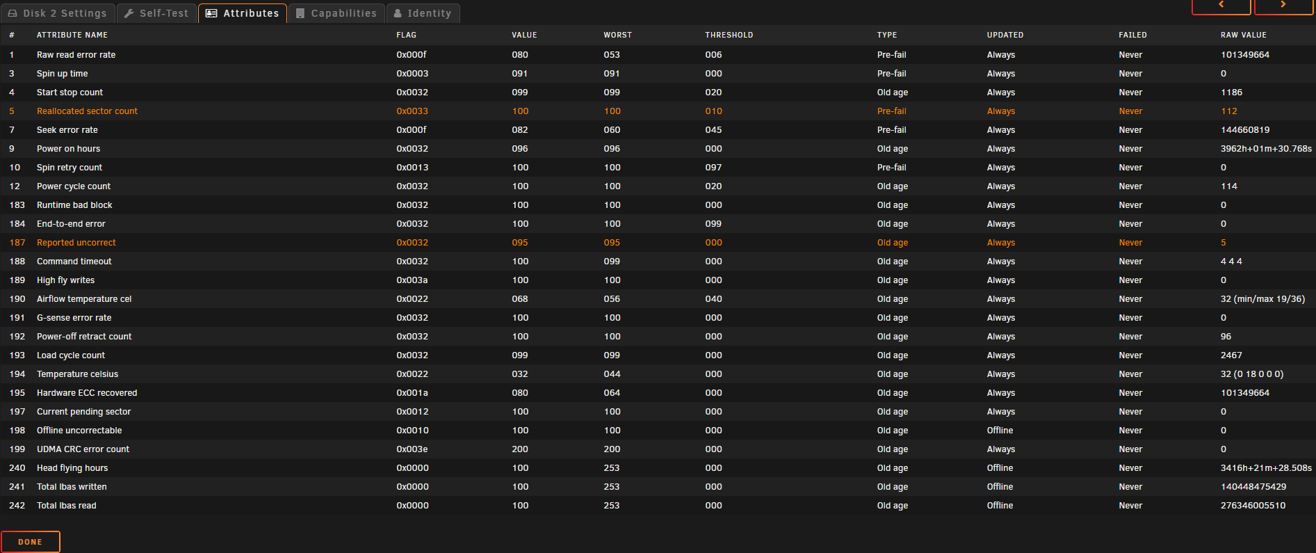

I have a data disk that is showing smart errors. The disk is about 12 months old, and annoyingly a 3-cycle preclear didn't show any errors, but that's life. The drive was ripped from a USB backup box so it has no warranty. Bye bye cash.

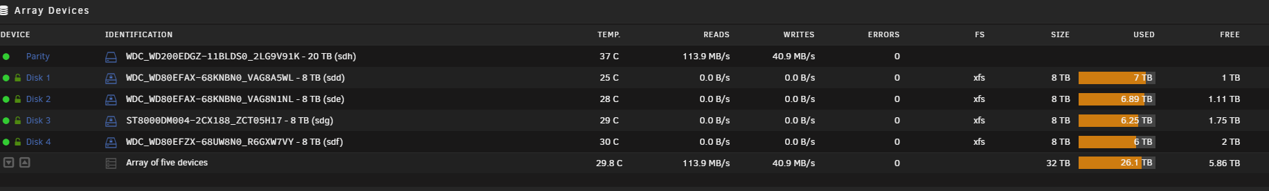

I followed the procedure 'exactly' to perform the parity swap. The old parity drive was 8T, the new parity drive is 20T. I have the following drives (image below) :

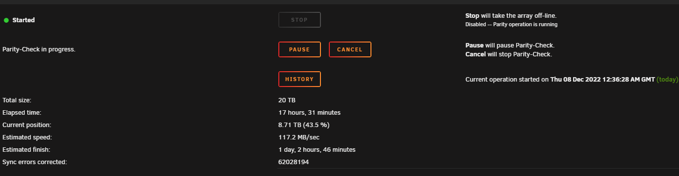

The last part of the instructions states that running a parity check is optional. So I chose to run it.

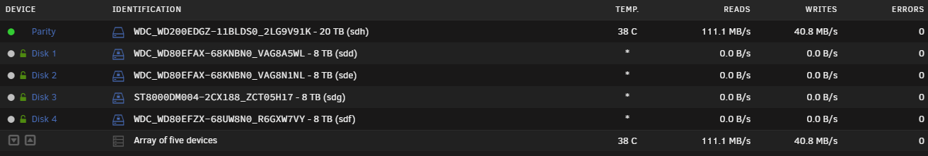

There are literally millions of sync errors being corrected by the parity check!  - What's going on ?!
The parity check position is past 8T (my largest data drive). Is this simply the parity drive being reset to a known state and nothing to worry about? The new parity drive was precleared before use. Should I be worried??
If the errors started after the 8TB mark it's an old bug, though it's a pesky one because it only happens sometimes, nothing to worry about, just let it correct.
OK, I'll stop worrying now. Seems to be reading and writing only the new parity drive.
Was this fixed in a newer Unraid version (I'm using 6.10.2) ?  I'm planning on replacing a data drive with a 20T once this parity check finishes.
Still not fixed because it's difficult to consistently reproduce.
