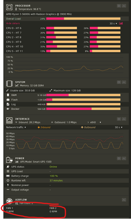

Hey there, running multiple Unraid Server,
my main Unraid Server has now the problem after a few days all Fans/Waterpumps except CPU Fans just stops, after a reboot everything works fine, already switchted the Mainboard from the other server was running fine now for 5 - 6 days but now happend again.
Already checked the manual for max load on the FAN Headers, im way under the max load.
Is there anything in UnRaid itself that can controll the fanspeed? have multiple plugins installed, but nothing thats obvious.
Edit: Have now removed "Dynamix Auto Fan Control" will check if it has anything todo with it, but was disabled anyway

I have noticed the same sort of issue on my end. Server has been running fine for years. However in the last month or so, after X amount of uptime days my CPU fan will stop spinning and the rest of the case fans will slow down to almost nothing. This causes the HDD temps to exceed the warning limit of 45 C. A reboot always restores functionality until another X days pass.
I have not made any hardware changes to the server for years, only upgrading Unraid versions as they release.
The timing does coincide with my Unraid upgrade from 6.10.3 to 6.11.2 which was done on November 6. (Issue also occurred on 6.11.5).
I will be trying to downgrade to Unraid 6.10.3 and monitor.
For reference, this is an Asus X470-F motherboard and Ryzen 3700x CPU.

My server just started doing this 2 days ago.  I had no idea why the server shutdown until just a few minutes ago.  I was in the room and working on a VM and all of a sudden it got quiet.  I looked over and the fans had stopped, but the server was still running.  I watched as the temps started climbing and just rebooted it from the GUI before it shut itself down.
Not sure if it's related, but this is only happening on my main server which was recently upgraded to 6.11.5 and has an Asus ROG STRIX X470-F Gaming board with AMD Ryzen 7 2700X, 32GB DDR4.  I've not changed any of the hardware in months.  I just rolled back to 6.10.3.
