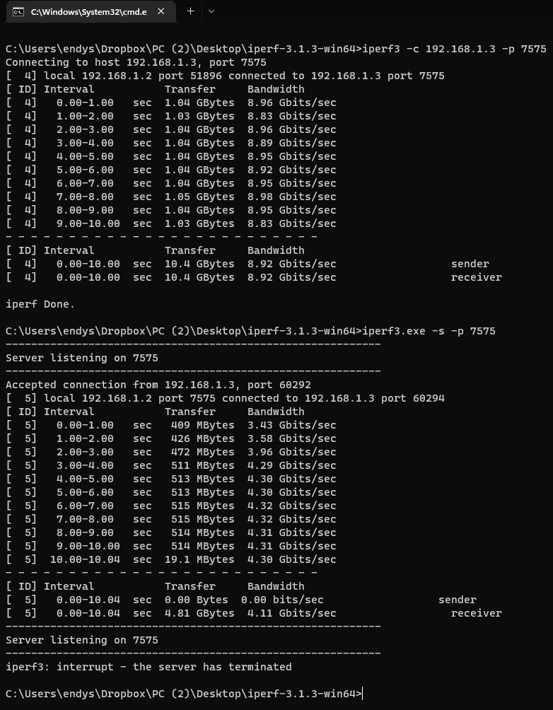

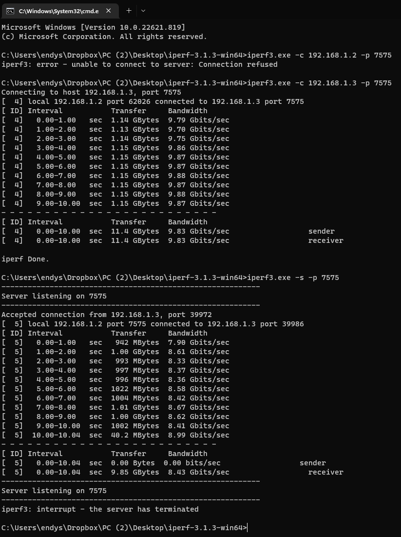

I tried to run iperf3 and performances are good enough for me, but when I try to copy any file from my PC to my Unraid server, it goes really slow...

As you can see here, it seems speed is fine from iperf3 tests (with antivirus -Kaspersky- enabled)...
Already tried disabling antivirus, but I cannot understand why it goes at around 50 mb/s...

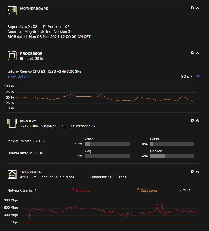

It seems initially speed is qiet good (~900 mb/s) but immediately it drops down to 35-50 mb/s)...

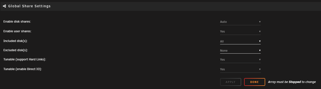

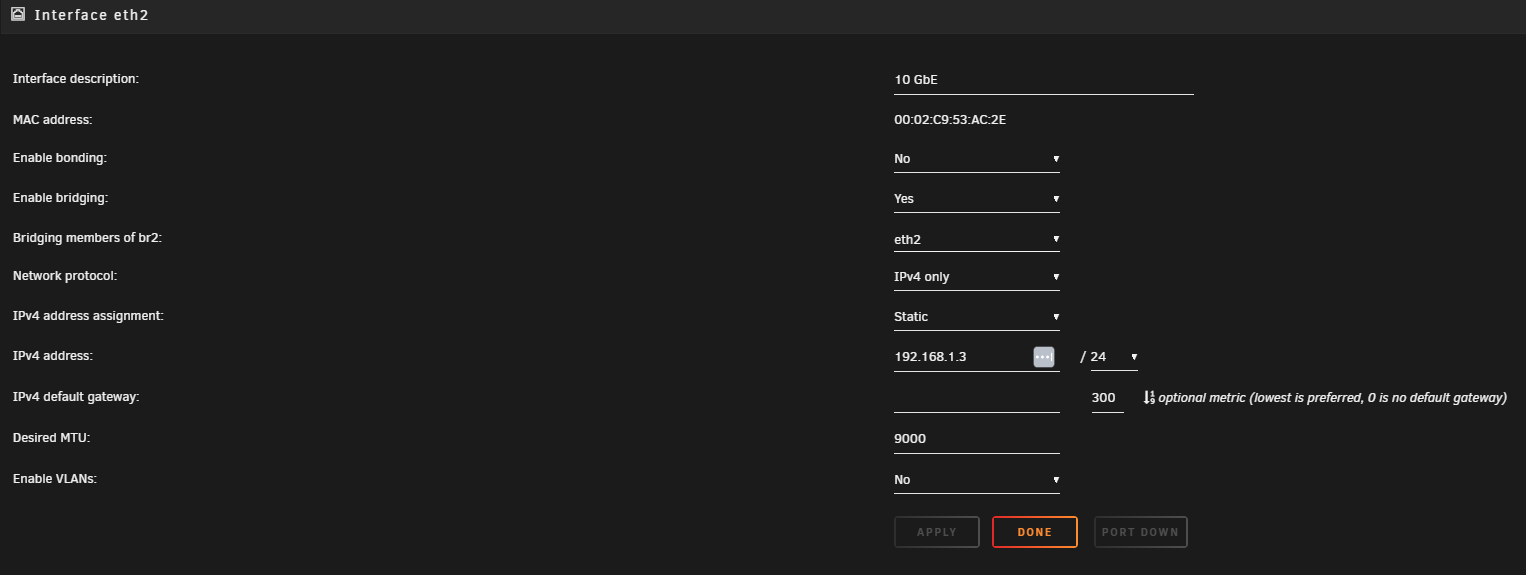

already tried also, but results didn't improve significantly (~60 mb/s):
- enable direct IO
- changing MTU/Jumbo size to 9000 both in Windows and Unraid, then rebooted both

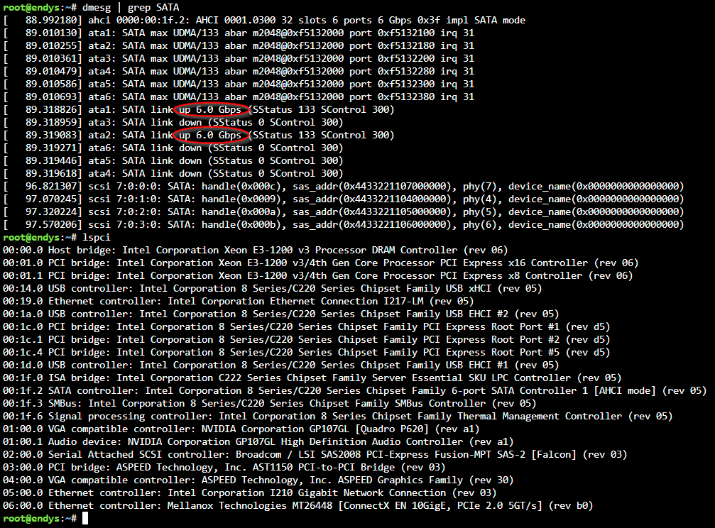

- checked SATA speed in the Unraid supermicro server

I also rerun iperf3 after applying the changes and from both sides it seems 10 gbit works, but copying files the problem still persists and still get ~60 mb/s of avg speed...

make sure that "flow control" is enabled on all cards (and switches if there are any). Windows has a bad habit to do an initial burst, and if not paced out properly it assumes that the line is crippled on the way and slows down.
Also watch the error counters for the cards, Even "direct connection" cables are not safe from faults and maybe you have got one that is not really properly supported by your cards?
This slow speed is usually a result of lost packets and therefor needed resends.
Iperf is a good tool, but you should retry it with much larger packet sizes to see if a lot of data can be transmitted too.

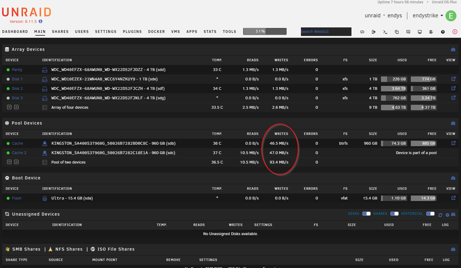

That might just be a device limitation, enable turbo write and transfer directly to the array, you should get >100MB/s
Thank you for your help @JorgeB :)
Unfortunately, after enabling turbo write, the transfer speed is still the same...
Btw, I'm writing to the SSD cache pool, so why turbo write should improve speed in this case?
Thank you!
Because you are are using Kingston SA400, which are some of the slowest SSDs available, not all SSDs can sustain 500MB/s writes, if fact most can't, unfortunately I missed that your array also won't be very fast since there's a 1TB disk, but pretty sure you are seeing low speeds due to device limits, that's why it starts reasonably fast, while it's being cached to RAM then it slows down when it's limited by the device write speed.

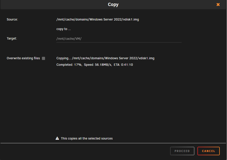

Well, it seems you're right: SSD speed is trashy...
I did a test and I tried to copy and paste in the same cache drive an img of a VM...
After the first 2-3 minutes, it goes from 300 mb/s to 50-60 mb/s...
It seems I've to ask refund to Amazon for the SSDs and get a different model...

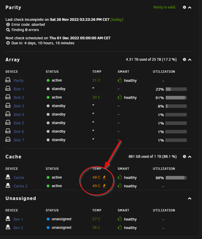

Now I've just another problem: SSD temperature... It seems they get hot while transferring files...
What's a good threshold value?
Thank you!
I usually set most of my SSDs to 60/65 warning/critical, though some models get other than that, critical temp is usually 70C for most SSDs, so just adjust as needed.

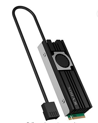

I know it looks a bit gimmicky, but I put a Icy Box IB-M2HSF-703 on my NVMe.  It is a heatsink with a 20mm fan.  Idle temps now are 38C.  Before installing, it was low 50C at idle, and would get hot enough to throttle down transfer speeds.

@ConnerVT thank you for that!
Unfortunately I don't have any M2 slot on the mobo, and my pci-e slots are full so I can't put any M2 drive in my build...
