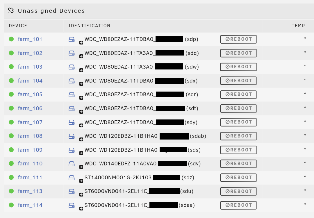

I'm running a NetApp DS4246 disk shelf, currently with 14 drives installed. This is connected to my server by means of a Broadcom / LSI SAS2308 PCI-E controller. The drives are all mounted as Unassigned Devices outside of the array.
This was all working fine until the last couple of months where, roughly once a week, I'd log in and find that the drives are missing, sort of... They all say "Reboot" next to them and I can't find any information as to what this means or why it is happening. They are inaccessible in this state. Once I reboot everything is fine again. See the screenshot attached.
My hypothesis is that the server is losing connection to the disk shelf for some reason but nothing seems to be obviously faulty and the server logs don't highlight anything that I can see.
Has anyone experienced anything like this?
Yes, that's what it looks like, HBA should not be the problrem, suspect cable/enclosure problem, I would start with a different cable since it's the easiest and cheapest to replace.
Ugh that's a pain. The only other thing I can think of is that i think it was working fine until I did a bit of maintennance and moved the rack (the timeline is a bit blurry in this point). As part of that process I'm pretty sure I plugged the disk shelf into my UPS whereas previously it was just plugged into the wall. I'm not having power outages or anything like that so it's probably still just the cable though I do wonder if the UPS isn't quite handling a power surge (or something like that). Probably still just the cable. Maybe I'll plug the disk shelf directly back into the mains for a week and see if that fixes it before ordering a new QSPF to miniSAS cable.
