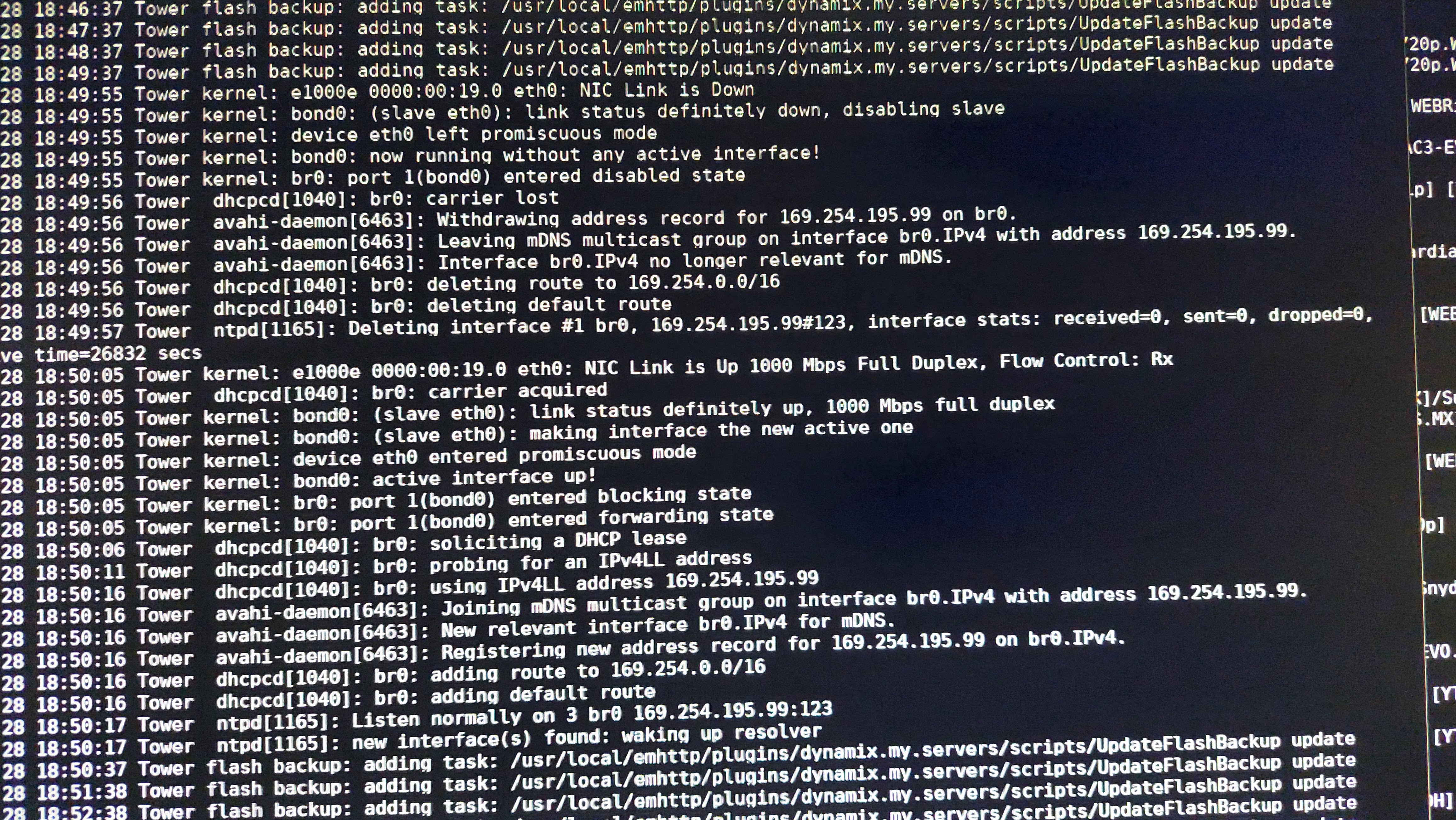

I have lost all networking access on my unraid server running on an (very) old Acer AC100, was running happily but I shutdown the server as I was away for a week and on restart cannot reach the server via the lan nor can I see anything out via the console.
Console runs normally and storage all reports OK.
Normally on fixed IP, changed to DHCP, disabled VM & Docker, multiple reboots and no luck.
Also had VT-d enabled in the BIOS as it had not caused any issues previously, but have it disabled now but no change.
Diagnostics attached, would appreciate any assistance.

Nov 28 09:12:38 Tower  dhcpcd[1015]: br0: probing for an IPv4LL address
Nov 28 09:12:43 Tower  dhcpcd[1015]: br0: using IPv4LL address 169.254.195.99
DHCP server is not providing an IP address, this suggest a router problem, or your are not connected to one.
Have checked current LAN DHCP and its functioning, tried second direct off my ADSL modem and that has the same behavior - no connectivity in/out.
Same with setting a fixed IP (original setting) on the server.
Can see lights/activity on the port, logs when I re-plugged the ADSL modem it does recognize a change in connection status - but no valid IP.
TJ.

100% failed onboard NIC, no errors no issues found in any diagnostics I could run just no traffic passed over the NIC.
I ended up migrating Unraid to another server and loading up a windows install on the failed server as I am more familiar with Windows and debugging it.  No NIC traffic under windows either, no faults just no traffic passed over NIC.
