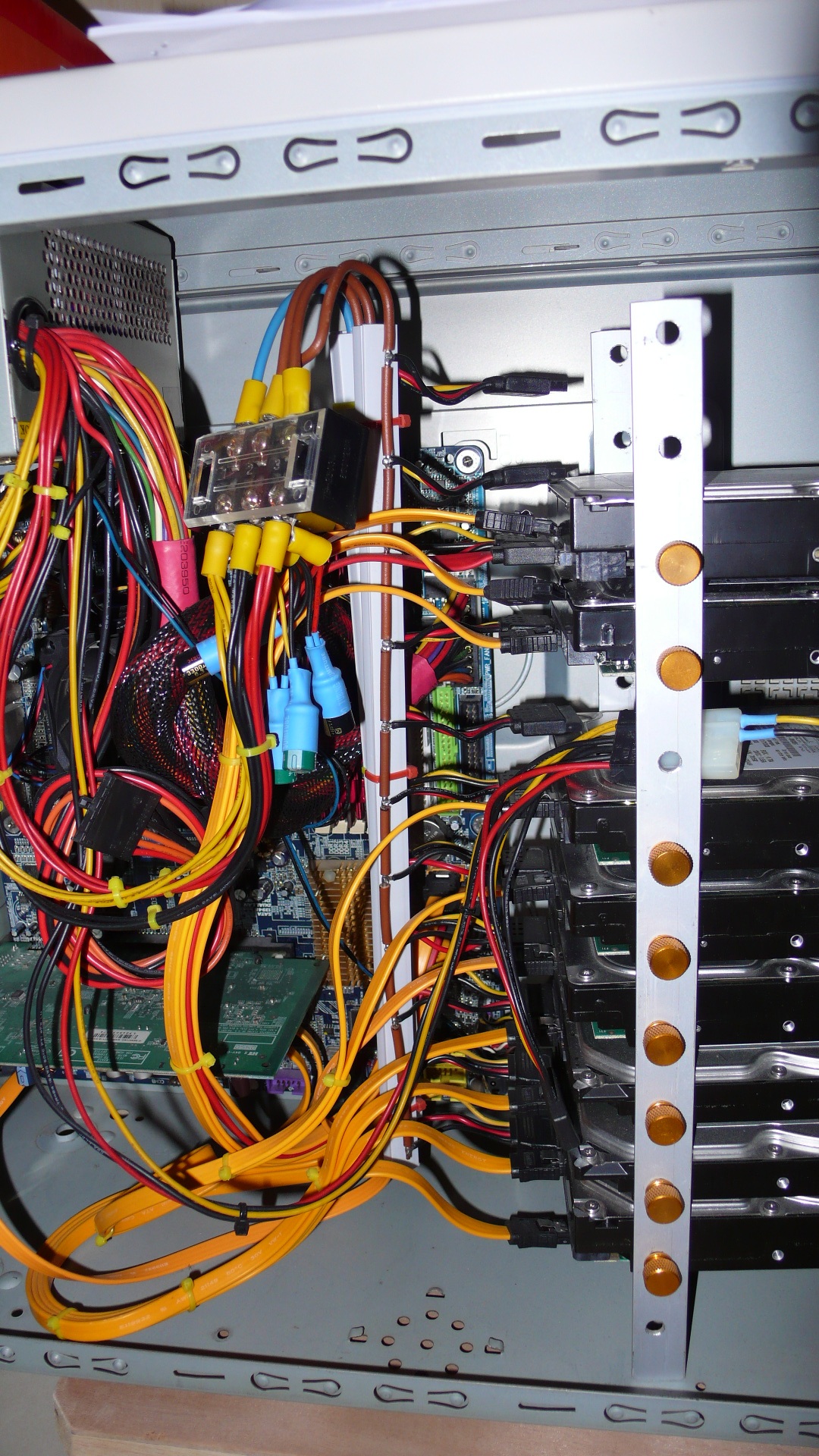

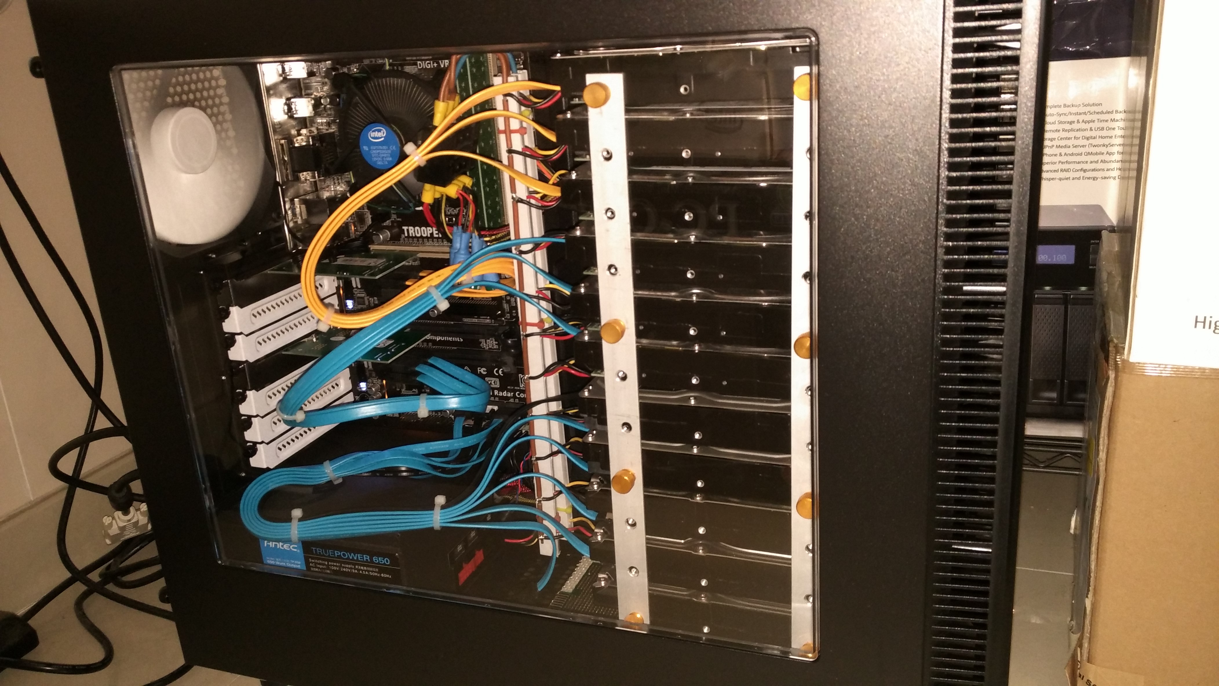

Below are some photo which take on many years ago,  actually they mount in same way, just later I change to use acrylic ( no photo ) for better outlook and little convenience if you need reassembly for disk change.
1st version, a smaller tower and disks need turn to some angle due to lack of space, then 2nd version was Define_S with larger space volume, still massive cabling. ( front side not fully screw, back side fully screw )

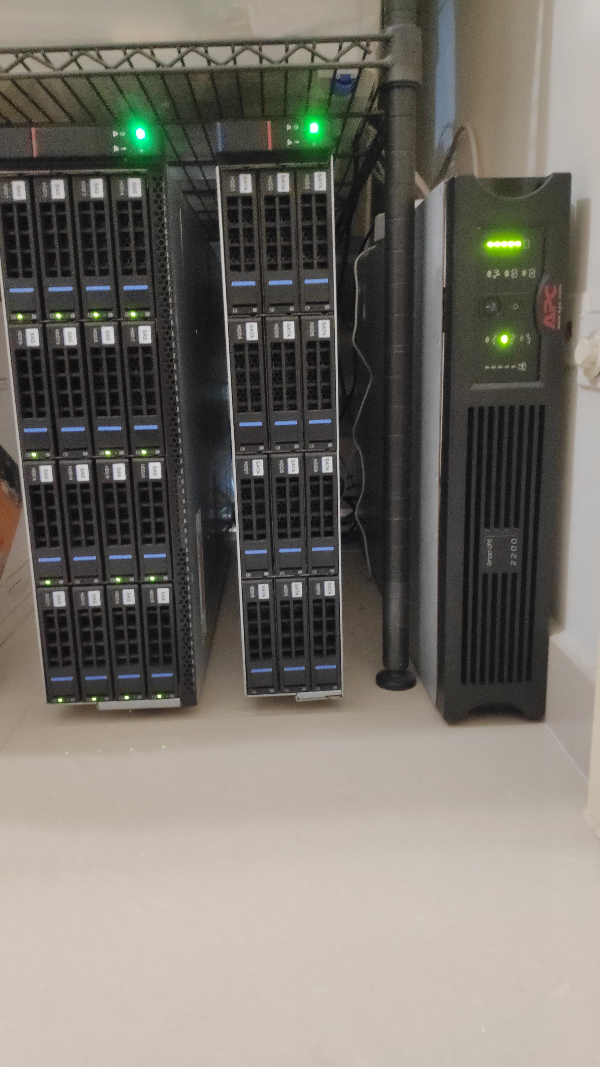

Separate in two case, 3U ( with mobo ) + 2U ( no mobo as external enclosure ), case name Gooxi which made from China. ( !!! Rack case often bad cooling !!! )
