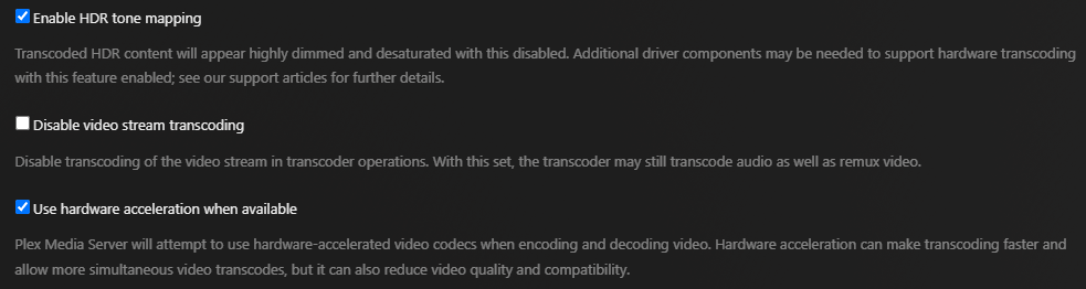

PLEX ENABLE HARDWARE ENCODING:
  1. Use PLEX's WebUI and login to the admin account. Then go to settings (the little wrench icon at the top right).
  2. Then on the left panel go to Settings > Transcoder. Enable "User hardware acceleration when available"

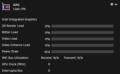

*CONFIGURE GPU STATISTICS
On UNRAID server go to Settings, and then click on GPU Statistics in the User Utilities area.
In the Vendor section change it to Intel

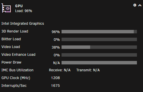

Worked like a charm.  Thank you very much.
For anyone interested, this worked with a 12th Gen Intel® Core™ i5-12600K and ASRock Z690 PG Riptide motherboard.
running unraid 6.11.5

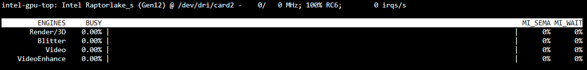

For some reason I can't seem to get this to work for me.
Just added an i5-13600k to my server
Installed Intel_gpu_top
iGPU shows up fine in GPU statistics
I've tried adding the extra parameter "--device=/dev/dri" in multiple different types of ways from every thread I could find with no luck.
Only thing that I can think of is ls in /dev/dri populates card0, card1, card2, renderD128, and renderD129
I still have my Nvidia Quadro P400 installed in my system as I'd like to keep using that for Tdarr and just have Plex on the Intel iGPU
Here's some of the examples I've tried:
--device=/dev/dri/renderD129:/dev/dri/renderD128 --device=/dev/dri/card1:/dev/dri/card0
--device=/dev/dri/renderD129:/dev/dri/renderD128 --device=/dev/dri/card2:/dev/dri/card0
--device=/dev/dri:/dev/dri
Nothing seems to actually get the Plex docker container to use the iGPU but switching my extra parameter back to "--runtime=nvidia" and hardware transcoding works fine again.
Not sure what I'm missing here but hopefully I'm just overlooking something.

For when you have multiple GPUs
https://forums.plex.tv/t/preferred-hw-transcoder-linux/593507/11
Wow that worked!
I hadn't even thought about the possibility of it being something with Plex itself.
Adding HardwareDevicePath="/dev/dri/renderD129" to the Preferences.xml file and restarting plex instantly resolved the issue.
I had to have read almost every thread on this subject to date and it did not occur to me to check the plex forms at all, thank you a ton @david279!

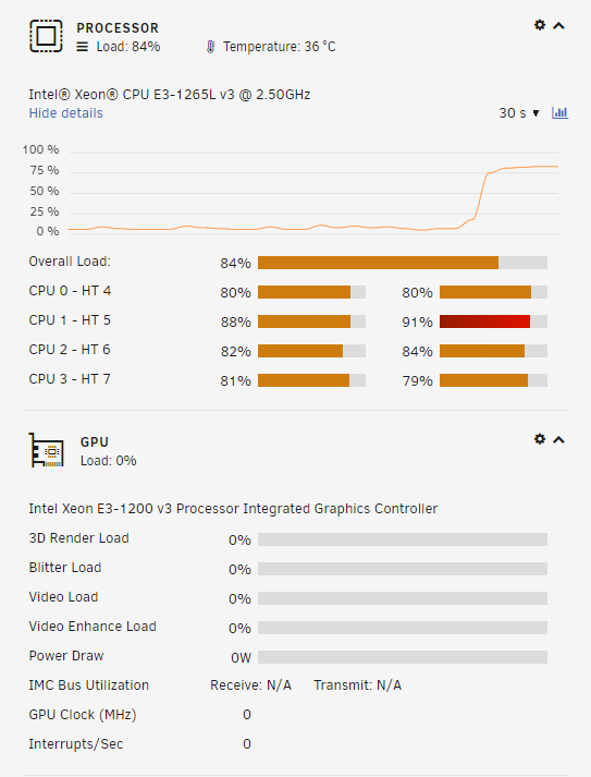

Hi Guys,
I'm new to UnRaid. Installed it last week and just tried to enable HW encoding for my test Plex build - following this guide.
I have all the config in place and HW encoding isn't working:
I'm running Xeon E3-1265L v3 without any additional GPU.
Any idea on what to check here to figure it out ?
Thanks

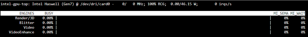

1 hour ago, pkoz79 said:
Xeon E3-1265L v3
That is a 4th generation Haswell CPU and, as you can see in the chart below, it has very limited Quick Sync Video encode/decode capabilities.  Basically, will get MPEG-2 as a format that matter for most movies.
Technically, Plex supports 2nd gen. or later CPUs with QSV but they recommend 5th generation or later:
From Plex documentation requirements for hardware accelerated transcoding:
A recent Intel CPU meeting these requirements:
  • 2nd-generation Intel Core (Sandy Bridge, 2011) or newer (we recommend 5th-gen Broadwell or newer for the best experience; Sandy Bridge, in particular, is known to sometimes have poor visual output on some systems)
Personally, and I am not saying this is an issue for you, I could never get things working properly with Intel GPU Top plugin so I uninstalled it and loaded the i915 drivers in the way recommended for the particular Unraid version I was running.
Thanks. Its just a test setup but I wanted to try out to see how things work.
AVC is quite popular for media content as well so Haswell would do the job there but I couldn't get it to work in the end ...
Put an old Quadro p400 in and it worked without any issues thought :)
