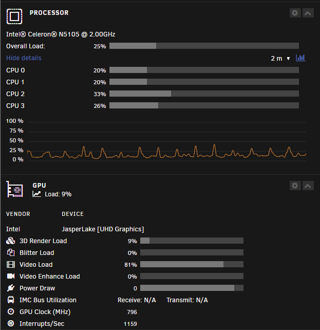

I've followed this guide and I believe I have h/w acceleration working in Jellyfin from GPU statistics on an N100 INTEL IGP but initially when I set it up I saw both "3D render load" and "video load" using GPU about 30% and 80% respectively. Now I seem to only get "Video load" using 100% GPU and 0% on "3d render load"
CPU with one stream of 1080p content to 720p 6mps is at 35% avg. is this expected?
any ideas why?

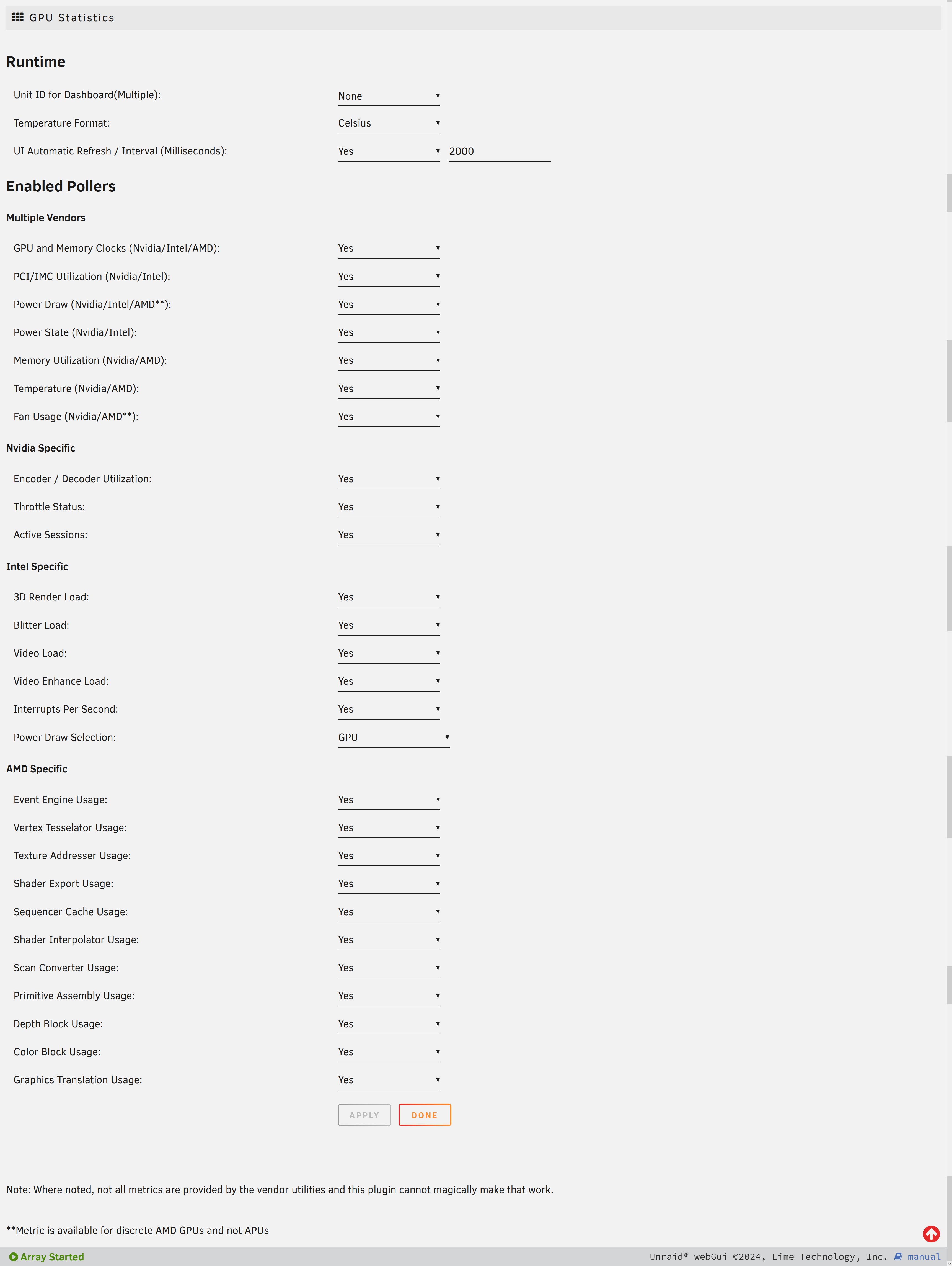

On 11/27/2022 at 4:32 PM, DemoRic said:
*CONFIGURE GPU STATISTICS
On UNRAID server go to Settings, and then click on GPU Statistics in the User Utilities area.
In the Vendor section change it to Intel
There is no option to select a vendor. I am using an Intel CPU: Intel Core i9-14900K. It should support Intel Quick Sync Video.

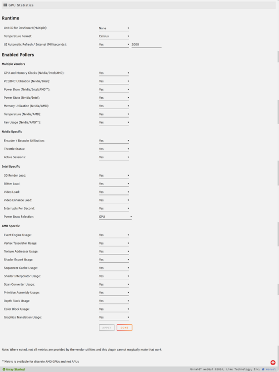

I had the same issue, but maybe you figured it out by now but thru clicking around and trial/error, I found the option under Unit ID where you can select your Intel UHD as it should just show up like this:
WORKS FLAWLESSLY!!!
Thanks but nothing happens when I click on the Unit ID dropdown...

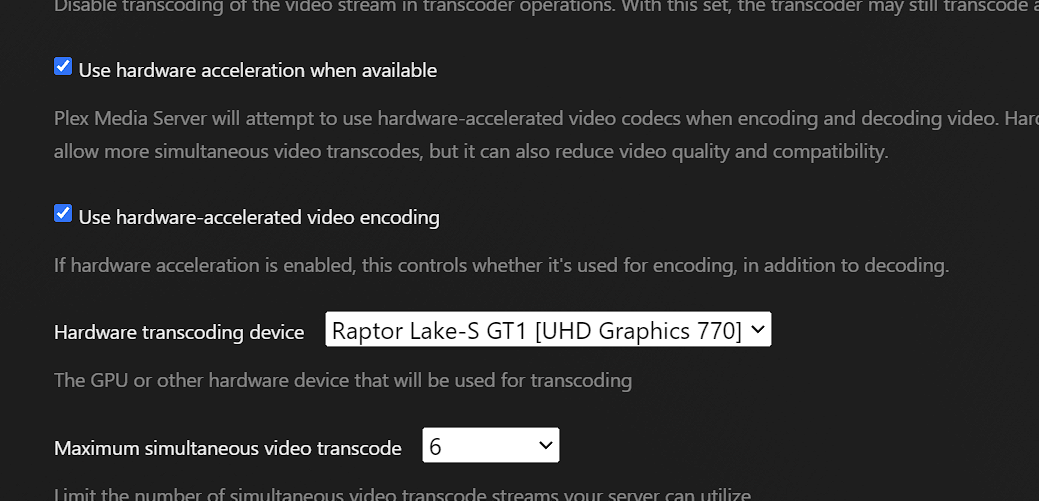

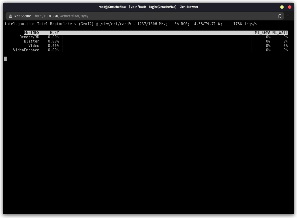

Just throwing this out there for anybody who might be pulling their hair out like I was for the past couple days.
Unraid 7.1.4
12th Gen Intel® Core i9-12900KS (QuickSync compatible with UHD 770 iGPU)
Lastest linuxsever Plex (1.42.1.10060-4e8b05daf)
Followed this guide and many others, but couldn't seem to get HW transcoding to work. After a lot of testing I found that it was only HDR content that was not utilizing HW Acceleration and was absolutely slamming my CPU. Transcoding of non-HDR video worked fine. Disabling HDR Tonemapping in Plex Transcoder settings fixed this, but I don't really consider this a real solution.
After doing some digging on the Plex forums, it looks like this is an issue more on the Plex side and rolling back to an older version could potentially work, but the Plex Team recommended the new HEVC transcoding option which has been in Beta for a while now is basically going to replace HDR Tonemapping anyways from what it sounds like. Enabling HEVC Video Encoding lets HDR content utilize HW Acceleration and eliminates the need to use HDR Tonemapping. The downsides of this are that HEVC Video Encoding will not support DoVi and some clients might not support HEVC. I think a lot of folks can probably deal with that though, especially since these transcodes might just be for relatives who could care less about quality anyways.
Hopefully this saves someone from having to go down the Github / Forum rabbithole that I had to go down!
