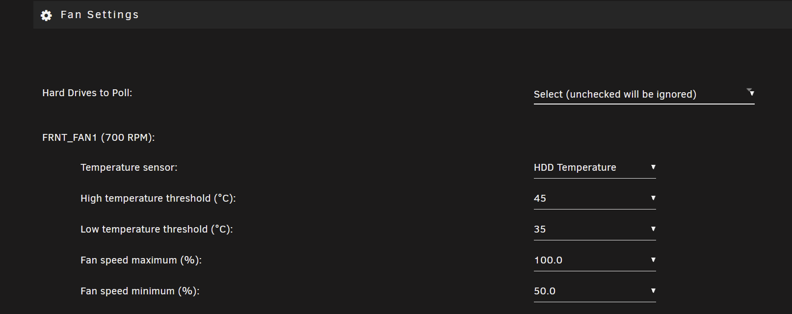

Check out the System AutoFan plugin.  Look for the installation URL in the linked post.  Your BIOS likely also has some type of fan control.
If your motherboard has IPMI (as mine does), a better option is the IPMI plugin
Here are my Front Fan1 settings from the IPMI plugin (50% while HDD temps remain under 35 C then increasing as temps rise up to 100% fan speed at 45 C):
CPU fans and other case fans have similar controls based on either CPU or HDD temps.
Edited by Hoopster
