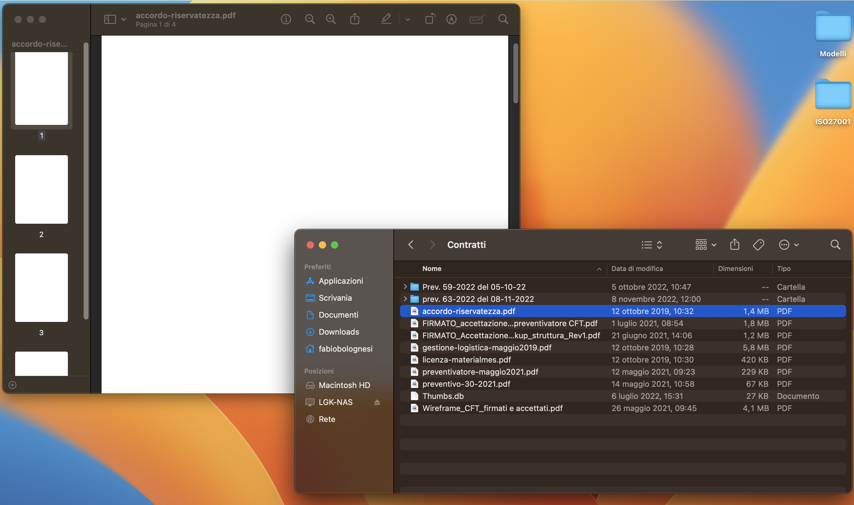

Hi everyone, I'm having problems opening PDF files on my NAS shares. I use MacOS and through the Finder, I access the shares of the NAS.
If I open a PDF file directly from the folder, I don't understand under what conditions, some of these open both in Mac preview and as files, incorrectly, with bugs in the display.
I leave you some screenshots below.

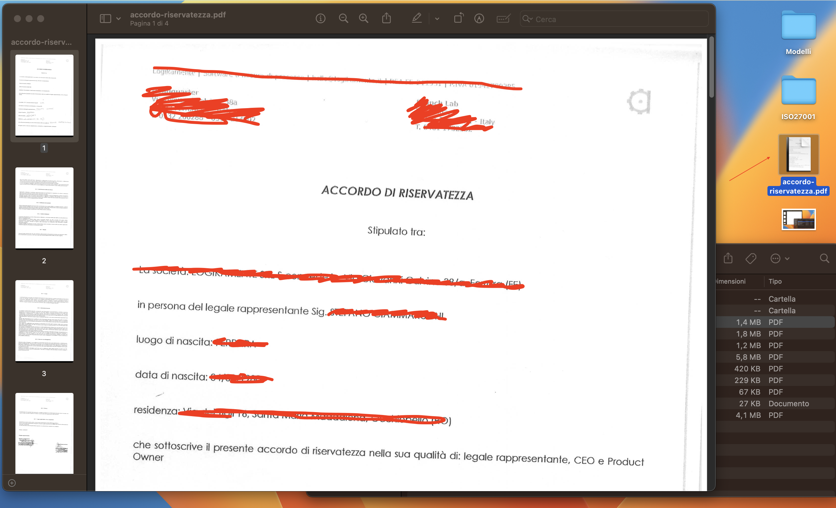

In reality these files are not corrupted as if I copy and paste the file on the Mac Desktop, it opens correctly. Even via Nextcloud from the web, the file can be seen correctly.

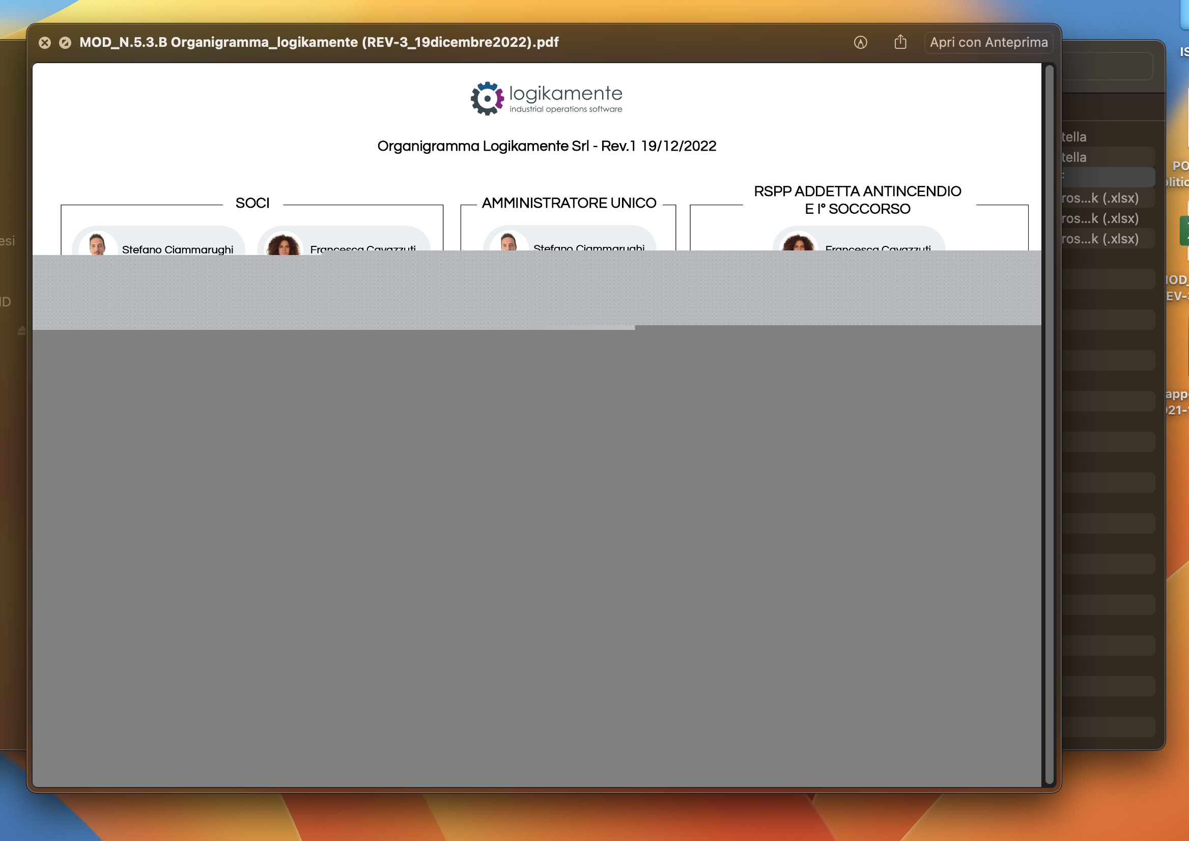

Hi @cz13 I still have the problem. I put another example. I've just opened a pdf file in preview directly from the share on my Mac.
On Windows PC, however, there are no problems.

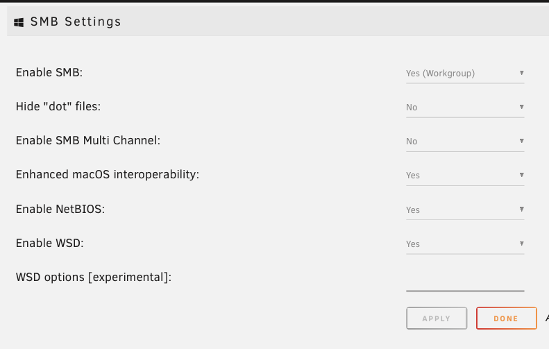

On Unraid:
On MacOS all default
Hi @cz13 thanks for the config. My are the same.
