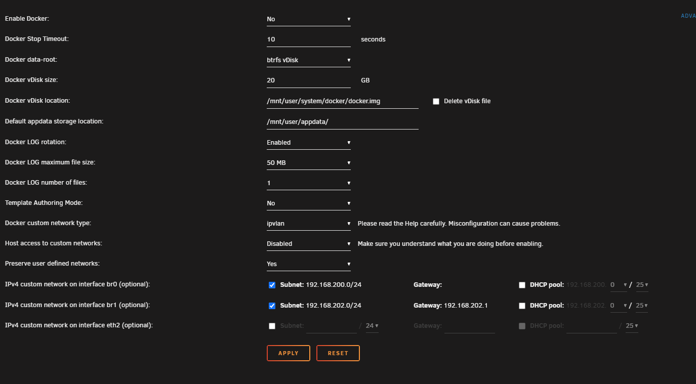

I was using a vlan for a custom Docker network but since I have multiple NICs in the server, I decided to add one to Docker and use that as the dedicated Docker network.

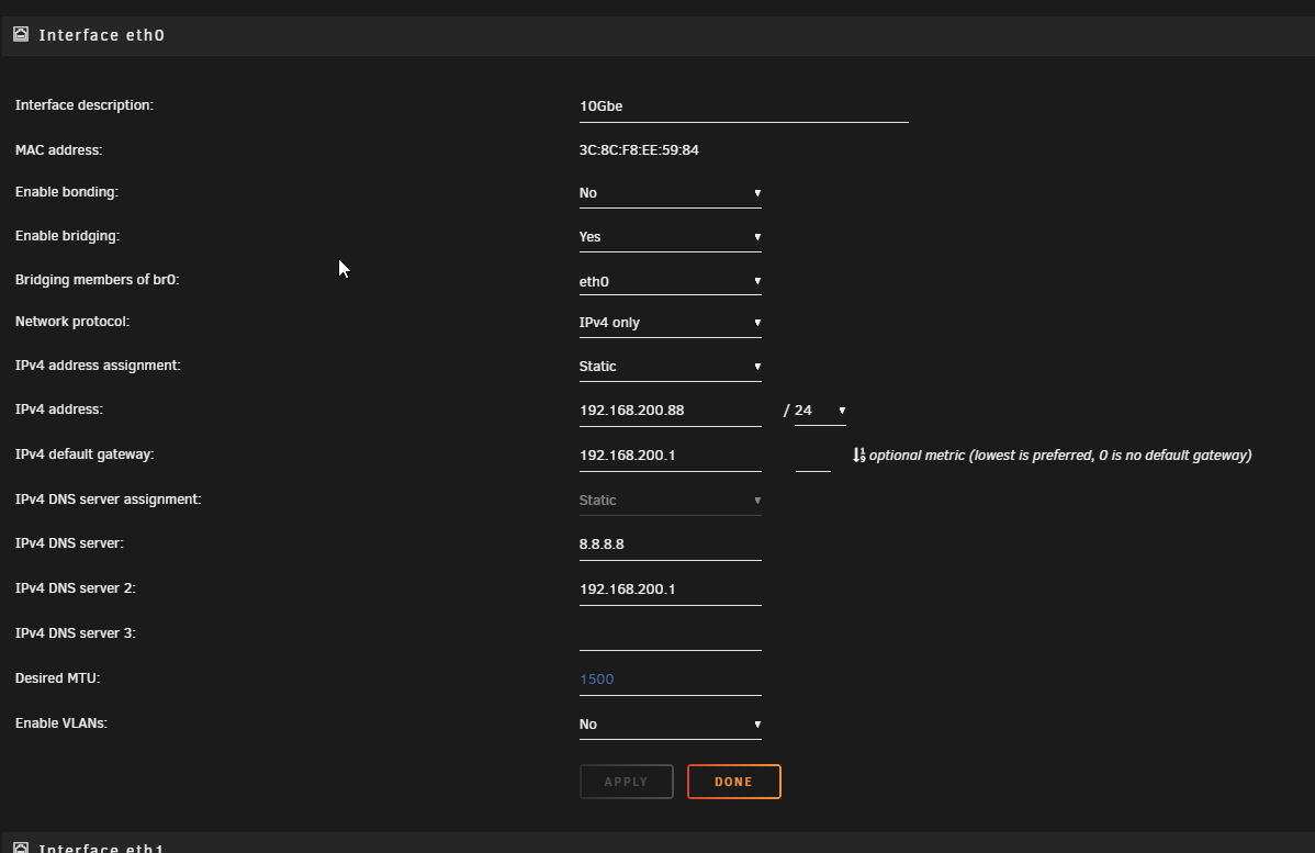

I managed to add the new NIC to the Docker config but in doing so, my br0 NIC (the primary Unraid NIC) now has no default gateway listed in the Docker networks list. It is configured on eth0 with the default gateway IP.
I think this issue is what is causing Docker to fail starting.

Input some number in eth0 default gateway metric, i.e. 1
Edited by Vr2Io
Odd that I had to add '1' to the eth0 network yet eth1 I had to leave blank.
Both networks are showing default gateways as config in the network settings.
