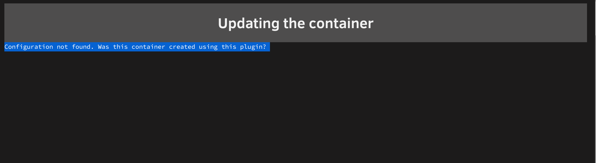

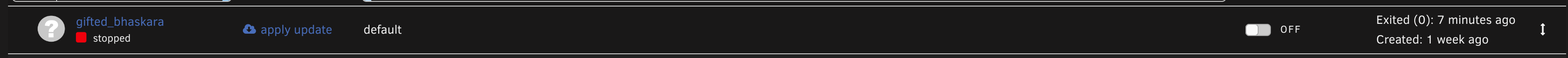

I recently started using CF Tunnels and i saw a Docker Container which does not act like a container popup called "gifted_bhaskara" this seems a weird name and i can find no trace of it. It shows up as as needing an update but it will not update also FIx Common Problems says it needs an update

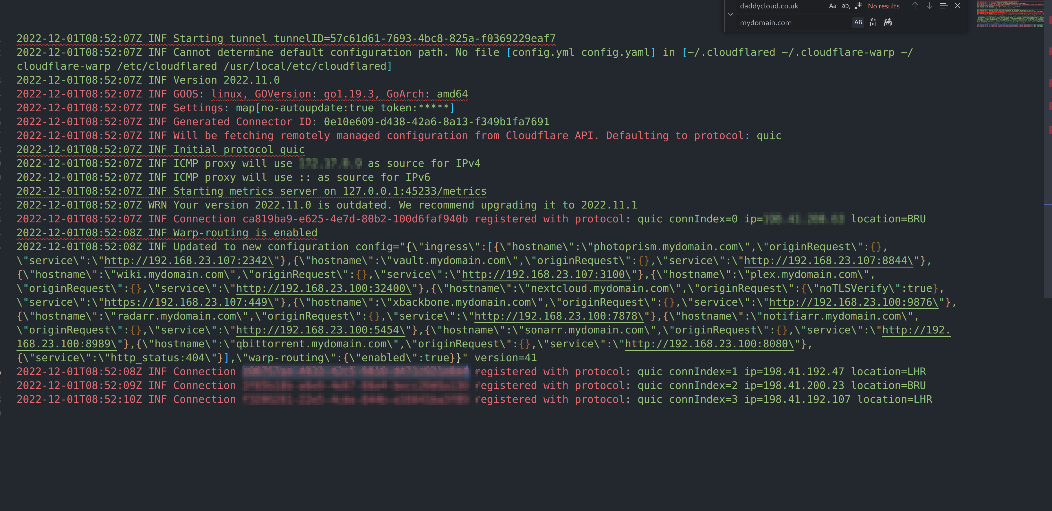

It has logs but I am concerned with the name and how it got added
Is there anything i can do to check it Google is not helpful
The logs look ok i think

The container name is likely a random one that docker has assigned. From the logs that looks like it has todo with cloudflare tunnels.
Yes i agree but no idea how it got on my system!
I did setup tunnels in CF then i saw it popup
It is not in App store, it will not update, and FIx Common Problems keeps reporting and i have no docs for it!
How can i have a container install itself with no docs or trace?
There is no underlying container template to edit how has it got into this area?
