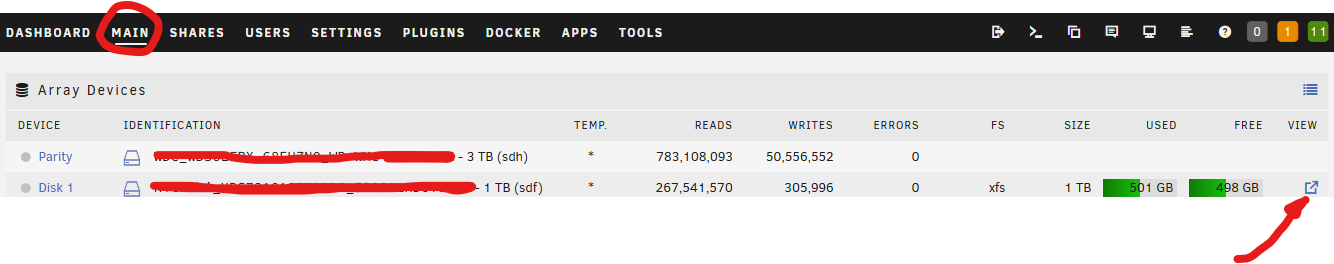

I know of no tools which will help you figure which files are duplicated.  You will have to do it by grunt work.  I would use the GUI built-in file manager in the disk mode that you can find here:
Open up two GUI windows and select the file manager for each disk.   Start by looking for common directories.  You will have to  investigate each common directory and all common sub-directories.  (I would use screen captures as much as possible and organize thing using marking pens so you are sure you have gone down each branch.)  IF you have to, analyze  each one.  As an example, if I have a share called "Backup" which contains folders for periodic backups of individual computers and I find two identical folders, I can probably delete one of the folders without much further investigation.  (This might not be true if my data disks are almost completely full...)  There will be cases where you have to compare things file by file looking for the duplicates.  You can also use your browser's print function to get printouts to work from.
