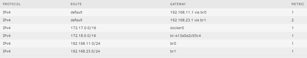

This is my initial routing table status (br-a13a0a2c93c4 is an already existing custom network created using "docker network create customnetworkname") :

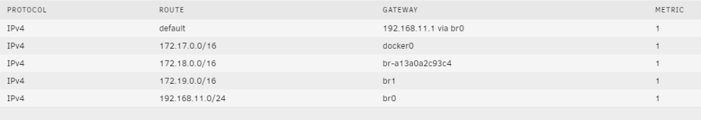

This is the routing table after using "docker network create -o "com.docker.network.bridge.name=br1" my-net":
And these are the docker networks:

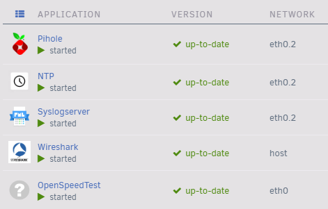

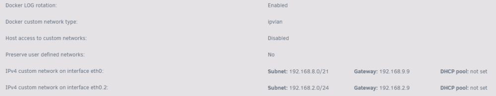

I can't reproduce the problem as you mention, I just simple assign docker to the network then it will route to correct gateway, no extra command or touch IP table need.

I haven't assign IP to eth0.2 ( VLAN ), just set IP in docker setting, but I don't think this is the reason for the routing problem you mention.
One difference I see is that you use ipvlan for the custom network type while I use macvlan, don't know if it makes a different or if I could switch without issues tho.
