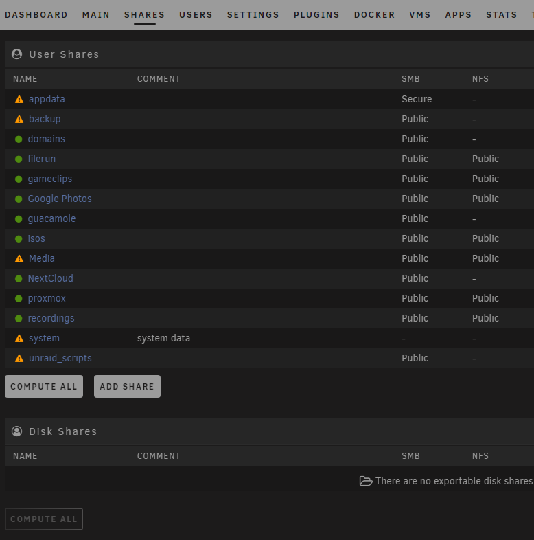

December 2, 20223 yr Hello, Came home to some a bunch of errors on 2/3 of my cache drives. I have tried running a scrub, but it seems to complete in 2 seconds and nothing happens. I've attached my logs. My docker image does not seem to be full and neither is the cache drive, so I'm not really sure what's going on. Any help would be appreciated. Edit: Fix common problems says: unable to write to cache and unable to write to docker image Edit2: On the docker tab there are a lot of these errors: Warning: file_put_contents(/var/lib/docker/unraid/images/grocy-icon.png): failed to open stream: Read-only file system in /usr/local/emhttp/plugins/dynamix.docker.manager/include/DockerClient.php on line 93 Dec 2 02:00:03 Unraid kernel: BTRFS error (device nvme0n1p1): bdev /dev/nvme0n1p1 errs: wr 0, rd 0, flush 0, corrupt 150, gen 0 Dec 2 02:00:03 Unraid kernel: BTRFS warning (device nvme0n1p1): csum failed root 5 ino 17790576 off 1602236416 csum 0x7b6aa7d1 expected csum 0x9007ed7c mirror 1 Dec 1 23:34:33 Unraid kernel: BTRFS error (device nvme2n1p1): block=1715306496 write time tree block corruption detected Dec 1 23:34:33 Unraid kernel: BTRFS: error (device nvme2n1p1) in btrfs_commit_transaction:2418: errno=-5 IO failure (Error while writing out transaction) Dec 1 23:34:33 Unraid kernel: BTRFS info (device nvme2n1p1: state E): forced readonly Dec 1 23:34:33 Unraid kernel: BTRFS warning (device nvme2n1p1: state E): Skipping commit of aborted transaction. Dec 1 23:34:33 Unraid kernel: BTRFS: error (device nvme2n1p1: state EA) in cleanup_transaction:1982: errno=-5 IO failure Dec 1 23:34:33 Unraid kernel: BTRFS: error (device nvme2n1p1: state EA) in btrfs_sync_log:3332: errno=-5 IO failure unraid-syslog-20221202-2058.zip Edited December 2, 20223 yr by colev14 additional details

December 19, 20223 yr Author 19 minutes ago, trurl said: Be sure to check your lost+found share There wasn't a lost and found share created. I restarted and there isn't one even after restart.
December 19, 20223 yr Community Expert 1 minute ago, colev14 said: There wasn't a lost and found share created 👍
