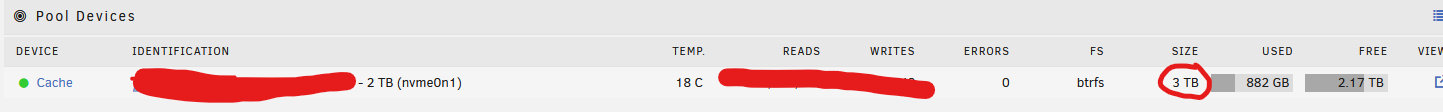

I messed up and rather than starting a new cache pool as I had meant to do with my 2 512 SSD's I incorrectly added them to a pool with my 2TB nvme cache drive.
I stopped the array and removed the drives and the slots. So now I'm down to a single cache driveimage.thumb.png.a26a38147c1e2e2f72872a3dd49e8c96.png
First it was incorrectly showing 1.5TB capacity so I ran the balance and it didn't change things.

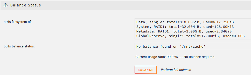

I actually ran that twice but am left with 3TB showing above.
Here is a view of the balance status and it appears it's still in Raid1
I was of the impression the convert command was supposed to change this.
Also I don't see the drop down next to the balance button shown in the post above.
Any other ideas on how to get this corrected back to a single drive with 2TB of capacity?

Having raid1 metadata indicates there's at least one more device that is still part of the pool, please post the diagnostics.
You didn't correctly remove the devices from the pool, it still has 3 members:
                  Data      Metadata System
Id Path           single    RAID1    RAID1     Unallocated
 1 /dev/nvme0n1p1 849.00GiB  3.00GiB  32.00MiB     1.03TiB
 2 /dev/sdb1              -  2.00GiB  32.00MiB   463.73GiB
 3 /dev/sdc1              -  1.00GiB         -   464.76GiB
