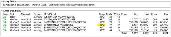

Upgraded to 5.0b8d. Everything went fine. Today, I stopped the array, after which I could not see the identification data for the disks any more (see image 1_2). Started the array (without knowing the identification of the disks), the array went on-line and I could access my shares. However, could not see the identification data any more (ref. image 1). Through the unMenu, I could see the necessary info, though (image2).
How could I get back this info displayed in the GUI?

easy... do not use the plugin to change the appearance until AFTER it is modified to catch up with the latest beta.
Thank you Joe. Unfortunately, I cannot work it out, however. I used to install the new GUI by using this statement (/boot/webGui/install.sh) in my go script. I removed it, rebooted, still have the new GUI and the mentioned problem. Even removed the webGui folder in my boot disk. Still boots to the new GUI and no identication data for my disks. When I try to check the identification data for each disk from the drop-down menu, I have only two options: the first one is an empty item, the second being: "no disk". The empty item is ticked, so I don't change any thing and start the array and it goes online. But I have got no chances to check whether the correct disks are assigned to correct slots.
What's next?
What's next?
Your web browser is caching the page.  hold SHIFT and hit the refresh button in your browser a couple of times.
prostuff1: I did clear the cache & history, cookies etc. (Safari and Firefox) - did not help. Is this new GUI implemented as a default in the new version? I just cannot get rid of it so I could try with the default Limetech web page.
no, it is not.
