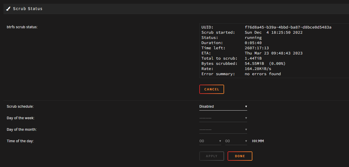

hmmmm, I had a look at the status and after 1:45h it was "aborted". But I didn't abort anything.
Now I restartet it again, checking the "correct errors" box, now it gives me the status visible in the screenshot attached. Is this expected behaviour? Is my drive broken?

Post new diags after the scrub finishes.
Hi Jorge,
the scrub was so slow, targeted finishing date was july next year. Even after a day it didn't even make 1%, still it already found 12 uncorrectable errors. I still attached the diagnostics
