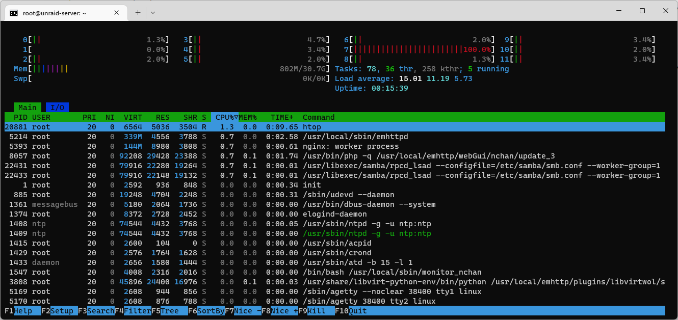

Hi @JorgeB, thanks for your reply. Here is the requested syslog. I hope it helps. I also attached a screenshot of htop: high cpu usage on one thread.
syslog.txt

Dec  4 17:43:21 unraid-server kernel: ? asm_sysvec_apic_timer_interrupt+0x16/0x20
Dec  4 17:43:21 unraid-server kernel: ? native_queued_spin_lock_slowpath+0x7f/0x1d0
Dec  4 17:43:21 unraid-server kernel: ? do_raw_spin_lock+0x14/0x1a
Dec  4 17:43:21 unraid-server kernel: ? __btrfs_remove_free_space_cache+0xe/0x2d
Dec  4 17:43:21 unraid-server kernel: ? load_free_space_cache+0x230/0x2dd
Dec  4 17:43:21 unraid-server kernel: ? kmem_cache_free+0xdb/0x176
Dec  4 17:43:21 unraid-server kernel: ? caching_thread+0x7e/0x43d
Dec  4 17:43:21 unraid-server kernel: ? move_linked_works+0x2f/0x6a
Dec  4 17:43:21 unraid-server kernel: ? pwq_adjust_max_active+0x88/0xa7
Dec  4 17:43:21 unraid-server kernel: ? btrfs_work_helper+0x114/0x2a5
Dec  4 17:43:21 unraid-server kernel: ? process_one_work+0x1ab/0x295
Dec  4 17:43:21 unraid-server kernel: ? worker_thread+0x18b/0x244
Dec  4 17:43:21 unraid-server kernel: ? rescuer_thread+0x281/0x281
Dec  4 17:43:21 unraid-server kernel: ? kthread+0xe7/0xef
Dec  4 17:43:21 unraid-server kernel: ? kthread_complete_and_exit+0x1b/0x1b
Dec  4 17:43:21 unraid-server kernel: ? ret_from_fork+0x22/0x30
Dec  4 17:43:21 unraid-server kernel: </TASK>

Test those packages one at a time and if you find the culprit report it in the Nerdtools support thread.
So NerdTools was a false flag. I must have overseen something. After all, I can say that the issue is either caused by the Unassigned Devices Plugin or the 2.5in USB drive I have connected to the machine. The Server works perfectly fine either if I have the Plugin not installed or the drive is disconnected. The drive is on automount so it is mounted directly after boot. Curiously, the error occurs just after I startup the array, long time after the USB Drive is mounted. I don't really know what to do. I rely on the drive for borgbackups...
I just tested with this and had no problems
mount -t btrfs /dev/sda1 /mnt/usb/test
Did you install UD and not mount the drive as a test?  UD queries the drive after it is mounted to get stats and that might be the issue.  Manually mounting the drive is fine, but UD wouldn't be running to query the disk.
So thats interesting. I did install UD and disabled automount for USB drives. Manually mounting the drive after array startup (GUI button in main tab) did result in the same error as before: 1 CPU thread at 100% and no way to stop unraid except hard crash.
Set up the syslog server to save the syslog, reboot the server with the drive set to not auto mount, then go to UD and mount the drive.  Post the syslog.  I think your drive is hanging UD with something and the syslog should show what is hanging.
An alternative is to try another drive.
I accidently uploaded the wrong syslog. Here's the right one. I also ran a short SMART test against the drive since the syslog says: ``has skinny extents``
WD_Elements_10B8_SMART_report.txt syslog
Recently there have been a couple of issues reported with space cache v1, I would expect if that was the problem here it also wouldn't mount manually, but it won't hurt to try, run:
btrfs check --clear-space-cache v1 /dev/sdX1
Replace X with correct letter, then try mounting with UD again.
So this seems to have solved the issue. The array is running now for over an hour without issue. Thank you both @JorgeB and @dlandon. Can I buy you a coffee somewhere?
