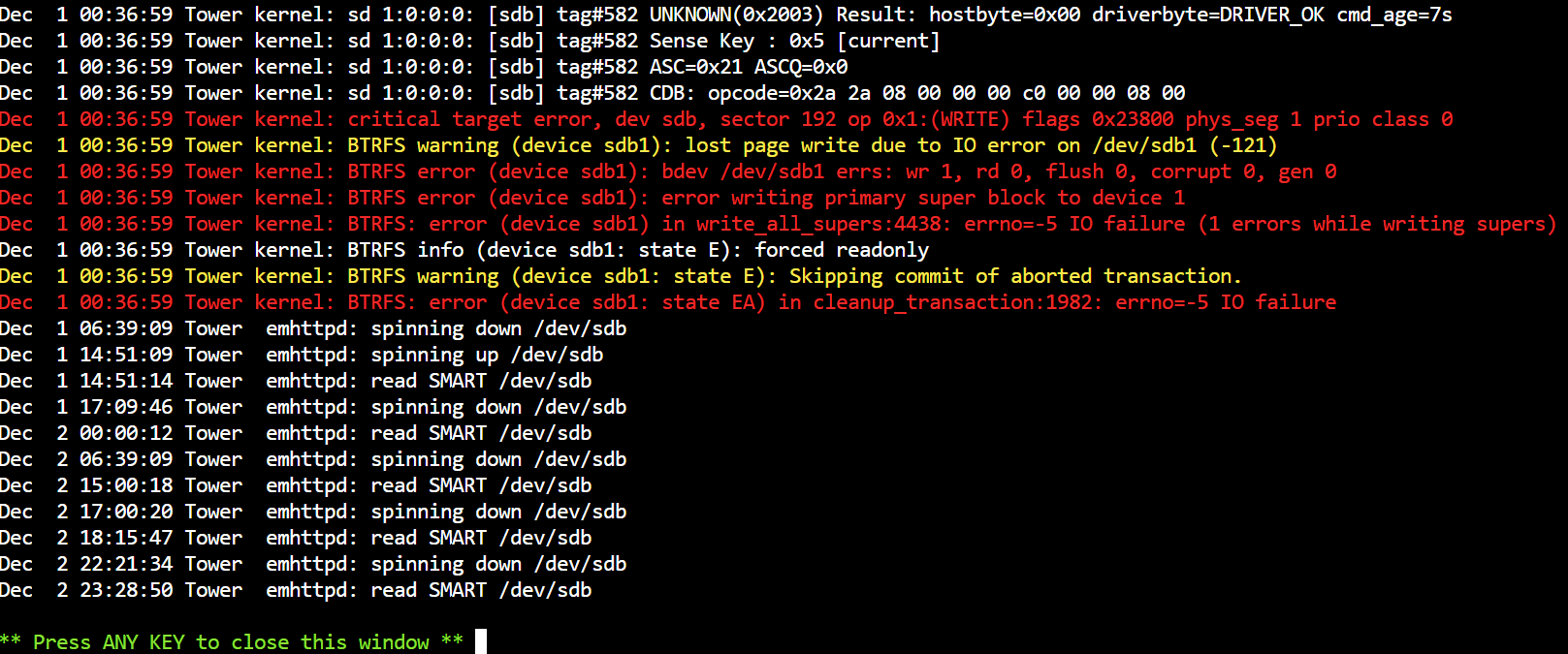

hello, I'm having an issue with my cache drive. and I have no idea why it doing this. first thing I notice was that the cache drive was spin down( it rear for it to spin down or I just never see it spin down). and SMB was not working until I spin the drive back up again manually. then I notice the Fix Common Problems plugin was showing an error saying unable to write to cache and I check cache drive log and there some error messages(check pic). any idea what this mean?

As for the cache drive, SMART looks OK but it's an old drive, swap cables/slot with a different disk, if issues follow the disk best to replace it.

yea i got it used when i first got the server. i'm not going to be home for about 2 weeks. is there something i could try to do? like stop the array and start it back up? or reboot the server?

You can try rebooting, but the issue will likely reoccur.

Well I think rebooting it fix the cache drive because it has not showed an error since rebooting. But I will replace the drive once I get a chance.
