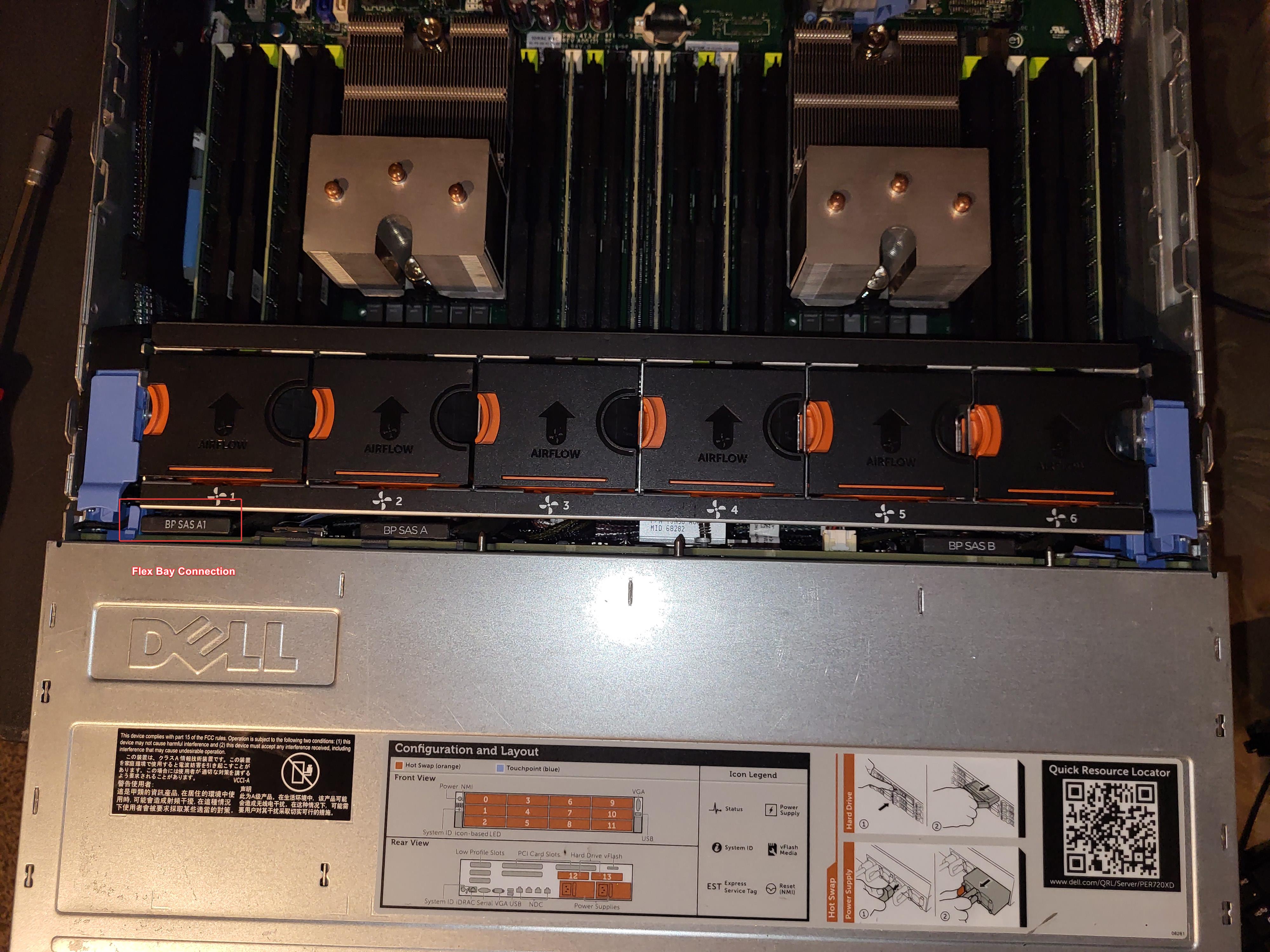

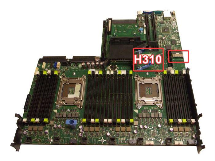

Thanks for the response. The Flex Bay is an expansion board that slots into the riser in the back and connects to the board via several cables and the SAS connection runs to the front of the server and connects to the same backplane that the 3.5" hard drives connect to. The main backplane runs along the right side of the case/board (looking from the front) and connects to the board via what looks like a double-wide SAS connection. The attached picture shows where the H310 Mini sits on the board and the double-wide connection where the backplane is plugged in. I can take actual pictures of my setup when I'm at home if that would be helpful.

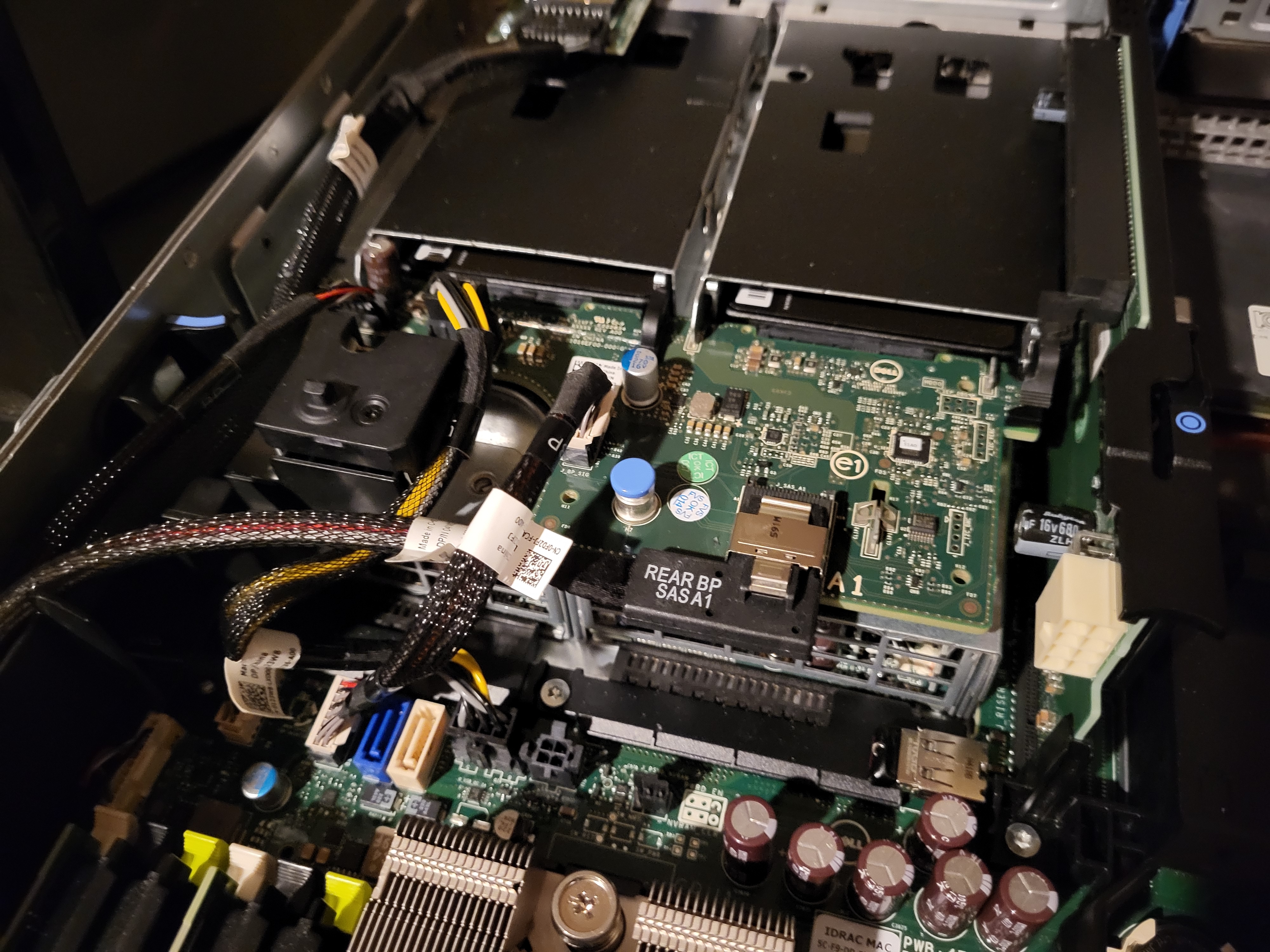

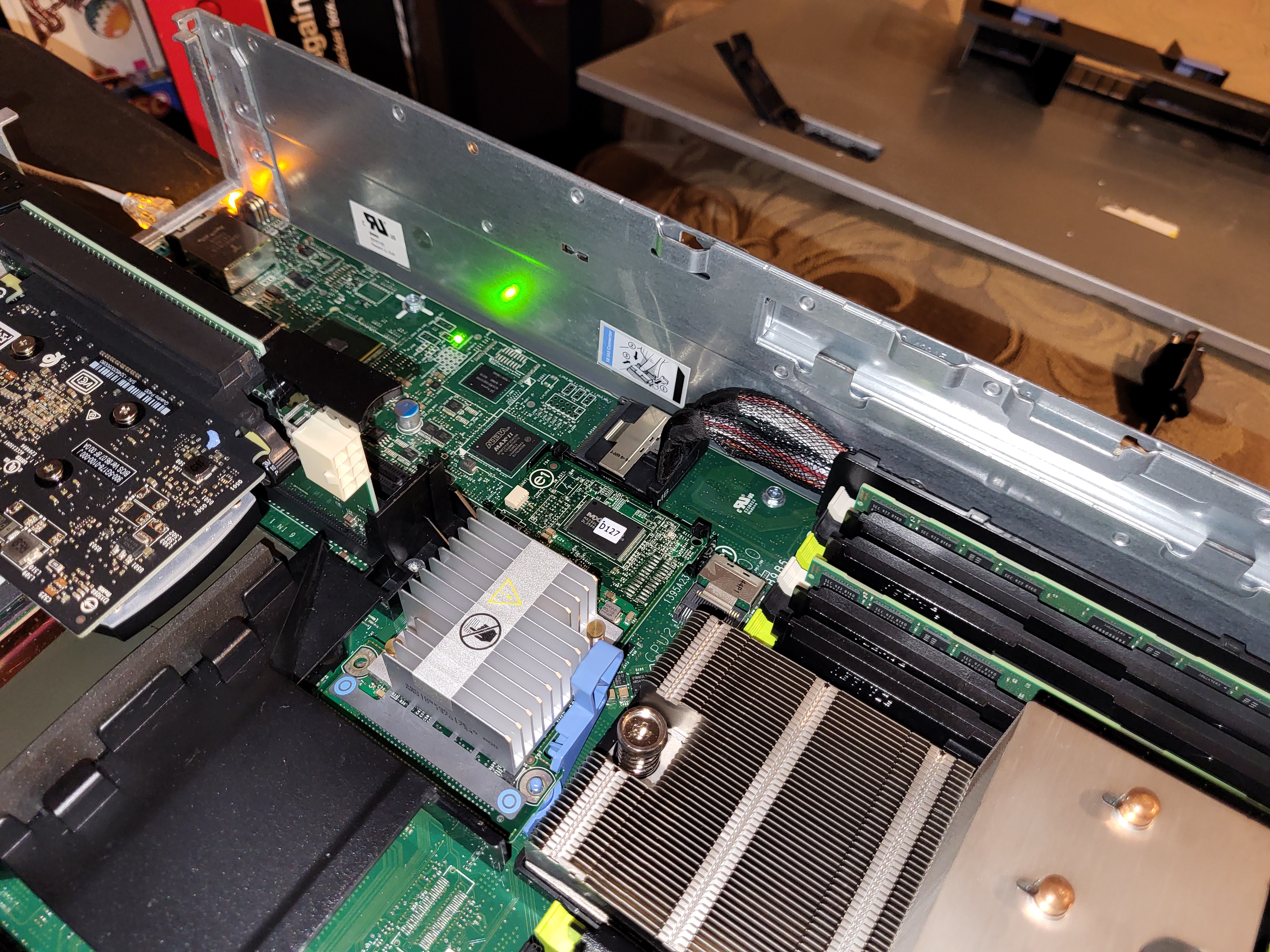

I took a few pictures, one of the backplane that is in the front of the chassis just behind the 3.5" drives and called out which connection is for the Flex Bay, a picture of the Flex Bay daughter board, and the H310 Mini and the double-SAS connector that would be carrying the other 2 connections on the backplane.

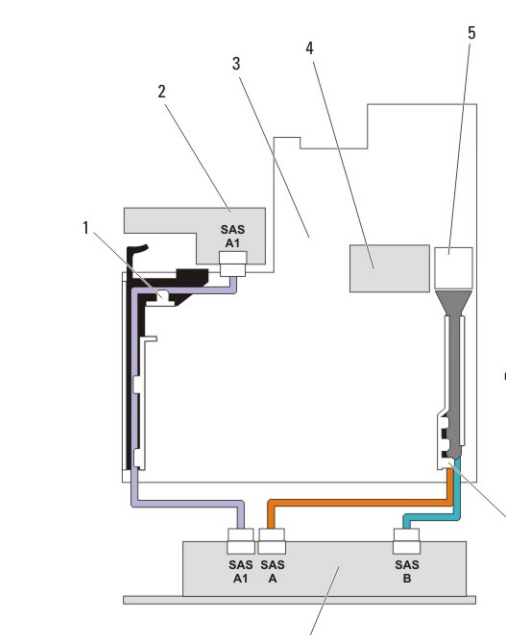

OK, if I'm understanding correctly this is how the backplanes are connected:
SAS A1 goes to the Flexibay, and currently the flexibay drives are detected and connected to the LSI, since the other backplane is in the middle it should also work, assuming the disks are powering up, do you hear the disks spinning up when the power is turned on?
Yes, this drawing is correct as to how things are connected currently. I do not hear the disks spinning up nor see any activity lights blinking on the front of the server/drive trays (not sure if the trays will blink or not yet). I've tried to locate a SAS drive at work and have been unable to do so, and the ~36 drives I have at home are all SATA unfortunately.
