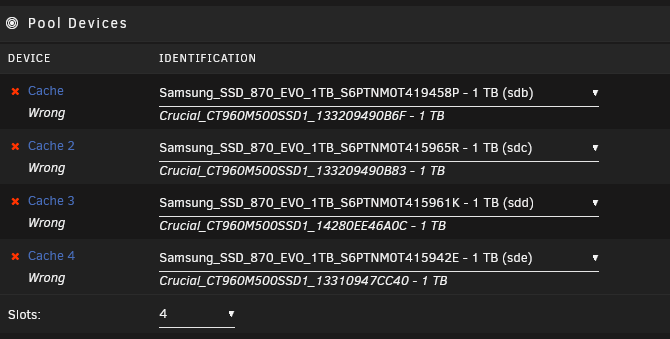

Over the weekend, I experienced a massive power event and when I came in this morning, my unRAID server booted but would not start the array and reported a stale configuration.  The array drives seem to be OK but the cache pool drives are all listed as "wrong" and it is referencing cache drives that were replaced several months ago.
Any suggestions?

Unassign all cache devices, start array, stop array, re-assign all cache devices, start array.

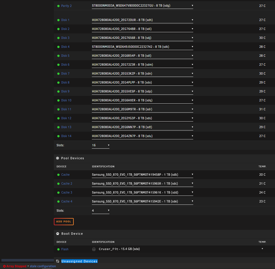

That seems to have solved the problem with the cache pool drives, but drive but when I start the array, it immediately stops the array and shows "Array Stopped: stale configuration."  Do I need to do the same for the array drives?
If you using Firefox reboot first then use a different browser.
