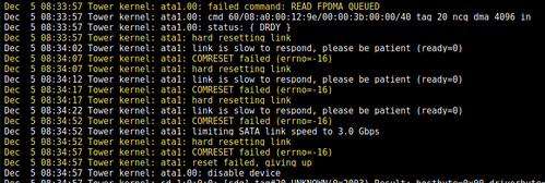

Since smartctl is used to read disks' SMART info, I suspected my drives, and found the attached disk log on one of my two cache SSDs. The two SSDs are identical brand new drives I recently bought. Previously was not using cache pools.

Is this indication of a bad SSD?

Device dropped offline, this is usually a power/connection problem.

For my own knowledge and future ability to diagnose problems on my own, what were the message(s) that lead to that conclusion? Is it intermittently going offline-online like a loose cable might cause?

When a device drops offline like that it's most often a power/connection problem.
Disable device means it dropped, there also won't be a SMART report.
Conclusion: It was a bad SSD afterall.
After lots of hardware swapping: several new sets of sata cables, swapping the positions of the working HHD with the non-working SSD, even moving all drives to a whole new computer (motherboard/ram/cpu) with new install of unRAID. I was still getting the same error.
I had two Team Group SSDs in cache pool, so I tried reformatting both and using each as a single cache drive. In both configurations, I would still get the same error. Sometimes not right away, but 5-10min after bootup. So it's either both SSDs are bad, or they're incompatible with unRAID somehow.
Anyhow, I didn't want to waste any more time on the cheap SSD. I bought an SSD of another better known brand, and everything is working fine now. Never buying Team Group SSDs again...
