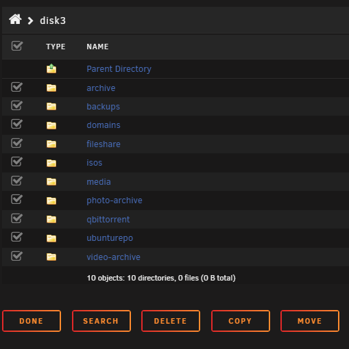

My Unraid server has been functioning flawlessly for the past 2 years. However just today I had a look at the Main tab and noticed that 5 of the 6 drives are showing as empty! Previously, my array was half full.

If the Dynamix file manager plugin is installed, one checkbox and Delete...
But someone who hacked into your box wouldn't bother using the UI, a single terminal command to rm -rf /mnt/diskX/* and the job is done. Or they could format it, or do anything really...

Ok so I've recovered data from the first drive.
I've placed the original drive back into the Unraid array and booted. So far so good.
Now I'm trying to copy the data from the spare drive (which is connected to my windows PC on the same LAN) to this specific original drive. It's important that I do this because if I allow Unraid to decide which disk to put the data, it will overwrite recoverable data on the other (now empty) drives which I haven't recovered data from.
I've enabled disk share, and I can see the disk in samba shares in Windows.
Two problems:
1. Since the original drive is now empty, how do I know what the original file structure was? Disk 6 (which was untouched and still has files intact) has folders that correspond to the shares that I set up in Unraid, however since I set up the array to distribute data in the 'high water' setting, it doesn't contain all the files, naturally. Should I just recreate this folder structure in the original drive which is now empty and start copying my files to the relevant folders?
2. When I copy anything to Unraid, it first gets copied to my cache drive. Since the amount of data I'm copying far exceeds the capacity of my cache drive, what will happen once the capacity is reached? Will it just automatically start writing to the disk itself? Or will it stop and tell me it's out of space until I invoke the Mover script? Where can I go to check this setting?
Don't you have the original structure in the recovered drive?

Yeah I do. I tried copying the recovered files back to the affected drive, and the share now successfully reports those files mixed in with the other files on the unaffected drive in the array. Now I just need to do this whole process 4 more times :-\
